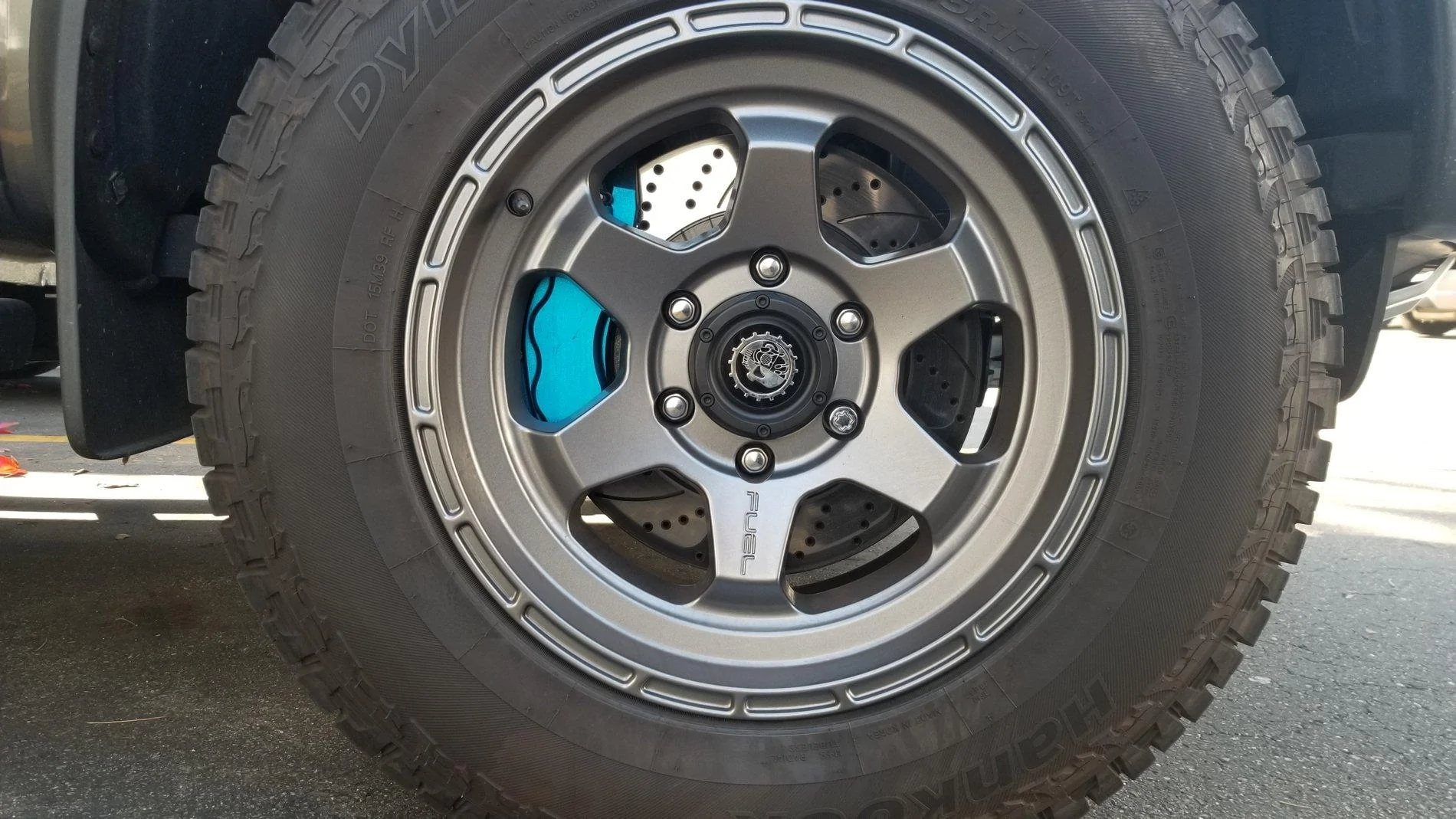

A month in and these are great. Mushy pedal is a distant memory.

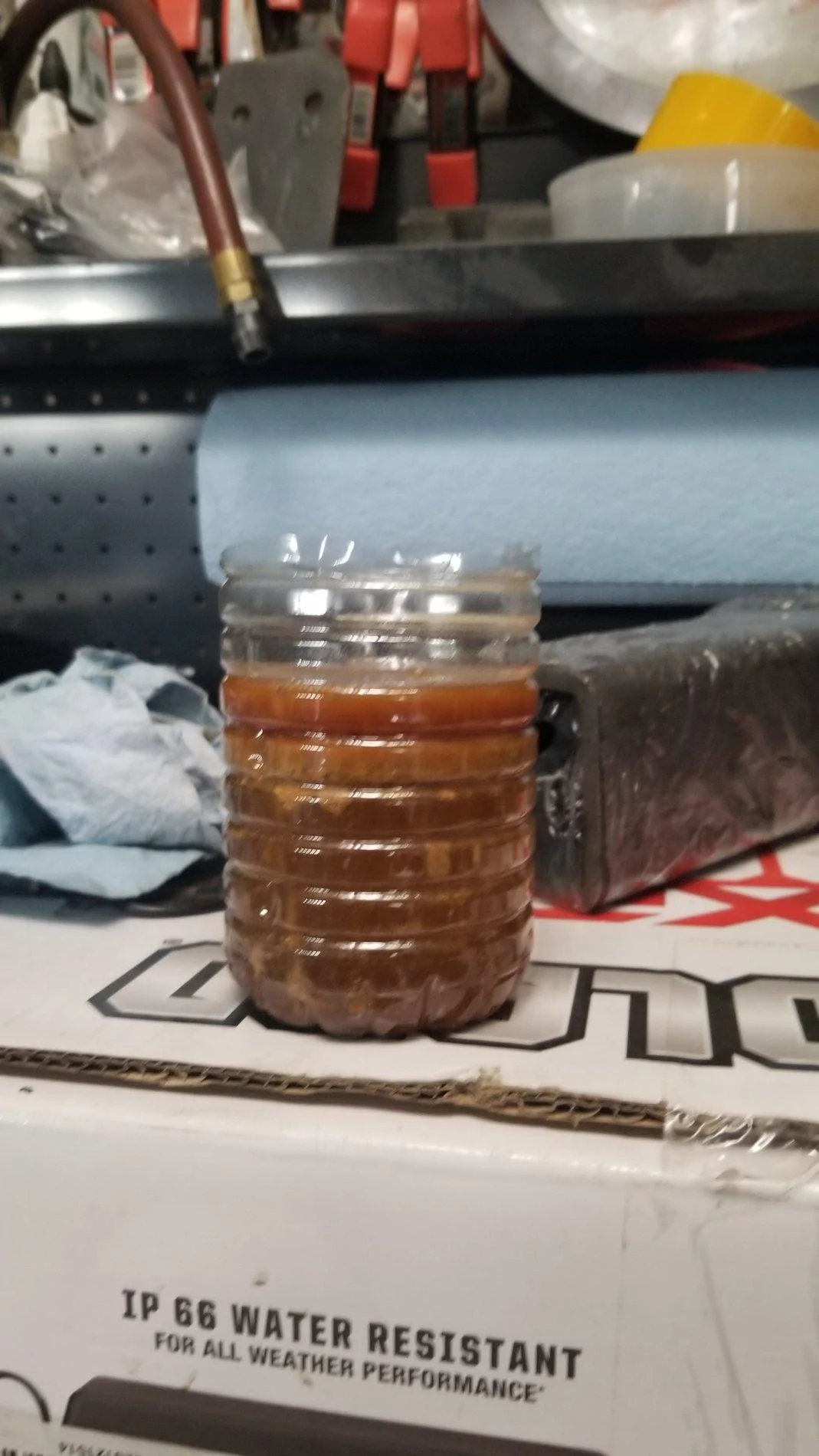

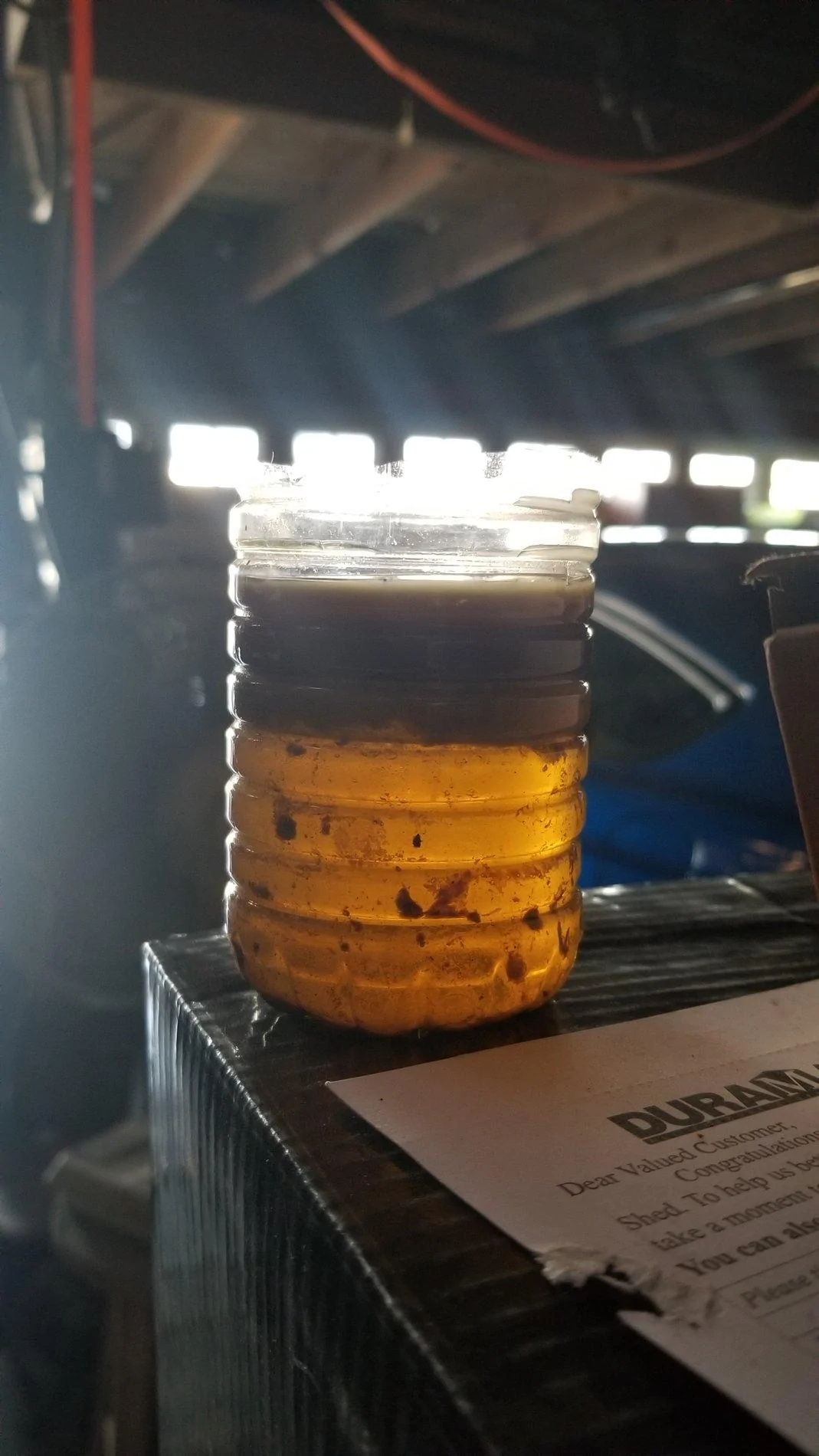

In 6400 miles this is what the oil catch can caught. #notsnakeoil

Finally got the different mounting bracket. Still had to shim but was able to shim this time to center the caliper. The worldwide Ranger is a different brake setup. The bracket that came for the worldwide version couldn't be shimmed in the correct direction. Stops better obviously and the pedal feel has firmed up a bit and doesn't feel as vague or spongy. Would like it to feel firmer so I'll see what rear braided lines will do.

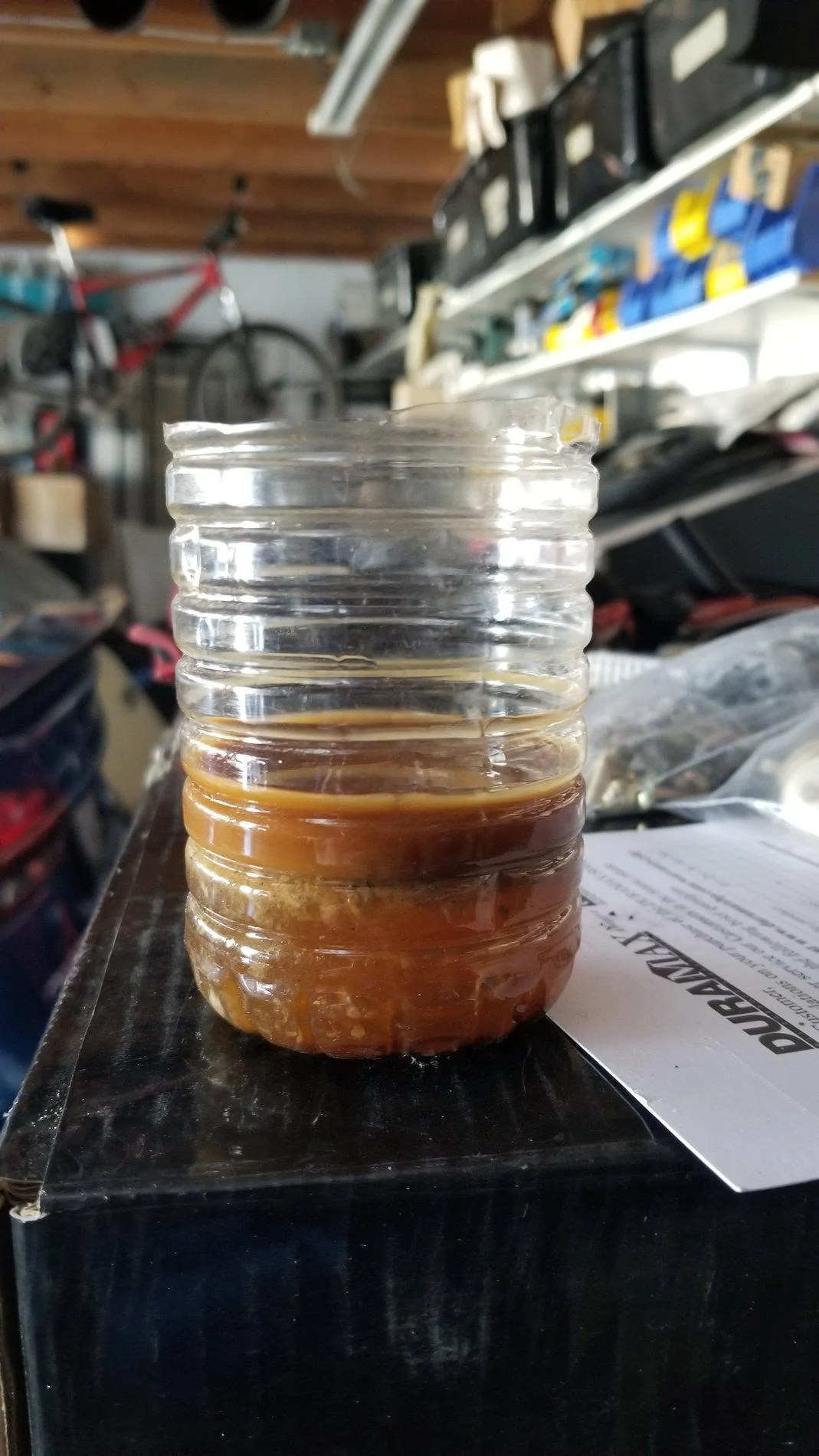

What I've noticed is with the temps now being in the 40-60's and the start/stop I've picked up a ton of condensation in the catch can. It's probably not getting hot enough with start/stop and the cold the engine to get rid of thr condensation quick enough. Definitely didn't get as much when it was warmer. And the amount of oil seems the same but it's harder to tell with the water mixing. Cumulative now at 6671 miles.

Letting it sit overnight or longer you can see everything separate. There's a ton of water (condensation) that comes from the breather side and about the same amount of oil from the PVC side. The condensation has increased big time in colder weather (not freezing) with a good amount of auto start/stop.

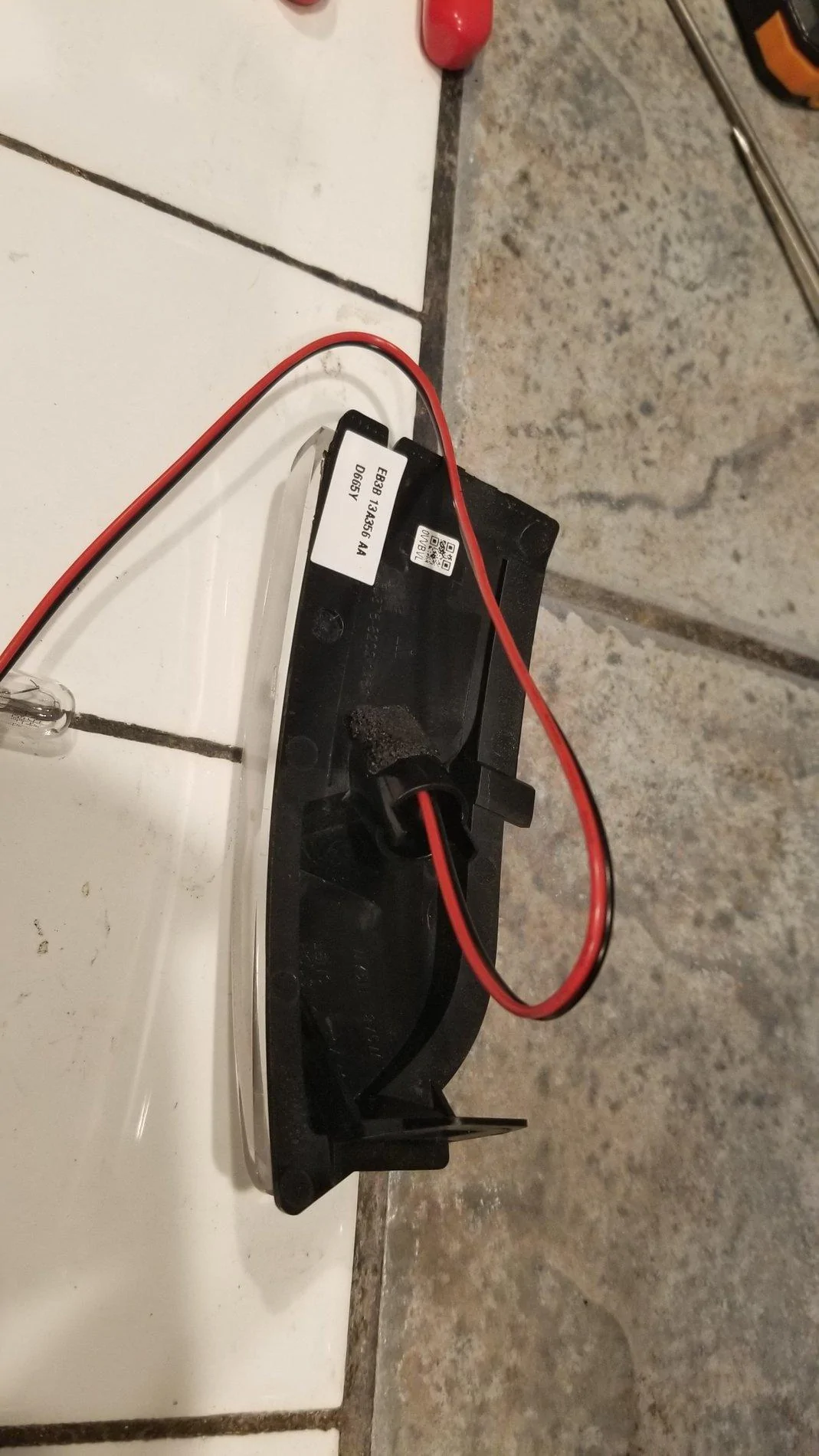

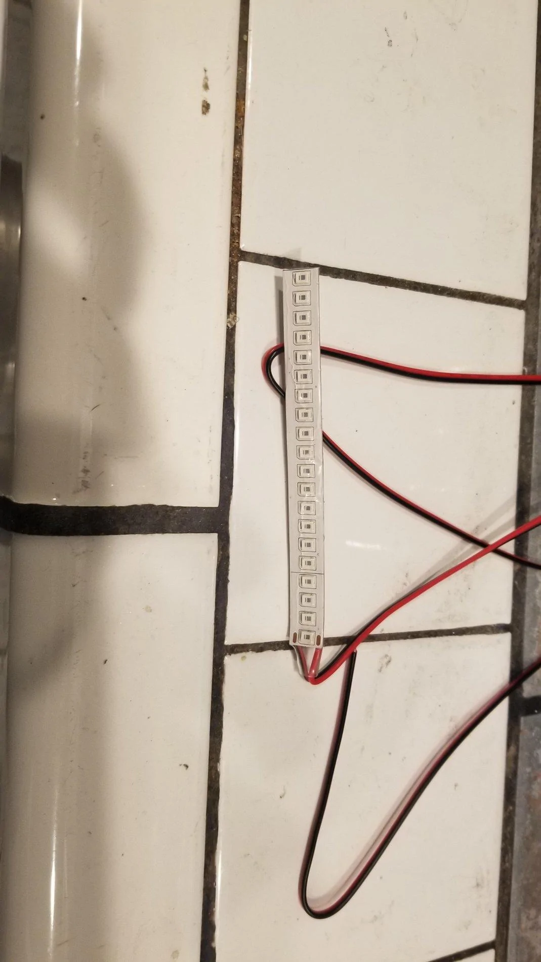

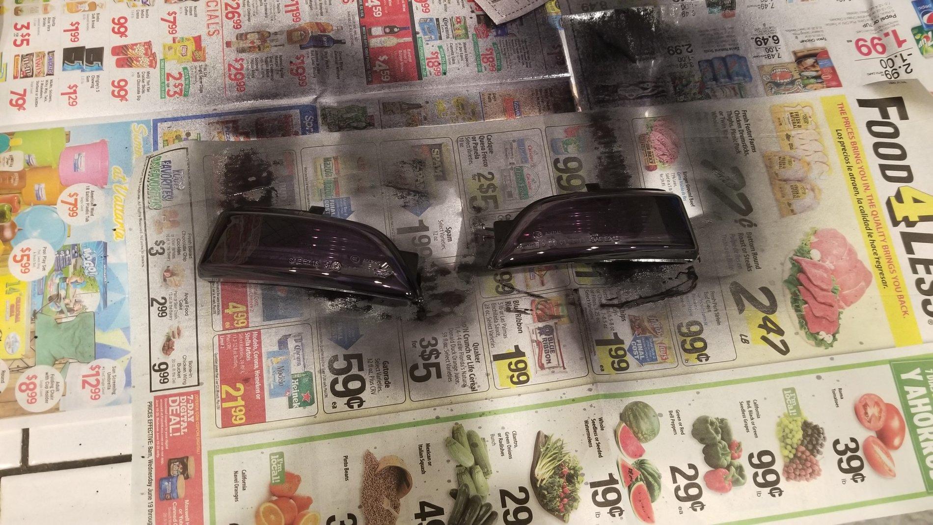

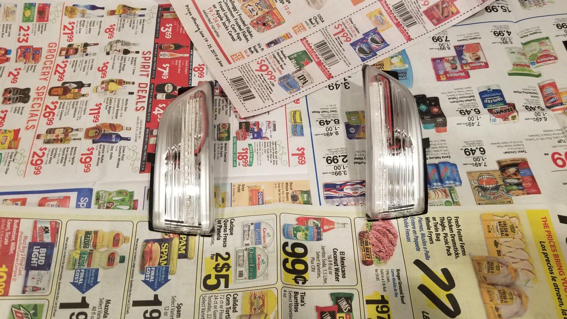

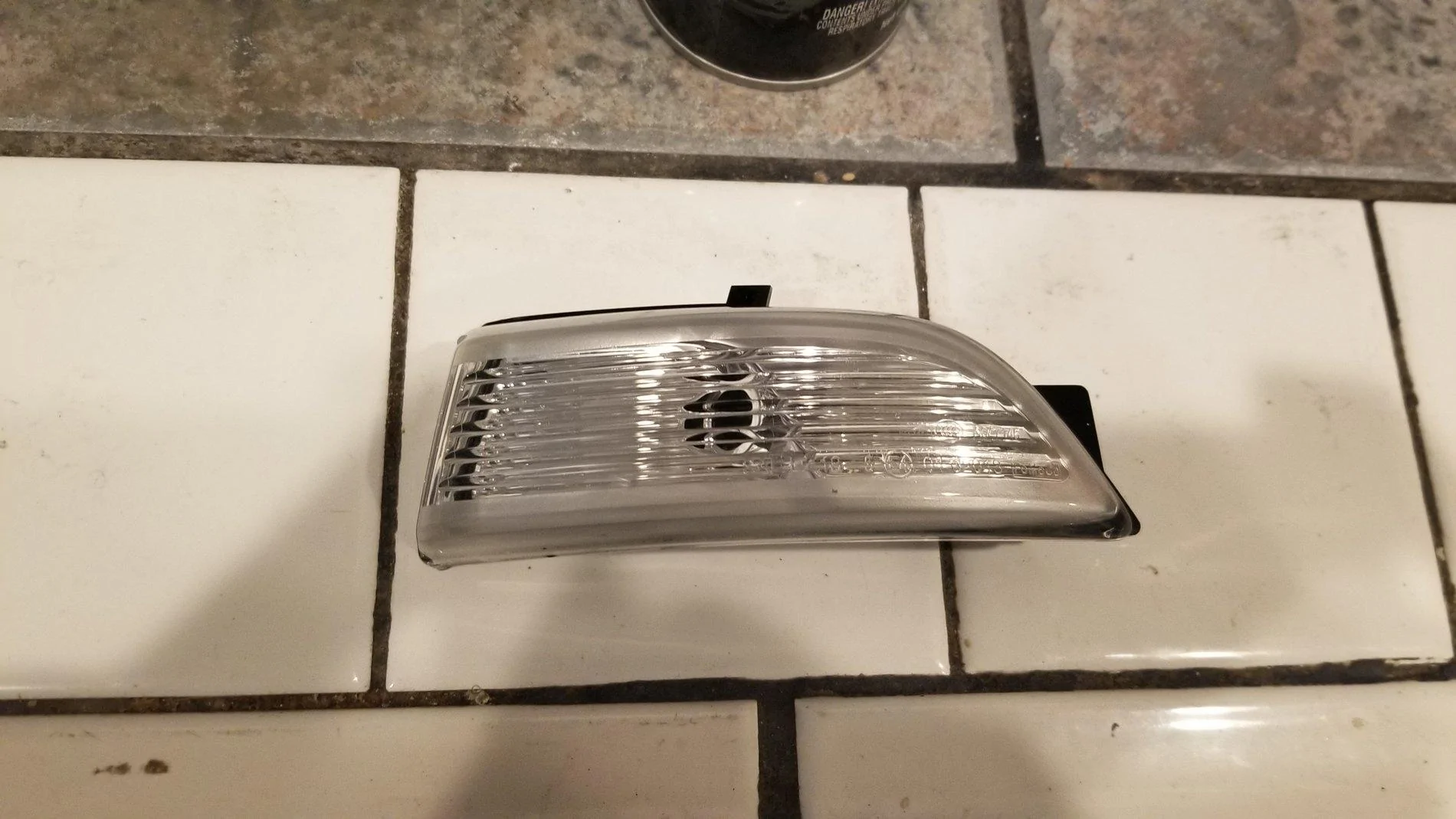

Since I couldn't find anyone that made smoked sequential turn signal markers for the mirrors I made my own.
