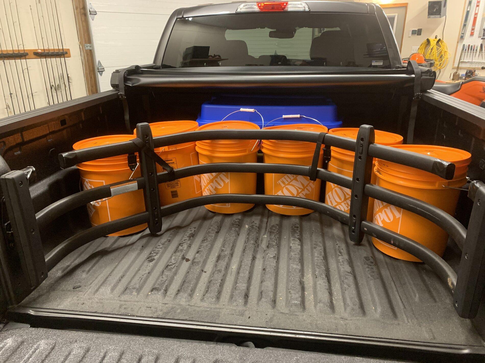

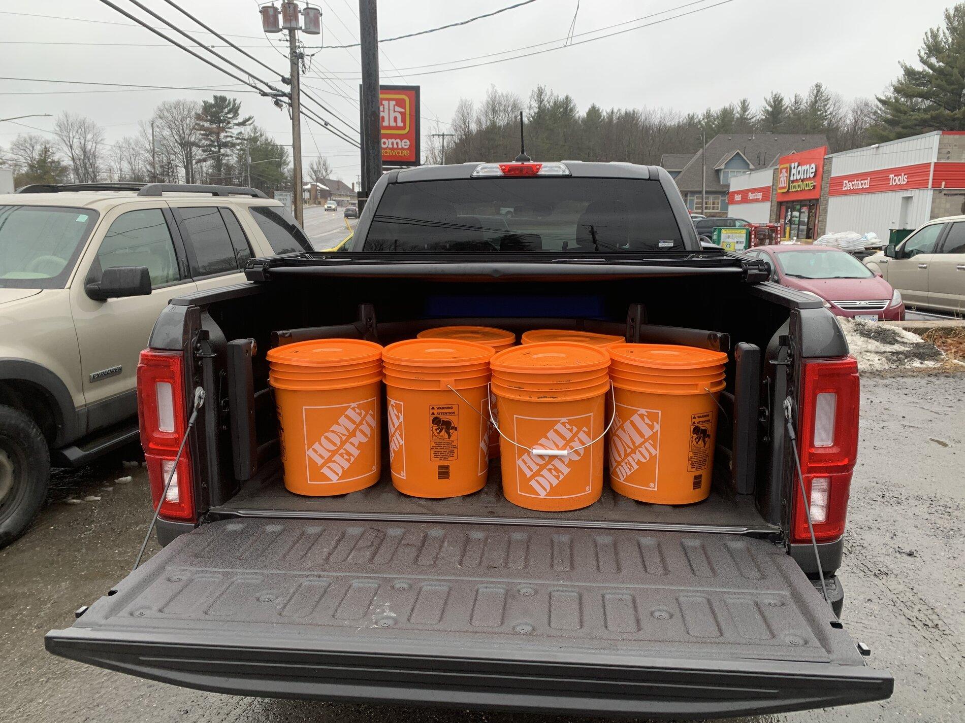

Drove to town today to get the pails and sand. The cottage roads were slushy and icy. I drove according to the conditions and the truck performed 100%. It sort of made me question why I was adding the weight, but knew that it would be beneficial in more extreme conditions.
The six pails fit perfectly in the bed extender area. They were not filled quite to the top, but I figure I have 320+ lbs of weight now in the back.
Being in pails with handles, they will be simple to remove, or if I want to lighten, by taking out some sand. I have a deck that I can back up to, that acts as a loading ramp, so it would be simple to walk on and lift and walk the pails off if need be. (I.e. if I had a long drive and knew the roads were going to be good.)
The extra weight In the back gives me a free mini “level”. I drove back home with them in the bed and did not notice any negative effects.

Looks good, should help.
Some Std keyboard warrior nitpicks here:
https://www.homedepot.com/p/Quikrete-60-lb-Tube-Sand-115960/100318522
Or something similar is what I use.
If possible, Its best to center the weight over the rear axle or slightly forward. For better weight distribution other wise it starts pulling weight off the front. Hard to do in the crew cab ranger because cab is so close to the rear axle.
Leave the weight in there until summer. Better to have it and not need it than... etc. Mpg affects are minor.

I mean technically, from a purely statics perspective, you'll get the best use of the added weight, as far as putting load into the rear wheels, by moving it further back. That's what gets a larger moment arm and forces more load into the rear wheels. Having the load forward of the rear wheels puts some of that load onto the front wheels. Granted, it's very small given how small the bed is and how little the weight can be moved around fore/aft, but still.
I'll agree that obviously at a certain point, the further aft you go, you'll eventually have 0 load on the front tires and wheelie, so it shouldn't really be done in the real world.
But if all you wanted to do was get more traction to the rear/drive wheels you should stick that load way out the back. Could even reduce the added weight to 10lbs if you had a long enough arm out the back. haha
Sorry the engineer in me couldn't let it pass. haha
Lol yes effectively turning your truck into a seesaw on the rear axle ?.
My point is to not reduce front braking traction while trying increasing rear wheel traction.

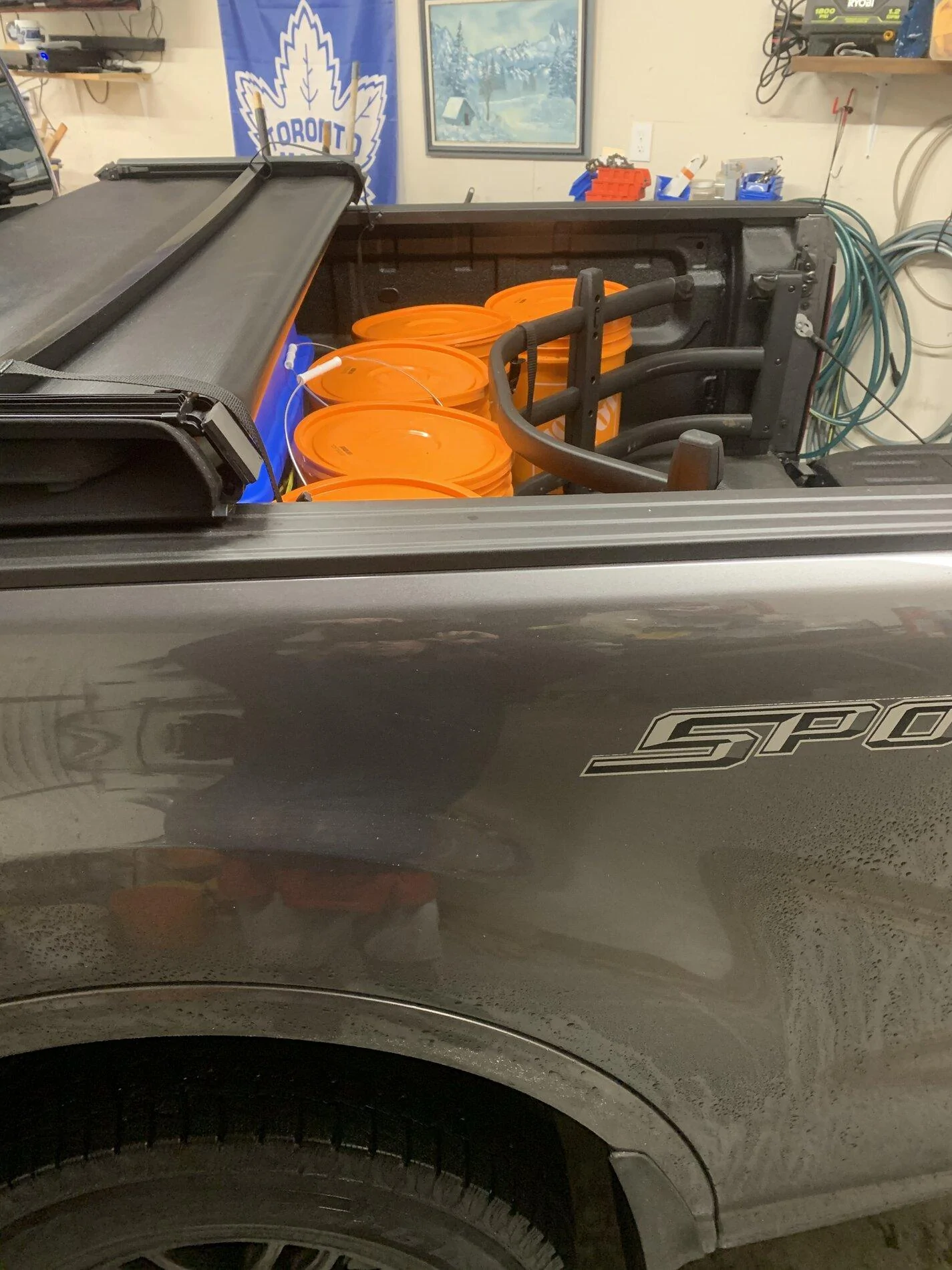

I am always open to advice and willing to take it if I think it makes sense. This made sense to me, so I moved the pails to the other side of the bed extender and basically directly over the rear wheels. The pails are bordered by the bed extender and a Rubbermaid container, which holds lots of essential things.
As bonus, it gives me back the bed extender area for groceries or whatever and it should help not raise the headlights as much.
Thank you for the advice!
