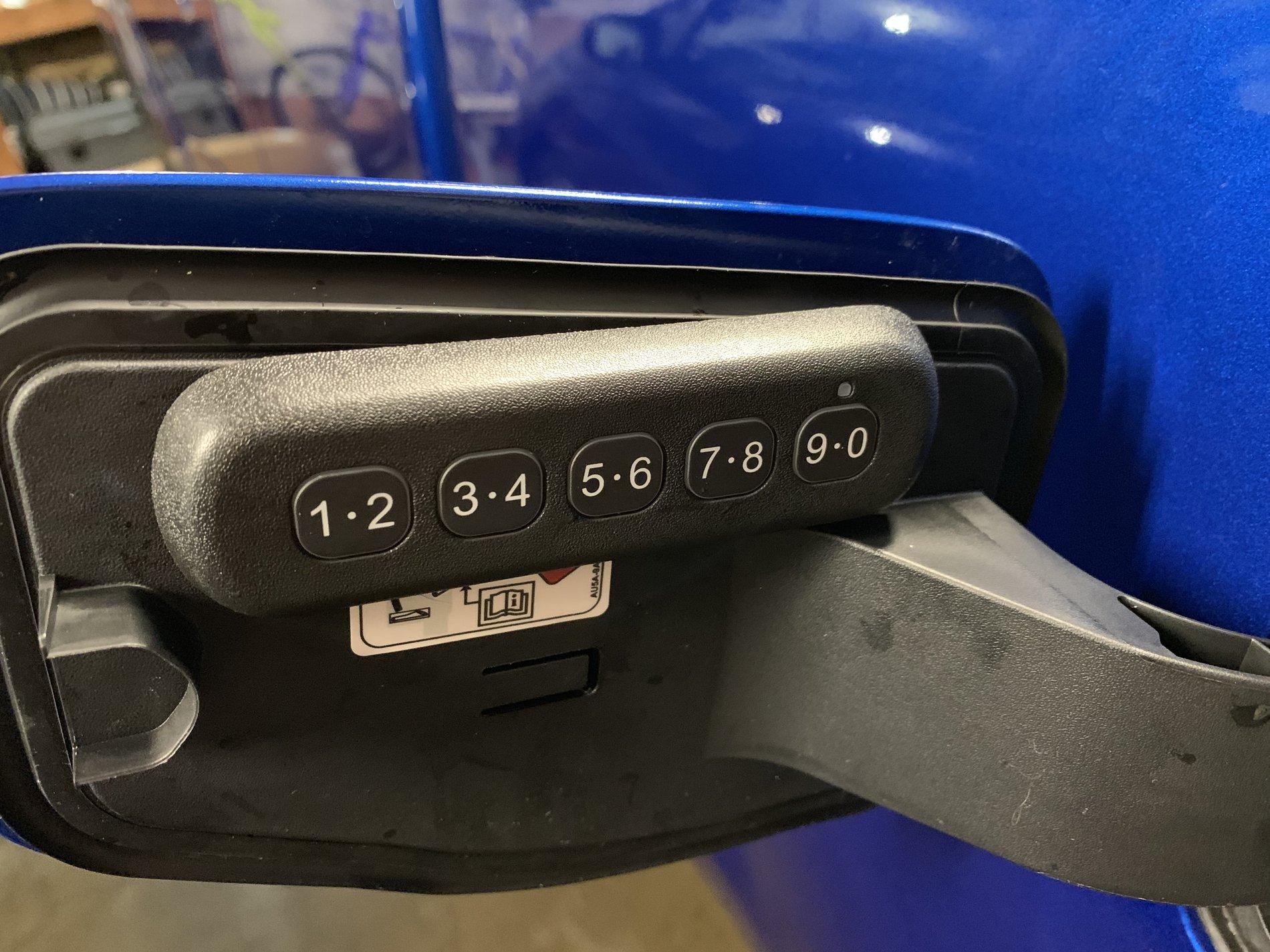

I ordered a keyless pad since I couldn't get one already installed. It is a battery operated unit that I'm going to see if I can place on the interior of the gas tank flap. I'm hoping it works as well as the one that came on my Explorer.

And now it's installed and working in it's new location. And to answer any questions yes it works, the memory held the code, it works from 50 feet away, the outside cover is just cosmetic and it still is protected from dust and water, nothing hits when you close the door (why I left the cover off). Used dental floss and turtle wax paint safe sticky remover. Best $85 I ever spent ha

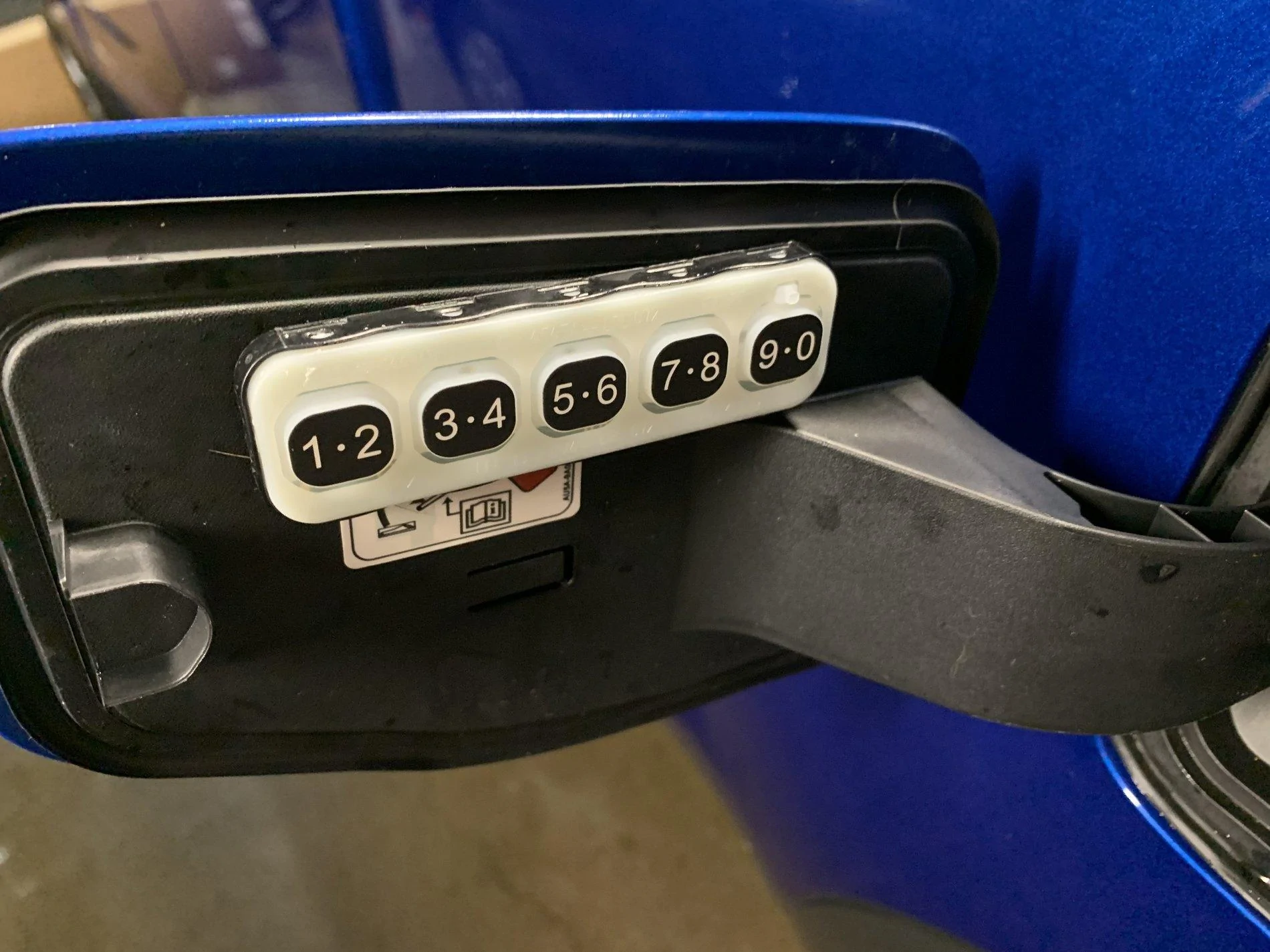

I moved mine to the cover, and my keypad base is white... Did you paint the keypad base black? I did put my cover back on and the fuel door does shut.
That looks great!! My keypad is black, but I haven't taken it apart yet to see what color it is. I am going to use your idea and put it on the gas tank flap. Hope it works!
I did not paint, post a pic of your white keypad please, I am interested to see
I took my cover off. Underneath it's black except for the white rubber for the light. Is it preprogrammed for my truck or do I have to program it? I bought it from Ford.
It's preprogramed, you can add another set of number on top of the Ford's. When I tried to program my 2nd person number, it won't let me.. I was thinking maybe the dealer did it for themselves, and I removed it and then I was able to add mine.

Interesting it is white lol
I moved the sticker
