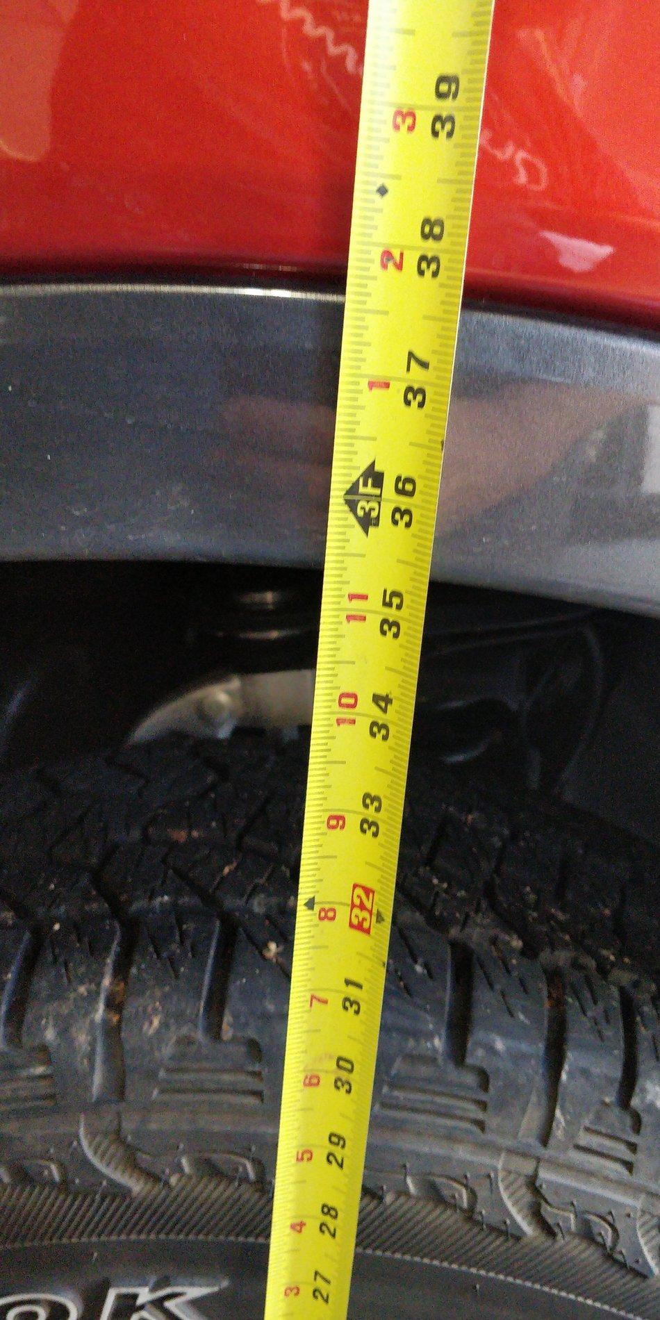

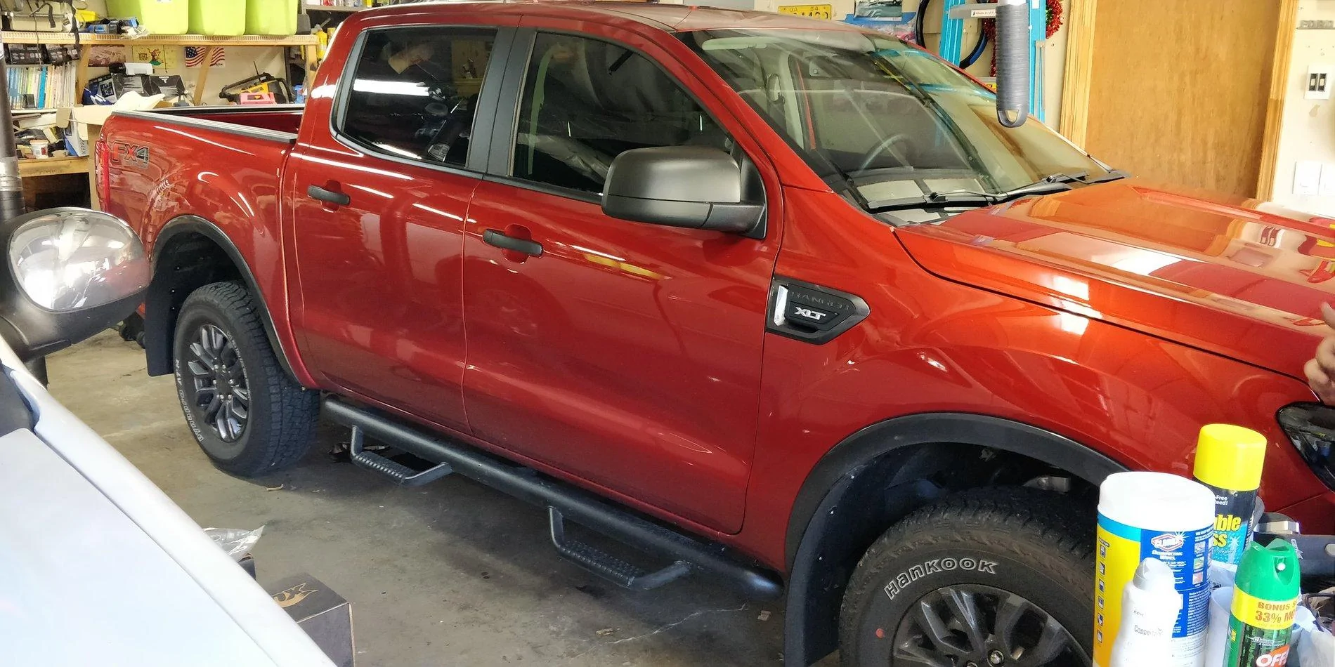

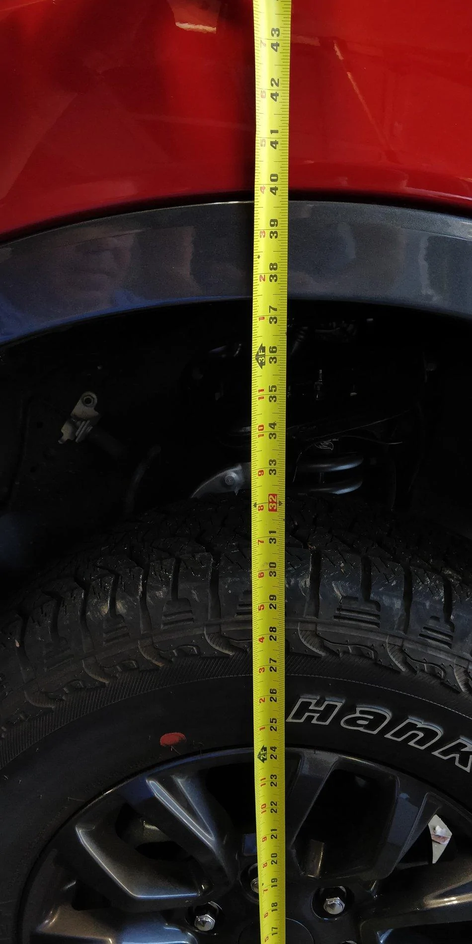

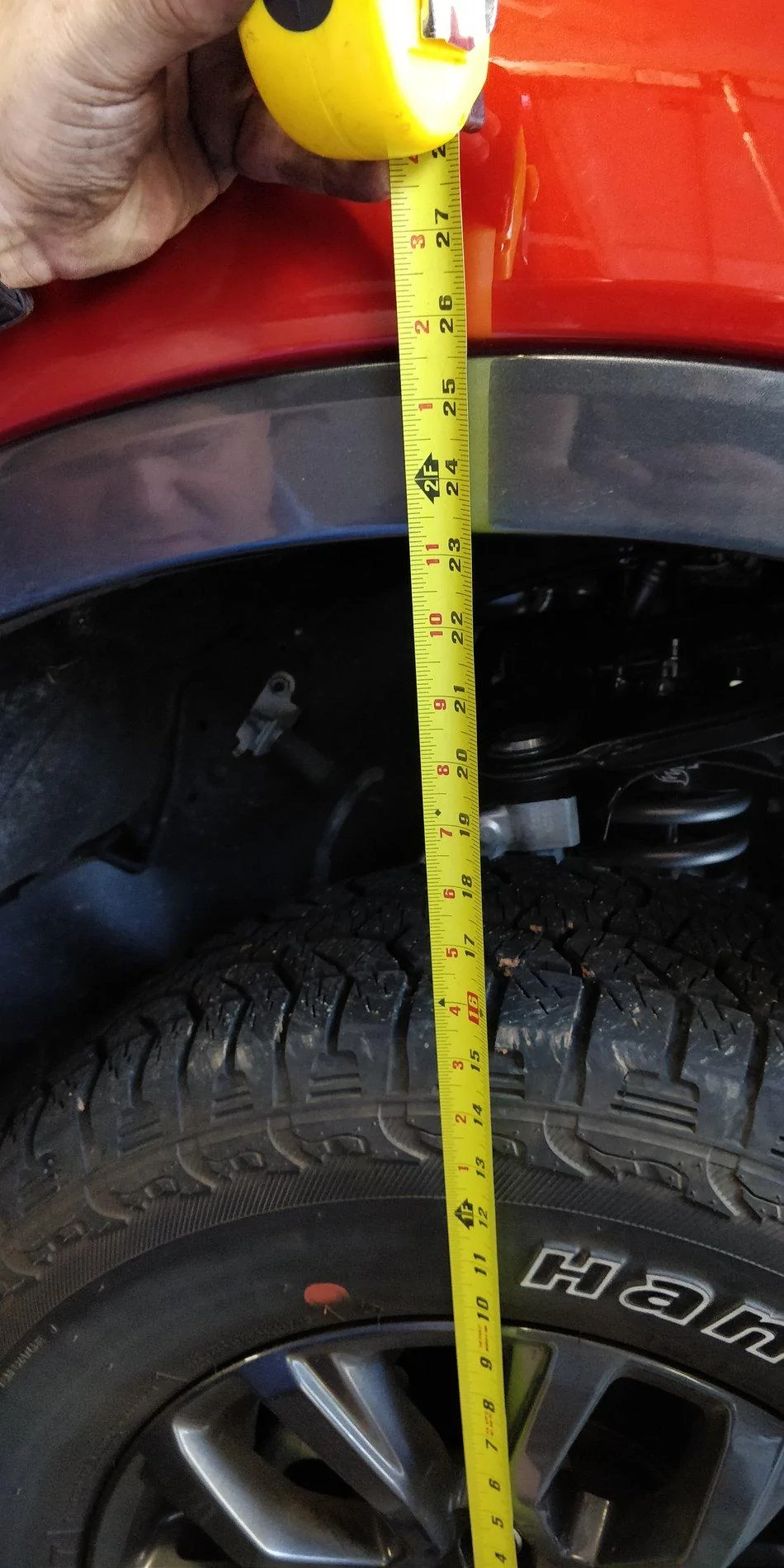

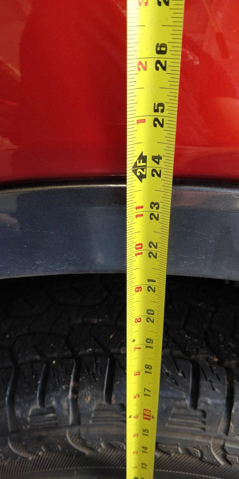

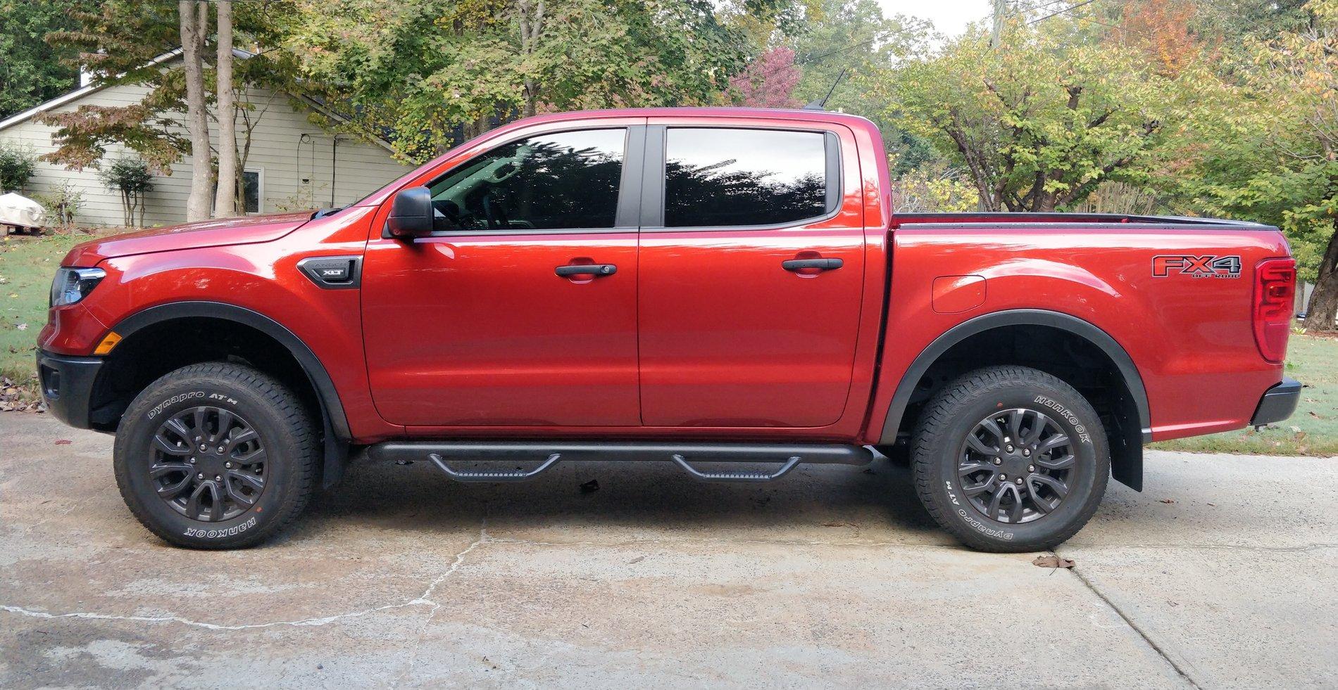

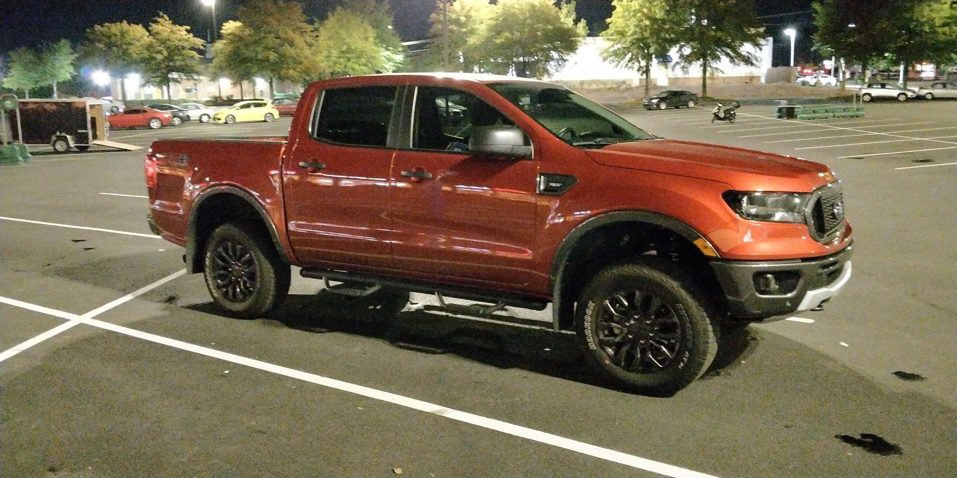

The weather held off and I was able to get everything installed with the help of a friend. I still have to get an alignment done tomorrow, but I'll throw up some of the requested measure pics and stance pics that I remembered to grab while working. Overall, lifted the front the promised 2 inches, and yes, the shocks are adjustable! Woohoo!
The ride quality from just riding home from the friend's house (speed bumps and potholes and uneven pavement): These shocks are the bomb. No FX4 floating feeling whatsoever. Absorbs bumps like no other! Fixed the bouncing rebound on the front and softened up the rear suspension just the tiniest bit so you don't feel every bump in your spine. Haha!
First pictures are the axle to fender height stock then lifted. The next are the ground to fender height stock then lifted.
Lastly we have the truck in the shop and then sitting in the publix parking lot while I was grabbing some ice cream.

Can we get a straight side shot? Hard to see the rake.
And thanks for posting. A lot of us are really interested in this mod.

How long did the install take you? Level of difficulty? I've swapped suspensions before, but every car/truck is different.
Wyatt Owenby
Sep 6, 2019
40
Student
Pretty straight forward, we read through the instructions, then went our own way. The instructions had you undo the lower ball joint and install the shock from the bottom up, but we decided to undo the upper ball joint and go in from the top. The only thing to be aware of doing it our way is that you don't pop the CV joints out of their homes. Lol
The rears are a piece of cake.
Difficulty: 5/10 with the right tools
Duration: took about 4 hours or so
