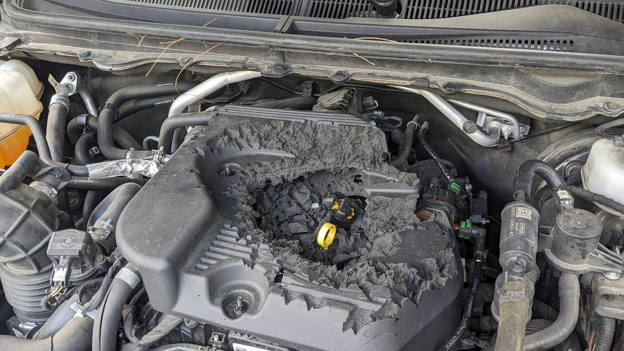

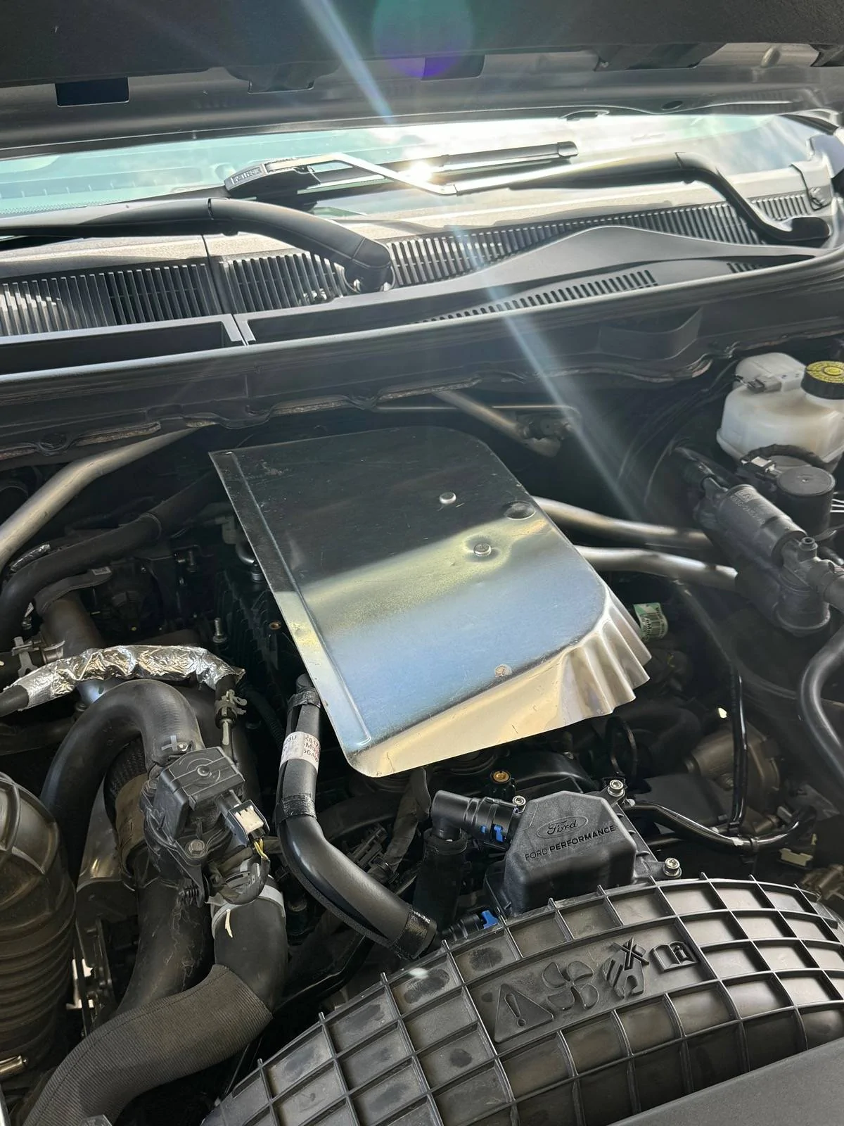

I’ve also considered adding an engine cover. The factory ones can get eaten and the aftermarket one is cool looking, but a little pricey. I was wandering around Tractor Supply yesterday and came up with an idea for a DIY engine cover. Rodents can’t eat it and water rolls off it.

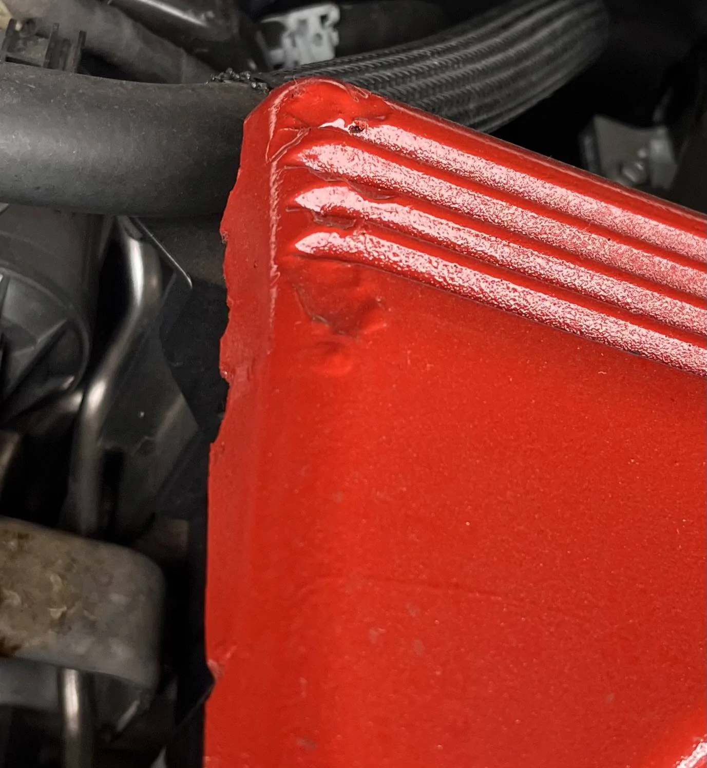

Serious about the tasty treats for rats.
The deep in a city in California, and they still were in my engine bay before I added the engine cover. I painted it to look cool. The rat still chew through it. The paint is not nearly as durable as a professional factory thing would be, but I still like it. The ultrasonic/light infrared flashers have kept them at bay.
