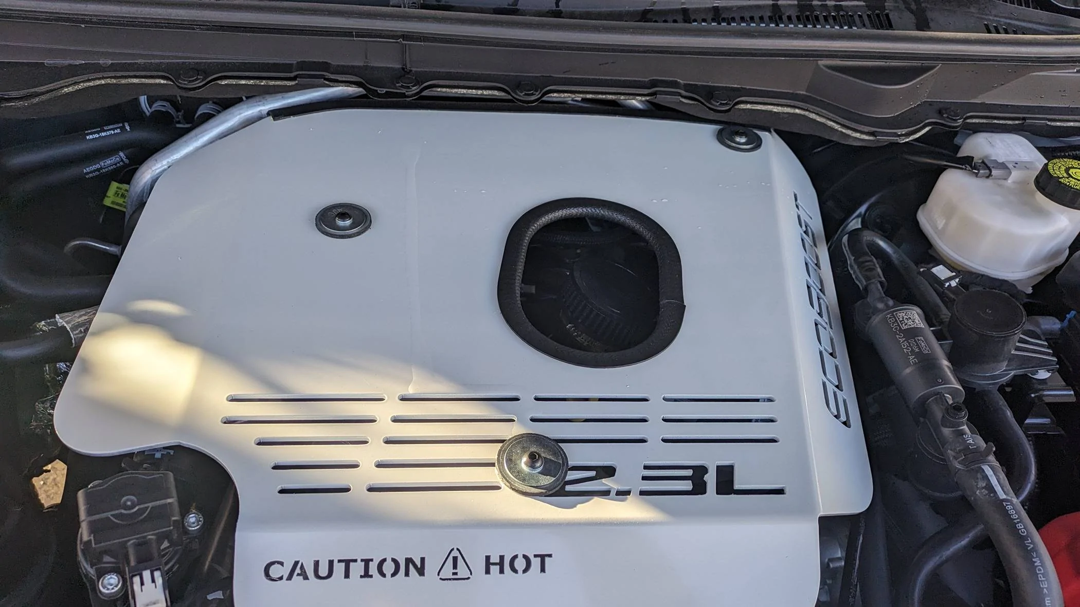

I have tried from two sources to get a engine cover for My 2021 Ranger Super crew xlt and each time they have stated that they do not make one for this model. Both times I tried to buy one from a Ford Delership. The engines are the same regardless of trim level right ? They have the covers for the Lariat model only. What iam I missing ?
I put this one on my Ranger, it looks great and the critters cant chew through it. More worth the price than the foam one from Ford:
https://www.jcroffroad.com/product/RG4GNC.html

I like the color match, mine is just the basic black powder coat, not sure the blue would look good in there.
Sure it would...and create multiple opportunities for you to buy other color-matching accessories/parts!
