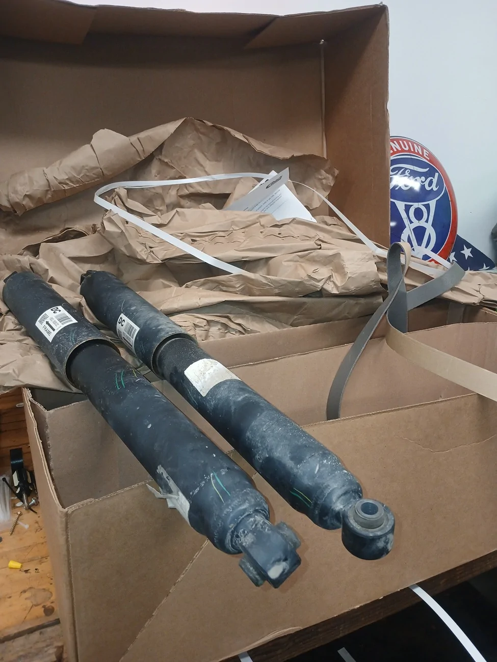

Got a sudden burst of energy(see "King of Hammers" thread) and decided to knock out the rears real quick...
Edit: test drive confirms much improvement , especially speed bumps , BIG difference on those...

Yes. I did rear shocks last week. Definitely a better ride.
LR was a bugger to get off. Bottom bolt had Gaulded to the bushing in the shock. Had to eventually cut the bolt off. But, worth it.
