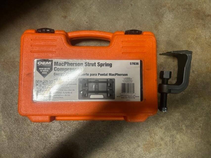

The Ball Joint Tool was an Ebay Find (used) - Ford Rotunda PN: 204-592
The Spring Compressor is AutoZone (Loan A Tool) with option to keep (I think I will keep it)
This fits over the coils perfectly and had no problems compressing the spring enough to get it apart.
When I did this professionally, we had a wall mounted compressor (much safer) than this, but it worked and just ensured I was taking it down slow and easy, and my safety pins stayed in place.
Thanks much for the details. I wont need the spring compressor due to installing complete unit. I did purchase the ball joint tool. Hell $12 at NAPA was well worth it. Thnx again. ✌
