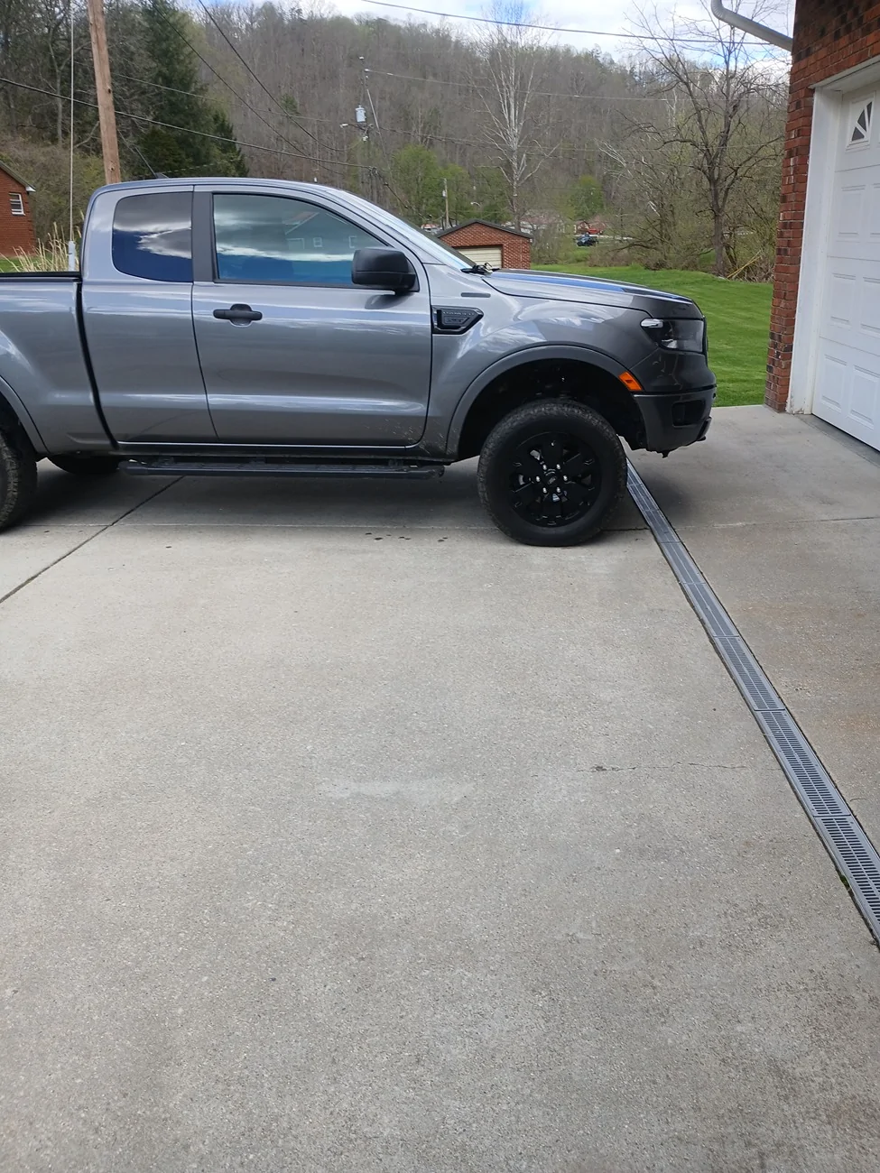

Well my dumb ass didn't take any before pics or measurements so I'm not sure where I'm at... I did have to jack it up more to get the wheels on so it must be taller...
TEST DRIVE ! drives straight and no pull but my steering wheel is just slightly off center now , but i was getting an alignment anyway so no biggie ... it might be possible to mark them more precise than I did but it's pretty hard to keep them perfect while trying to torque them...

Looks good to me. I like the way it looks setting level.
Time for some bigger tires. If that's what you like. I dont like the way mine has the Giant gap between my rear tires and top of fender well. And I went 2 sizes taller right after buying mine.
All 4 or just the back? All 4 I hope.
200 lbs in the bed solves that problem... :LOL:

And the whole damn thing is a little too high as I had extra air under my foot when I stepped out...
I went with larger tires at the same time and at first, the view from “way up there” was quite noticeable and getting in and out sure was a bit different.
Like so many things, you’ll get used to that extra nose height in no time.
