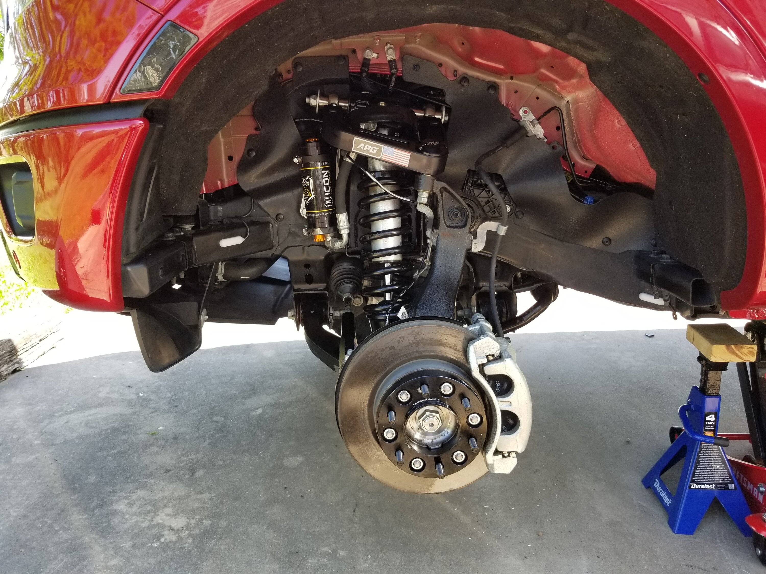

Any concerns with the extra droop causing any problems with CV joint operating at the increased angle, or binding on a ball joint tie rod end?
I'm running an extended travel ICON and APG setup with a Heim joint tie rod end (greater range of motion) ......would a limiter strap be necessary in any scenario ?...
I'm not worried at all on my stock length setup. Are your LCAs longer?
Also, your down travel is likely limited by that Icon uca fouling the shock tower. It's a feature, not a bug!

I have stock length LCA , and the APG Billet UCA. and Billet tie rod end with Heim joint... no binding on the shock, Before the tie rod replacement it appeared the stock ball joint end was maxed out and binding at full droop.. At this point only thing limiting more travel would be the sway bar...
I know another Ranger (George, white Ranger) with a full APG build and I know they don't run sway bars and haven't had an issue. If you are concerned I'd recommend maybe reaching out to APG and seeing what their thoughts are since they would be most familiar with their suspension setup.
Ah, I see the UCA now. Nice setup.
Pull the wheel and swaybar off and cycle the suspension. That should get you your answer.
