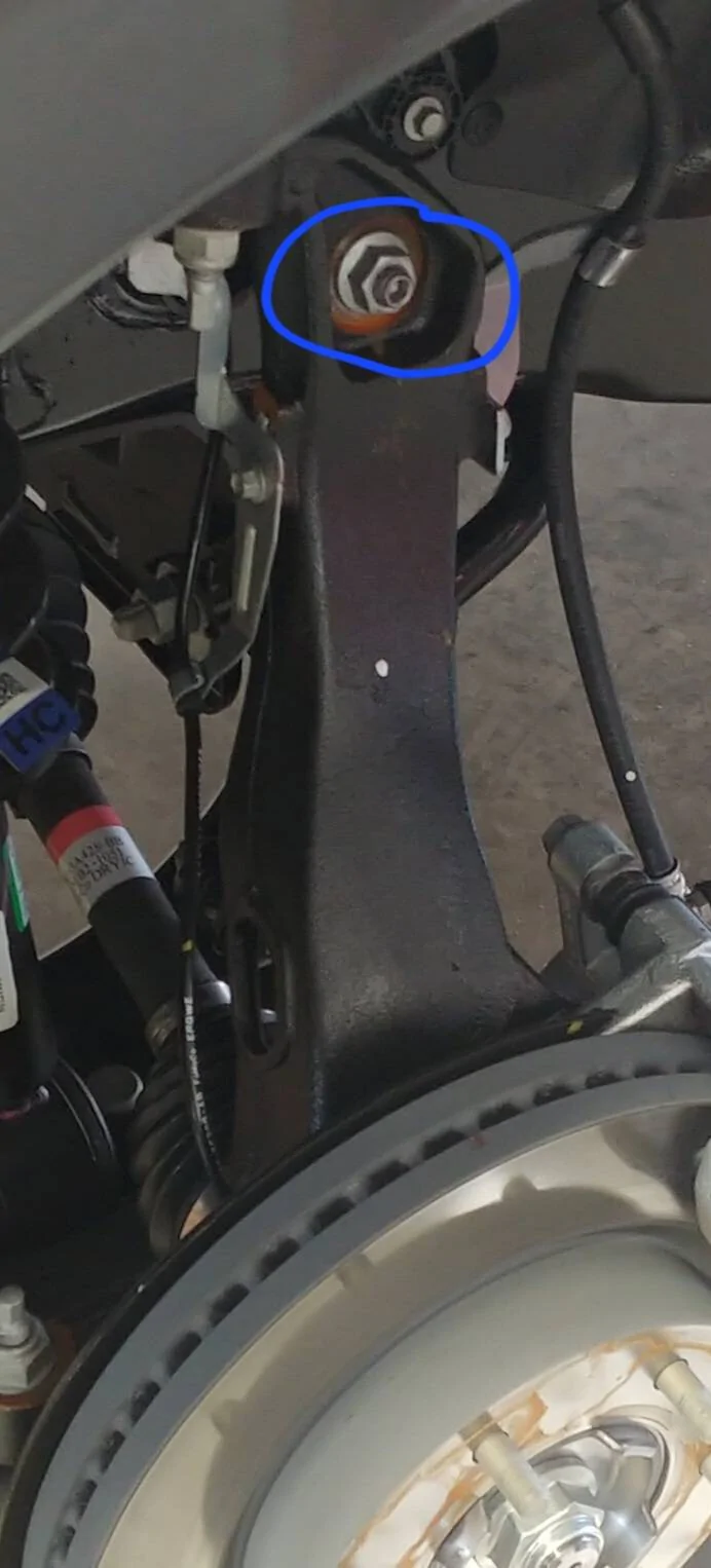

2.5 level will definitely work. this is the hole that needs to get drilled out. And yes it's the width of the rubber bushing on the swaybar link that needs some trimming.

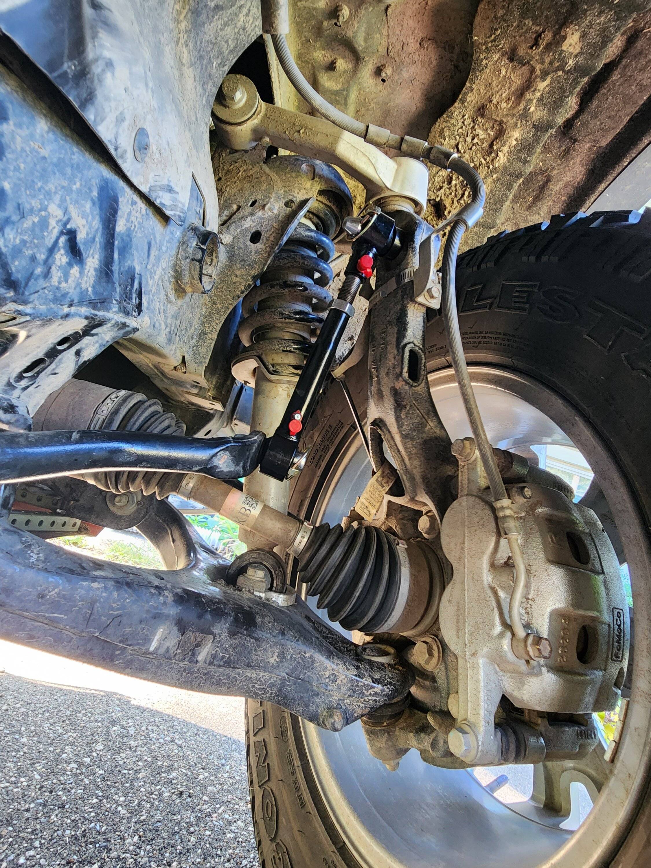

If you have a lift you can use wrangler jku adjustable swaybar links with minor modifications. I bought these off Amazon and only needed to shave a little off the rubber bushing and drill out the steering nuckle a tiny bit.
AL4X4 Adjustable Front Swaybar Quicker Disconnect System With 2.5" - 6" of Lift Replace 2034,fit for Wrangler JK JKU 2007-2018

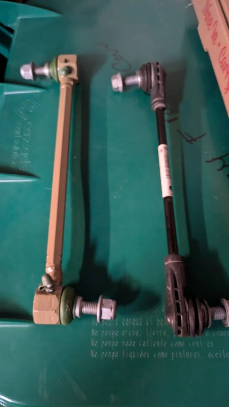

I realize this was a few months back, but having just swapped my links out and gotten a good look at the factory links...
My bet is it popped off because they're garbage. Cheaply constructed with small diameter steel shafts and plastic ball joints housings.
Do you really NEED them? Doubtful, but if you do a lot of road driving on windy roads it might be a good plan, I dunno.
Factory on the right vs aftermarket left, I was looking at these to see if there was a way to make them QD or something. Gotta say you won't find me altering a $320+ steering knuckle to make a $40 QD sway bar link work ?
