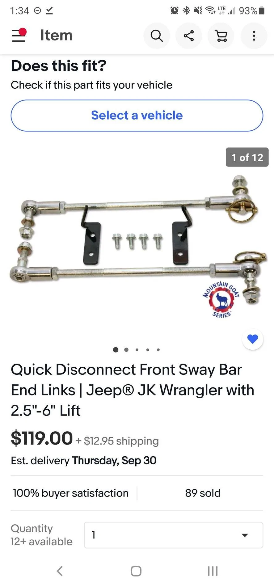

Here... Both rotate and it has a locking pin so no worrying about push disconnect issues or rattling. Plus has a holder when disconnected too...

Has this been verified to fit our Ranger?

You have no idea that the studs are the same size unless you have tried them or measured and compared.
