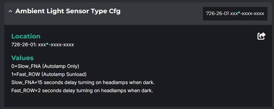

Try changing this setting - BCM
To my knowledge this is untested
Note: Factory Hex (As-Built) for this line is:
0100-0003-0058
So try changing it to (1) as follows
0101-0003-00xx
Once you write it the last 2 will change to a different check sum (automatically)
There are mote settings that you can try if this does not work
Its strange though as I don't drive in tunnels but when I transition into my garage the headlights kick on fairly quickly and my setting on this line is set to the factory of 15-Seconds
