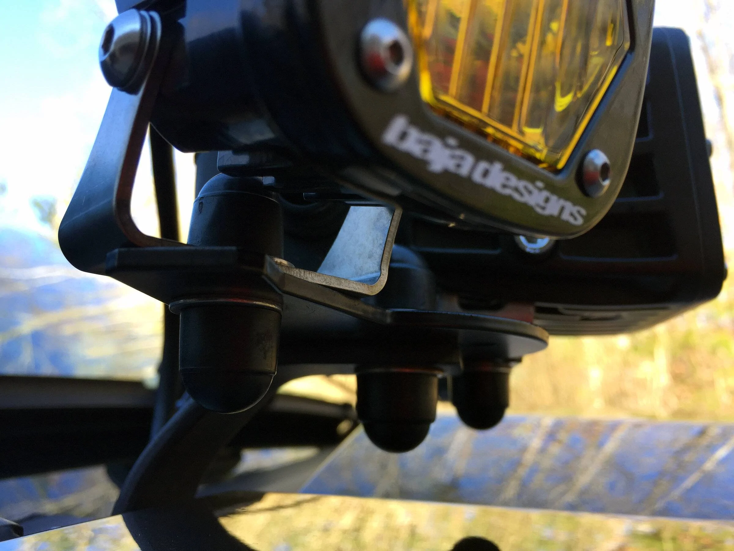

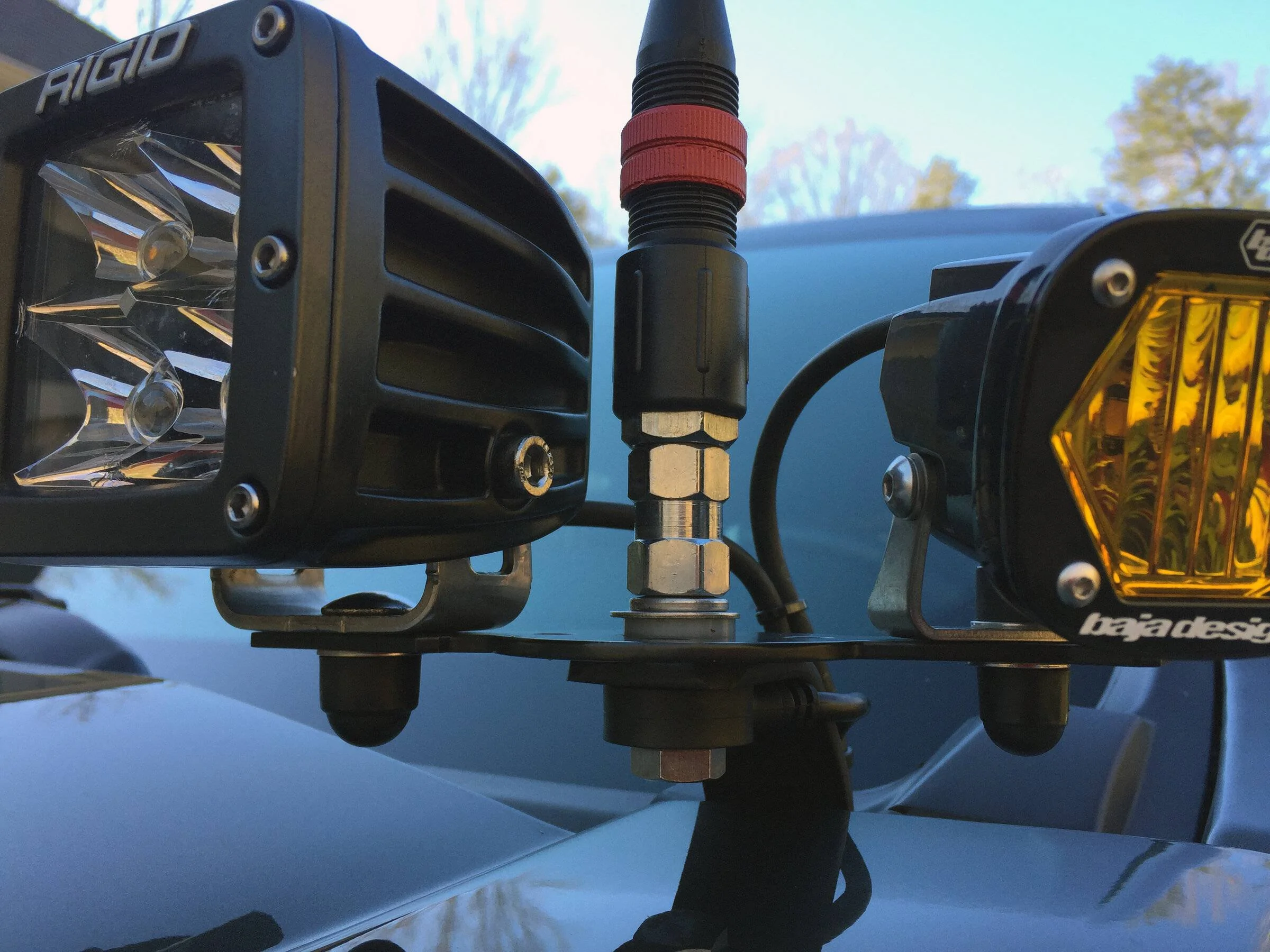

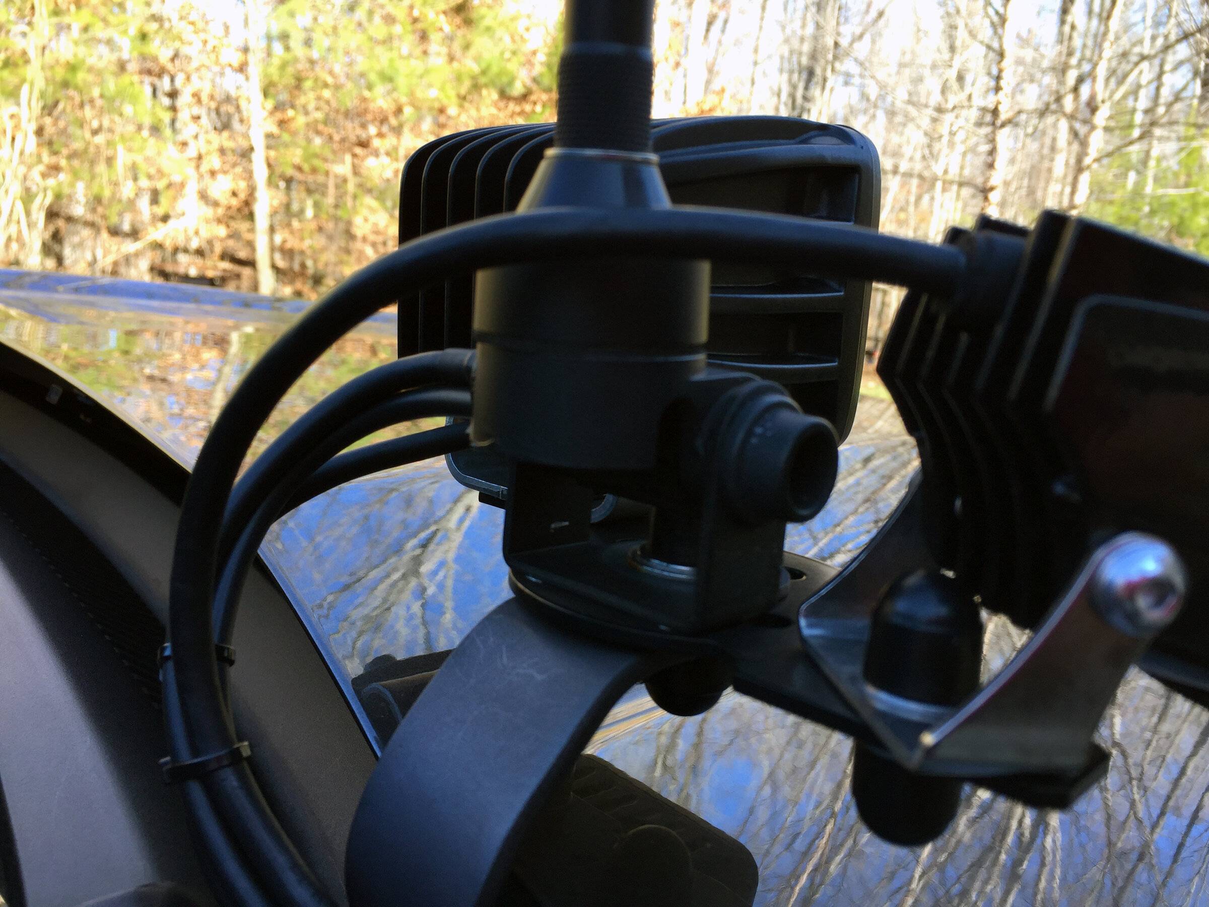

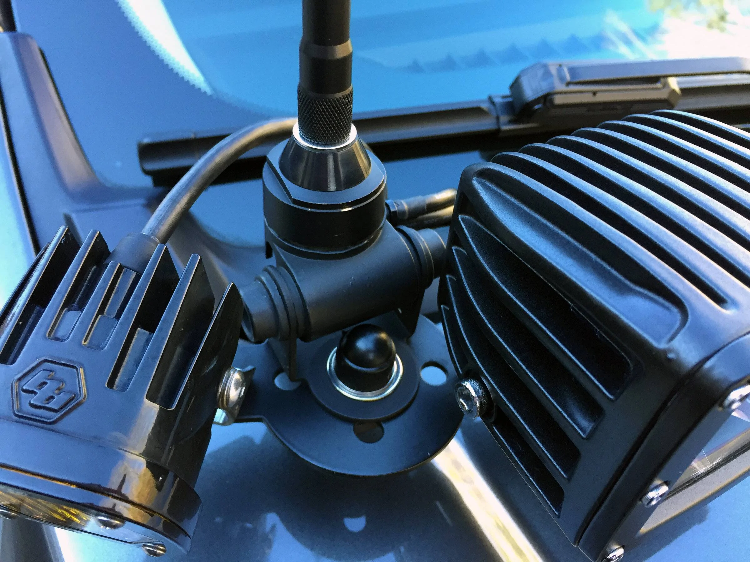

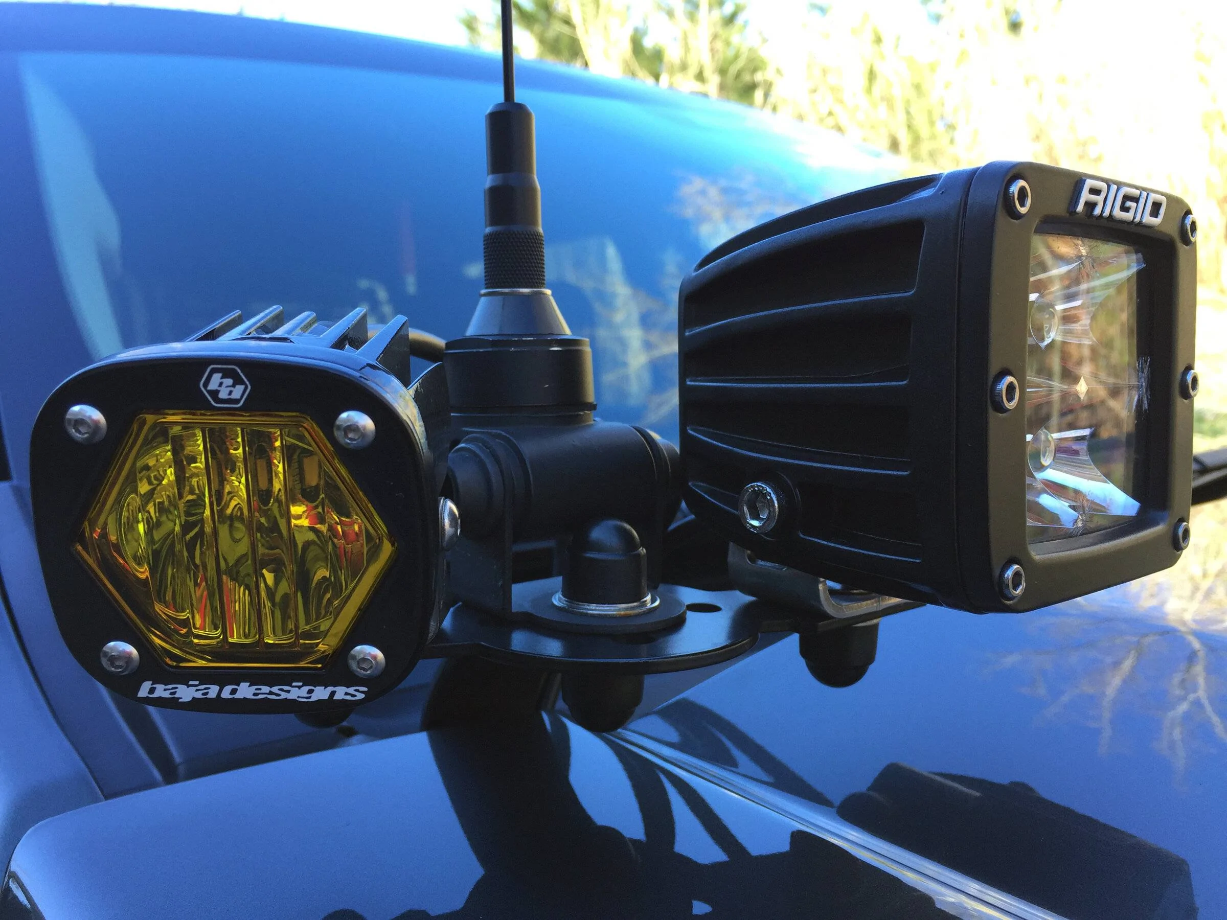

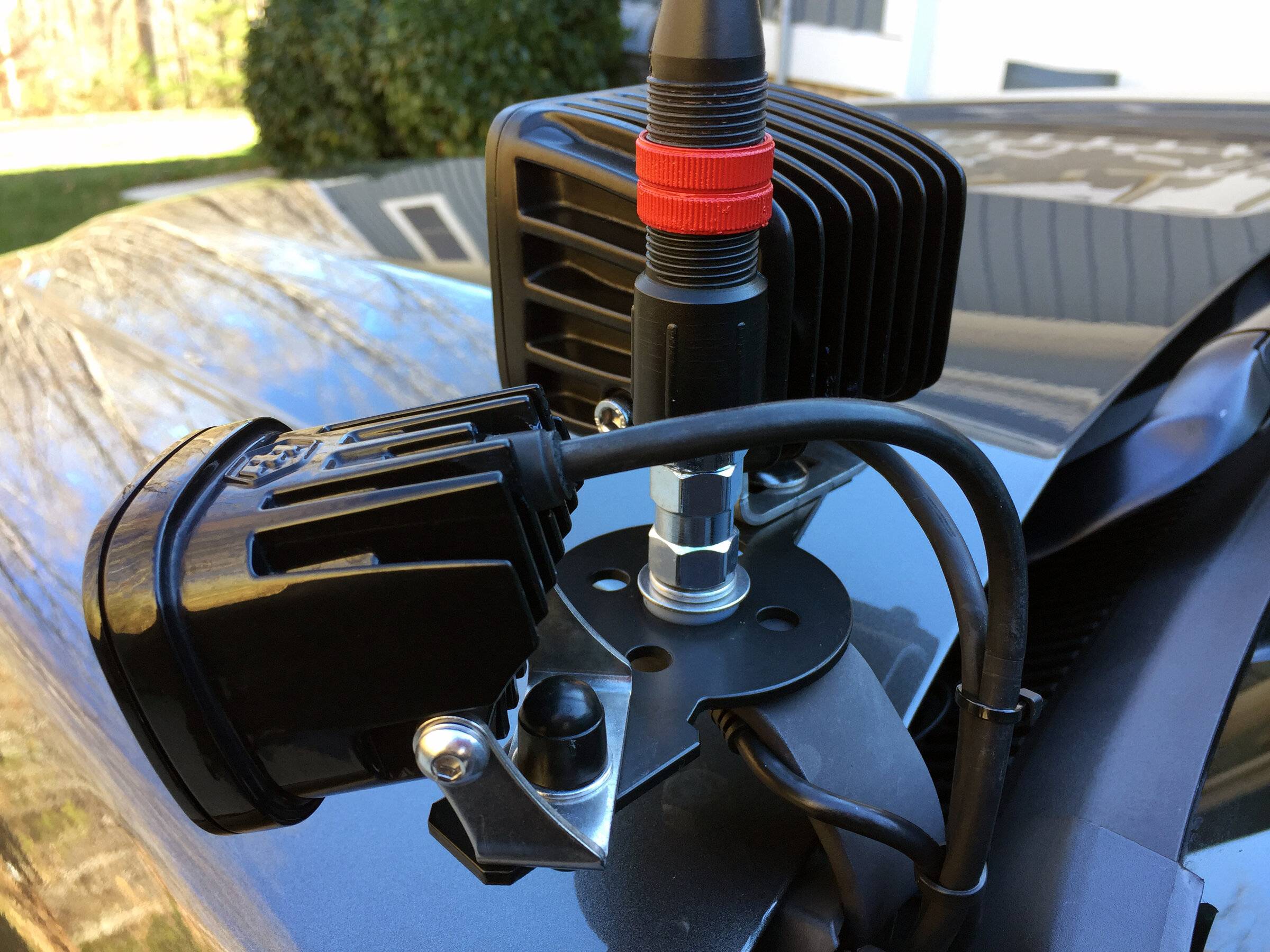

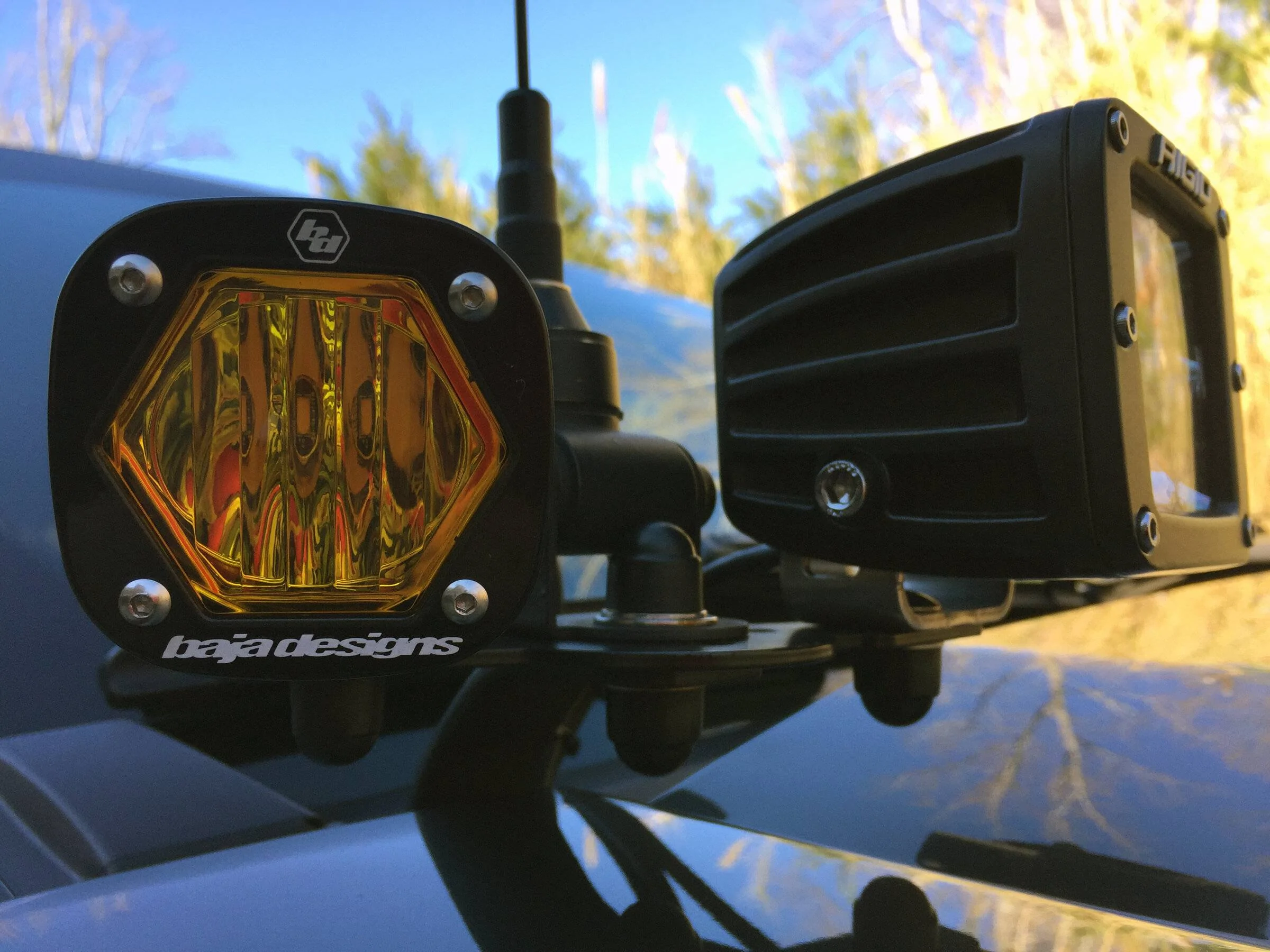

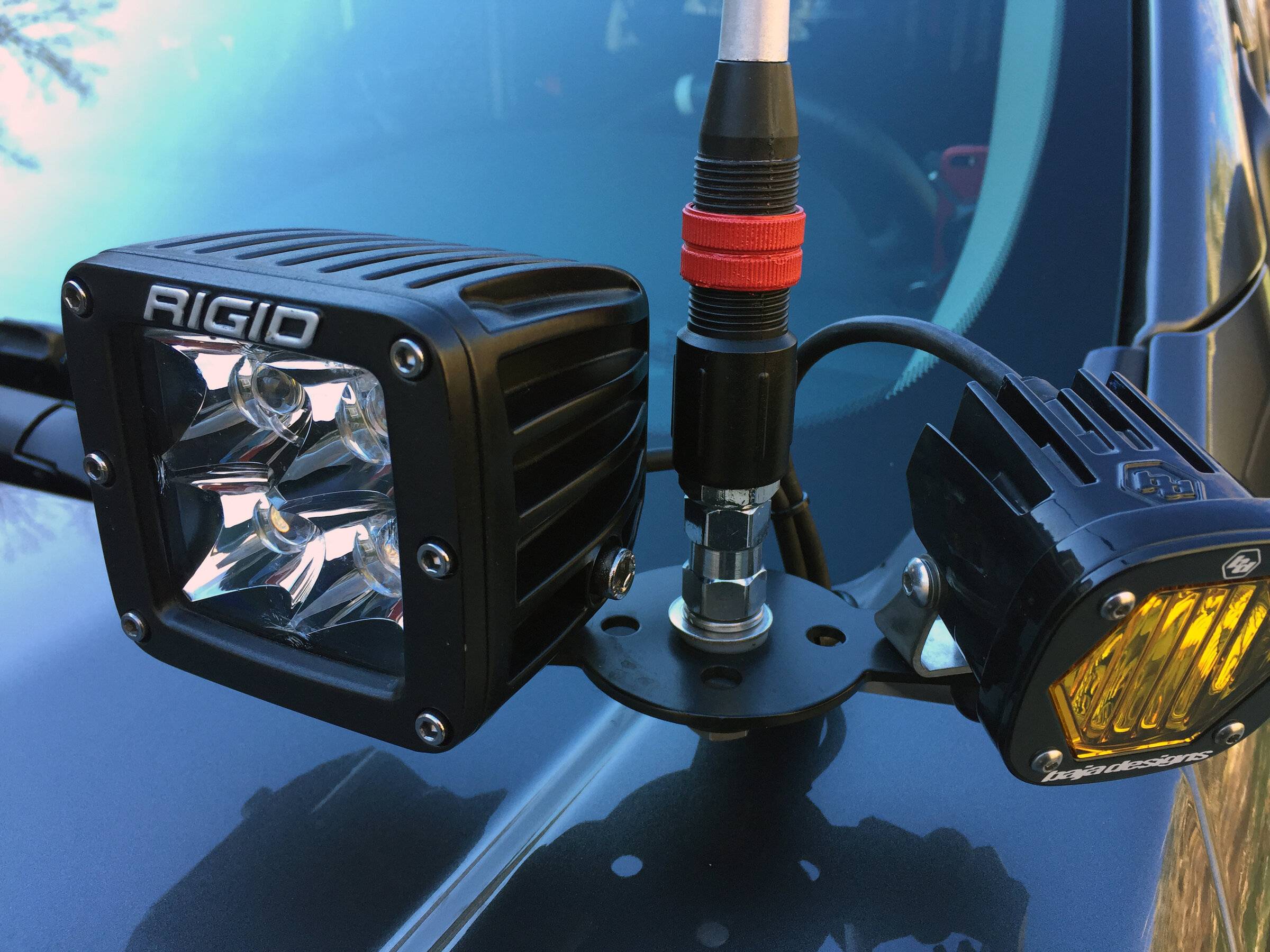

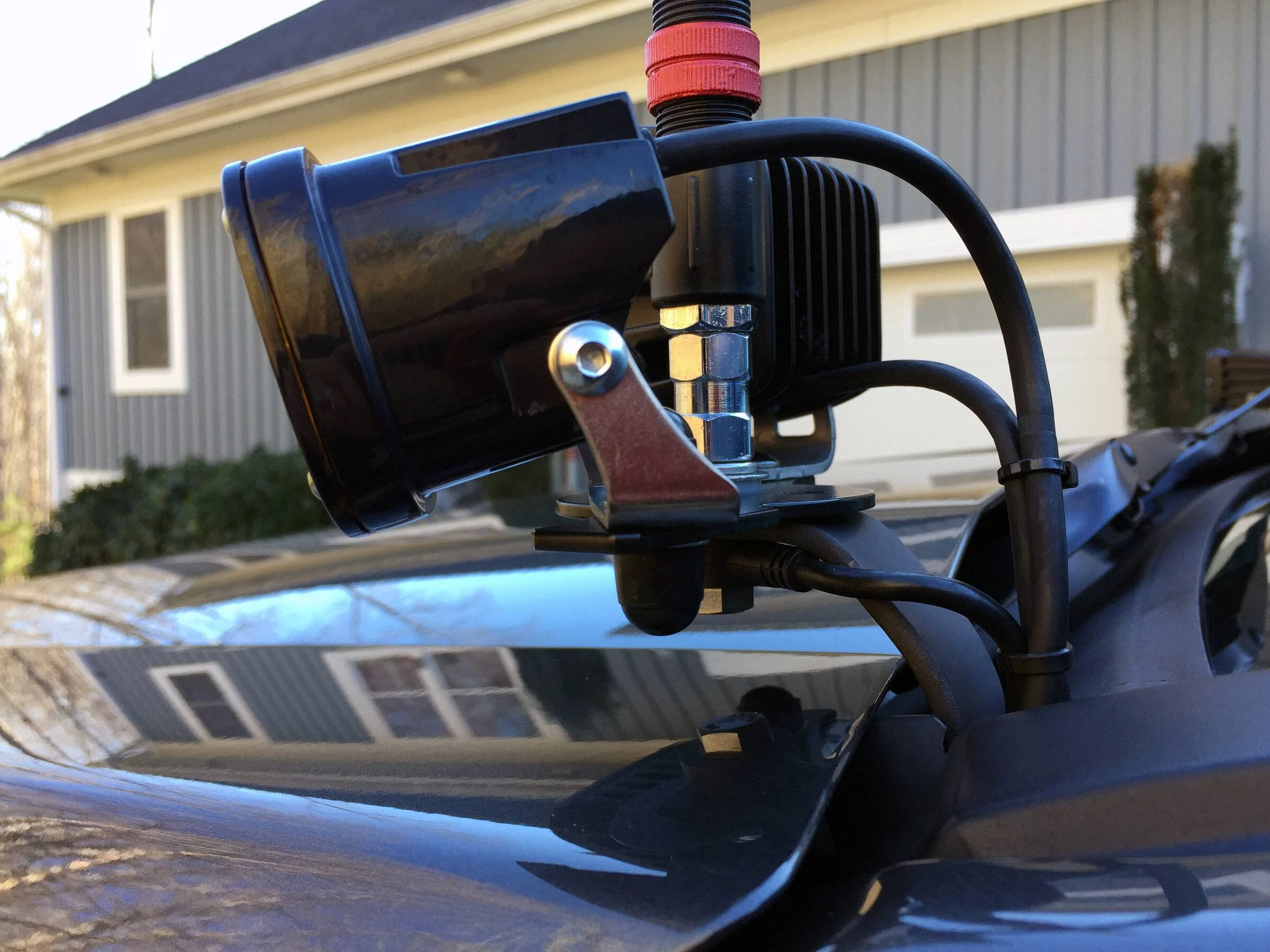

I've had members here ask me about my ditch bracket and antenna setup so I'll summarize here as well for those who want to know...
The ditch bracket are from:
https://fordrangerlifts.com/shop/ols/products/a-pillar-ditch-light-brackets-2019-ford-ranger
Although this version looks different and more expensive...I paid $60 when they first came out...
The perch on the ditch bracket is here:
https://www.amazon.com/gp/product/B01AT5IZAC/ref=ppx_yo_dt_b_search_asin_title?ie=UTF8&psc=1
The center hole is enlarged to bolt through for antennas...driver is CB and uses:
https://www.amazon.com/FireStick-FI...=firestick+antenna+stud+mount+,aps,88&sr=8-15
Passenger is for GMRS/SW and uses this setup, again bolted through the light plate and ditch bracket:
https://www.amazon.com/gp/product/B07PT44LSZ/ref=ppx_yo_dt_b_search_asin_title?ie=UTF8&psc=1
I've recently upgrade my GMRS/SW antenna to a NMO mount type which necessitated boring out the swivel mount hole to 3/4"...
https://www.amazon.com/gp/product/B00IDTJ2KE/ref=ppx_yo_dt_b_asin_title_o05_s00?ie=UTF8&psc=1

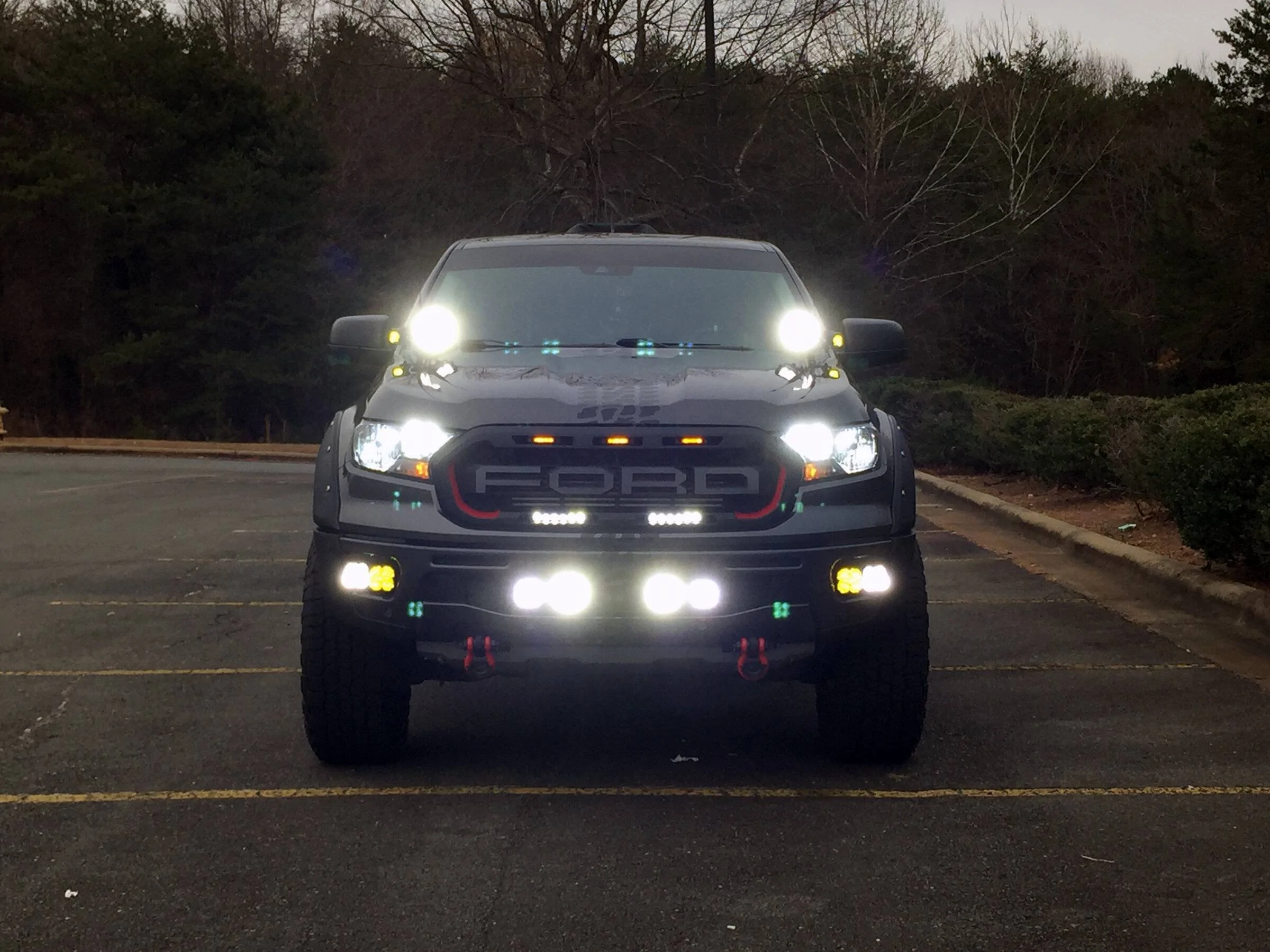

What are these lights, I'm not seeing them in that photo?
Yes you do...they're the Rigid DPro spots on the ditch mount...I need to take an updated night shot...
