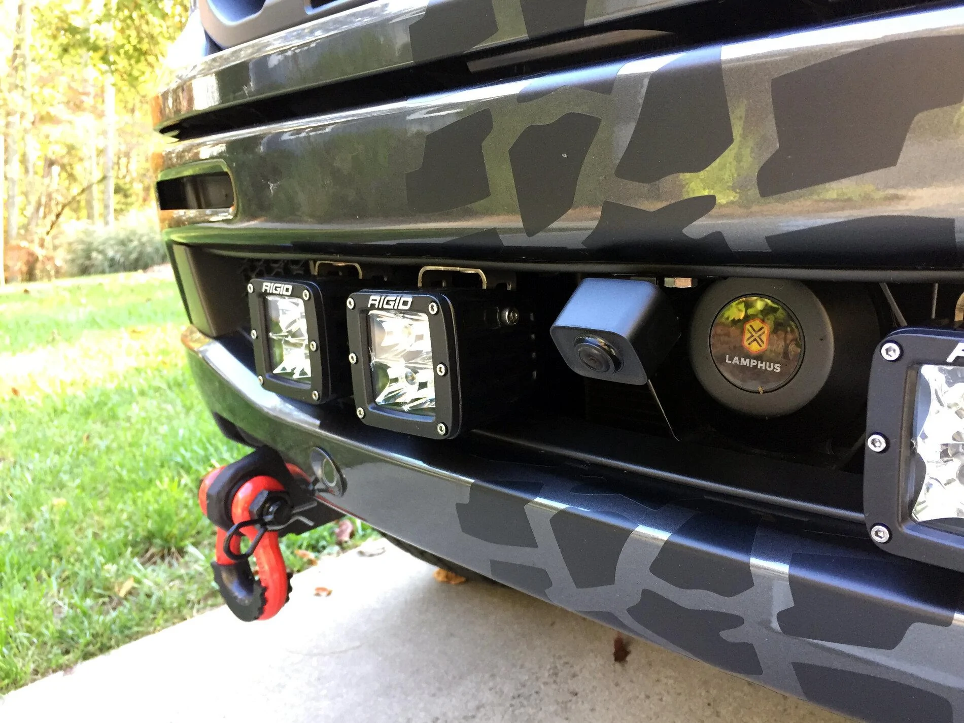

Front rock camera set up and running...
9,192
28,359
NWO Robot Polisher

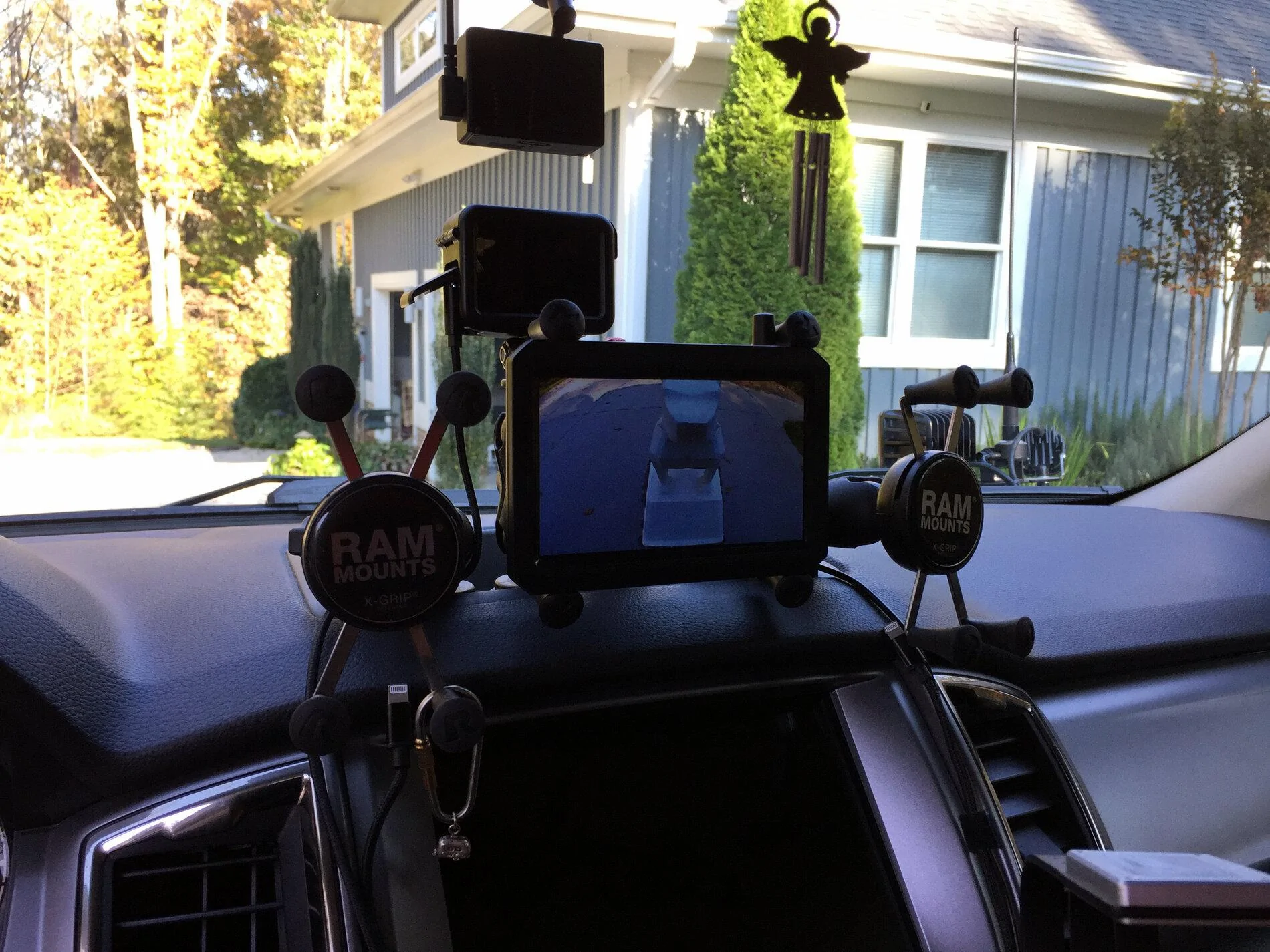

Details?!? I've been considering getting a front camera for a while now.
Of course...I couldn't find any info on front camera at this or any other sites...factory version that hook into the head set was way to complex for my instant gratification lol...finally I found a review on a product for back up camera that was very positive and affordable so I gave it a shot...
https://www.amazon.com/gp/product/B07Q85L22L/ref=ppx_yo_dt_b_asin_title_o04_s00?ie=UTF8&psc=1
Wireless camera! Power to the cam is connected to the...what else? Park lamps...
It's claimed to be water proof and I think it could be easily mounted to the under carriage aimed at the front tire or rear...in my case I wanted to keep it above the water line that I'd be experiencing and see what's being blocked by the massive hood...
Camera can be set up for front or rear and in my case always on when my park lamp is on...works incredibly well day or night! I'm diggin this for a buck and change... ?

You can mount this guy anywhere as long as the power supply cable can reach a source...
