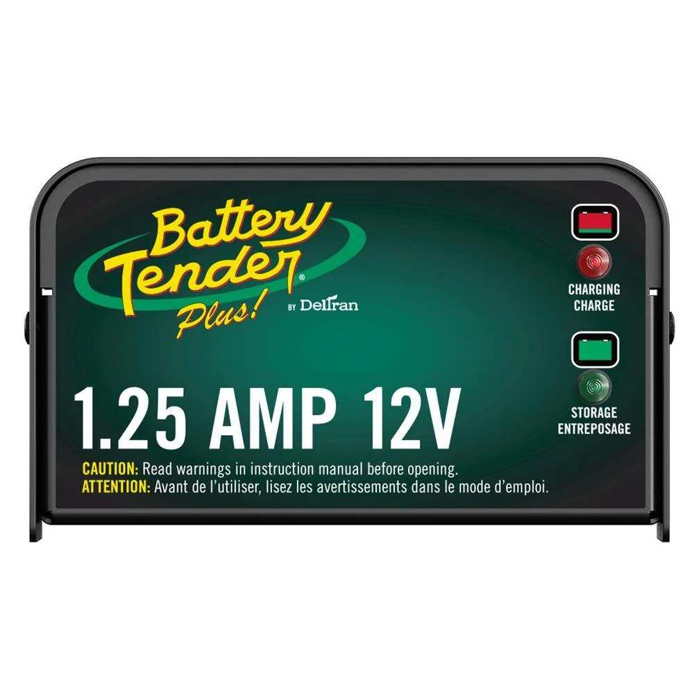

I rarely drive my vehicles, so the parasitic loss hits them hard. Once per quarter, I plug them up to a battery minder - desulfator like the Battery Tender as a form of battery maintenance. Keeps the plates clean, maintains battery capacity and extends the life of the battery.

@Progeny2021 The vehicle is basically new and the terminals are spotless. I do have a tender but I don't think thats the solution as I do drive daily, just not that far. Truck started just fine this morning, if the battery was bad or going bad the short drive home yesterday and the truck sitting overnight I should have had issues this morning.

Got mine in June of 19. Not long after it happened to me one time at home in the driveway. Not since, still have original battery. Checked every thing at the time & all checked good. Just before I called to have it towed to the dealer I got in & everything was normal. I do have a battery maintainer as driving is not as often now. Even with maintainer on it will go into sleep mode from not driving in like 14 days.

He further warned to not put a tender on the negative post but the frame ground as to not damage the module or cause the BMS to loose track of the state of charge.
