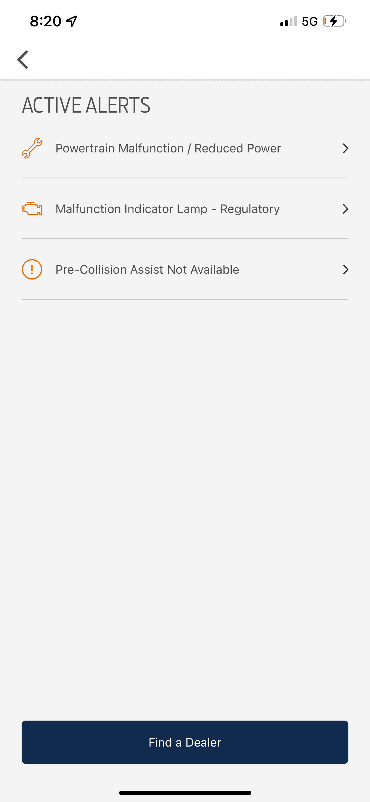

Took it into a well known off-road mechanic today. Placed an ARB Summit Bumper on it. Now, it’s sputtering. Lack of acceleration. Sputters after letting off of the gas pedal. It has a jerking motion from it. Ford Pass gave me to alerts. Also, the pre-collision alert system is disabled after bumper install. Took it to the dealership today. Under warranty. Pretty worried.

Sputtered prior to the bumper. Only very slightly. Any ideas?

I can’t offer advise on what‘s causing the problem, but I believe I would have taken it back to the well known off road mechanic first since the timing would seem to suggest that it’s related to the install, in which case Ford won’t likely warranty it. Could be as simple as a sensor becoming disconnected.

Do you have ACC? It may (maybe not) work hand in hand with the camera behind the visor and that might be the collision avoidance issue - if so, you need to relocate the ACC sensor if the bumper is blocking it.
Also, search for, and read the ARB bumper install thread on here to determine which sensors have been disconnected and learn about any other pitfalls to installing this bumper because as @Joeiconic says, Ford isn’t likely to pay a dealer to fix the installer’s mistakes and that well-known off-road mechanic needs to make it right.

If it was working when you took it in for the bumper install and not when you picked it up, it should have been returned to them. Be prepared to pay the dealer for their time to determine what was done wrong if it had nothing to do with Ford.

I'd put this back on the shop that touched it. Hoping it is just a sensor unplugged for you on the engine issues.. but what they would unplug to do the bumper and cause that I have no clue.
On the pre-collision, the bumper might be blocking the sensor for it?

Something got disconnected, maybe only partially, wires got tugged on most likely , or pinched perhaps ? I'd retrace my steps before I let Henry look at it ...

Would it be a battery issue? A winch was also installed with the bumper.

My guess is the "well known mechanic" messed up somewhere. Is it something easy to fix? Possibly but without it in front of me I can't tell you anything

Your main front sensor (box) was down low where the winch was put. So that had to be relocated and reaimed. Wire will be short on that harness for doing that. Did you have front parking sensors (4) in your old bumper?
It seems enough “tech” is inoperable so it’s putting you in limp mode. Curious also of how the winch was wired in. If not done right it messes up the intelligent battery monitoring system.
