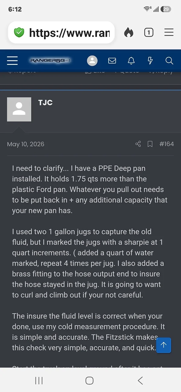

Found this in the search I recommended.
If you have a FitzStick, you can quickly and easily validate the level using the Cold Fluid Level Check.
  1. Let truck sit overnight on a level surface
  2. Start struck and shift through the gears at 5 second intervals from Park to S and back to Park
  3. Immediately check the fluid level. It should be just on the tip of the dipstick up to 1/8".
At this level, when measured at 215F, your fluid will read on the diamond between 4 and 5. This is the dead center of the fluid level acceptable range per Ford Specs.

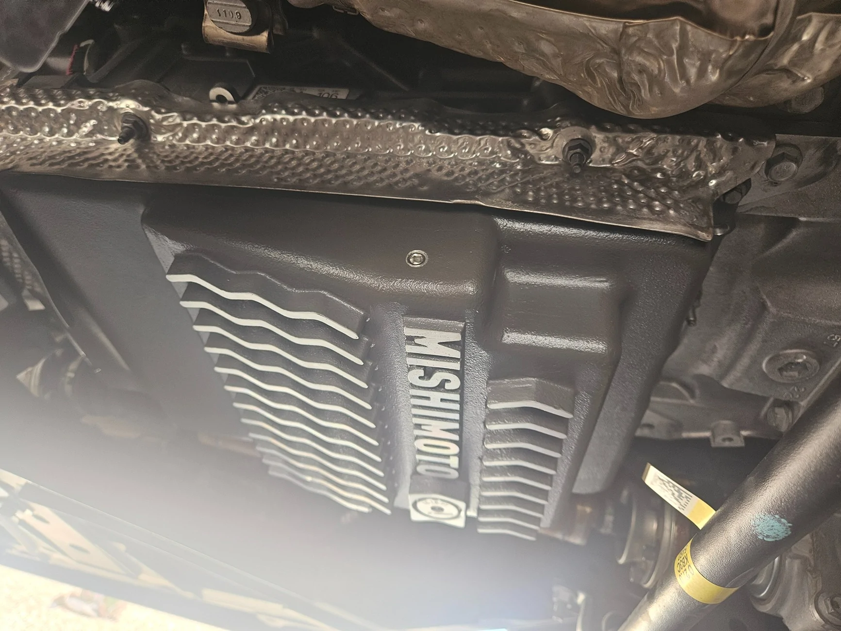

I'm running this pan and agree with the extra fluid amount.
I installed mine a few days before it was due for an oil change and had the dealer check the trans fluid level while I was there. Now I'm on record as them having verified the fluid level in case I have any warranty repairs issues.
