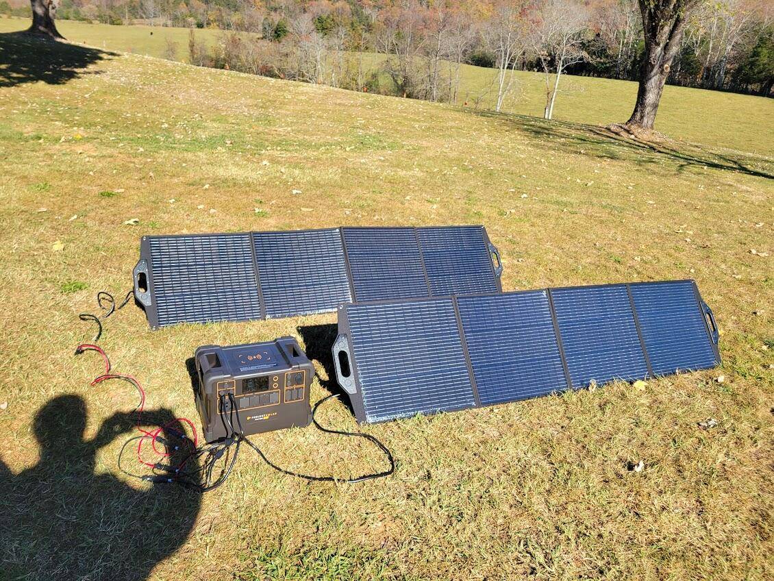

Well it came today. Sorry I am not talking trucks, this part of the forum is not about trucks. I set it up for a dry run so I knew how everything connected and how to aim the panels. The only thing not shown is the included wheeled cart.
I must say, so far I am impressed. The power vs. size, the portability, ease of operation features etc. Right now I have it running my beer fridge downstairs just to get an idea of run time.

Runtime is relatively easy to calculate.. figure out how many watts something runs at and then divide by total watt hours.
Mine had 550wh and my cooler uses 55 max, so if the thing ran all the time it would last 10 hours. Considering a fridge doesn't run all the time though.. i was getting a little over 20 hours before needing to top up.
True story! However, it is not always obvious what an appliance's power consumption is. While my really old beer fridge was running, the generator said the power draw was ~325W. Plus when it was at idle, it showed a draw of 13W. I did not see when the generator reached 0%. I went to bed.
