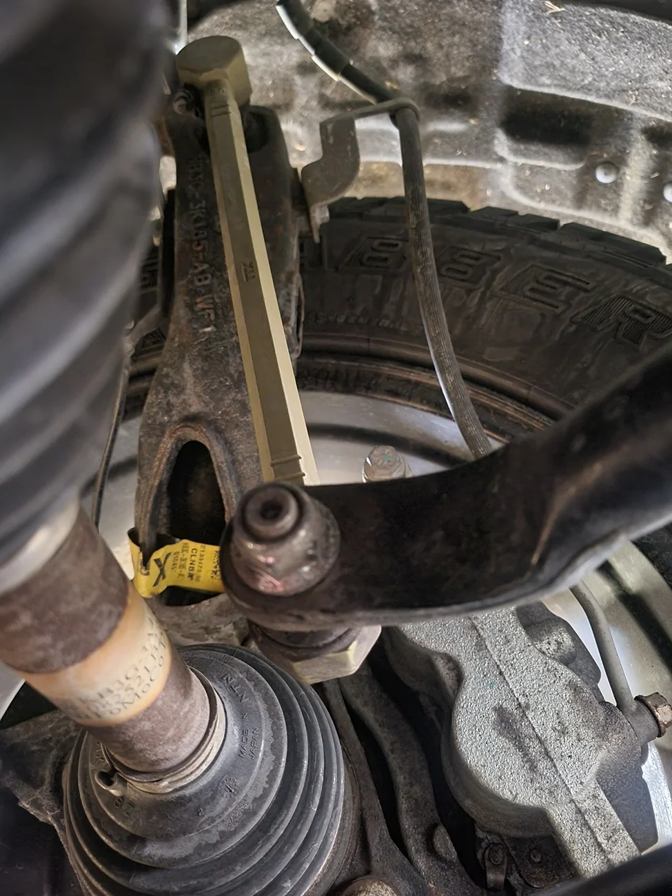

I had a weird clunking/popping that was happening for a while in the front end. I torque checked everything multiple times, even sent it out to 3 different shops to have them disassemble and inspect all the suspension components. Nobody could find anything wrong… Eventually it just went away and never happened again.
