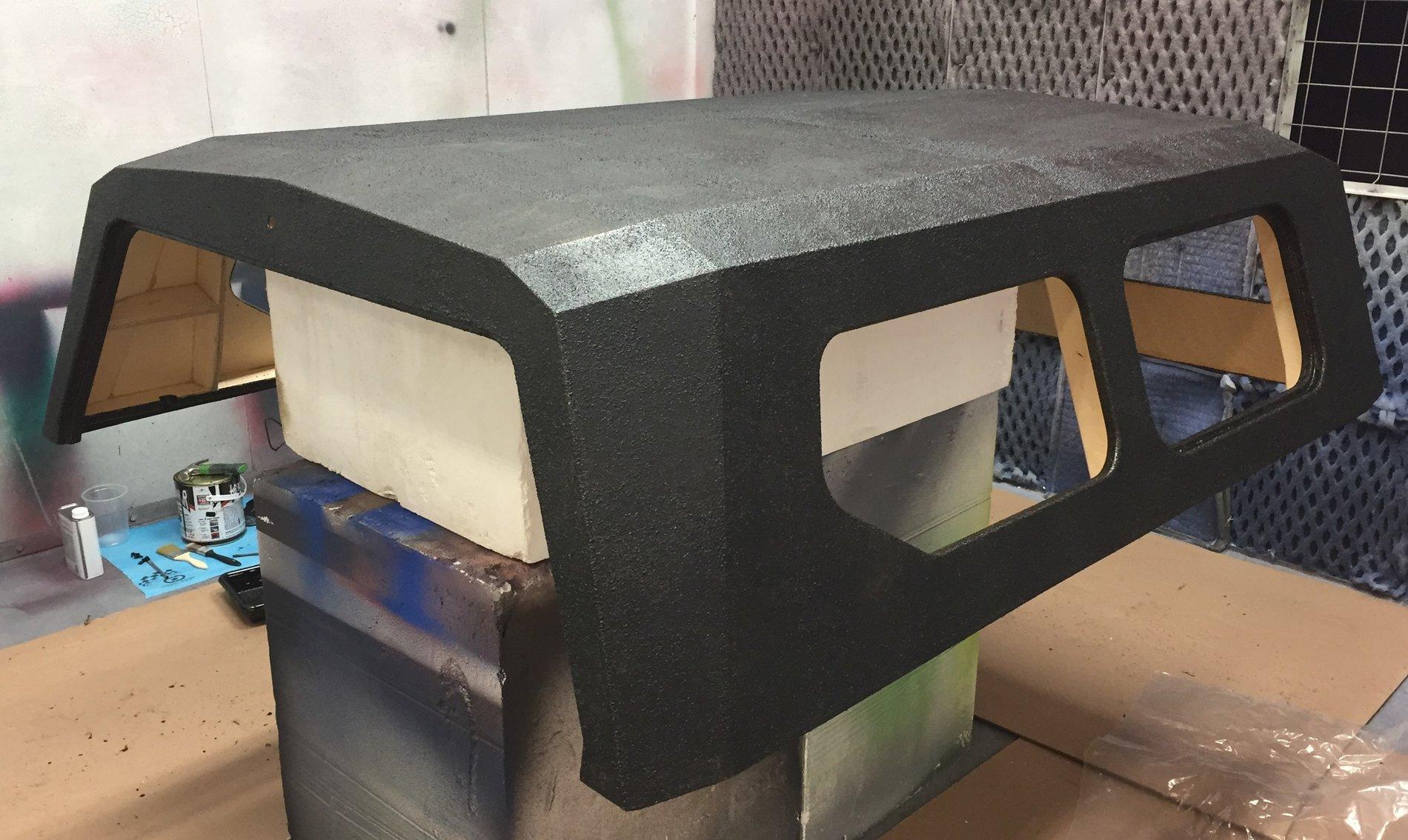

Some more progress recently, the herculiner coating went on, here's the first coat
It's weird stuff to use, quite a bit more gritty then I expected, the particles are quite large and it makes for quite an aggressive texture. Applied (with brush / roller) about 3 coats overall and had about a quart left over, I recommend a fresh roller for each coat - I had a third roller, but it wasn't the same texture and didn't work, so the windows and rear hatch were just done with a paintbrush.

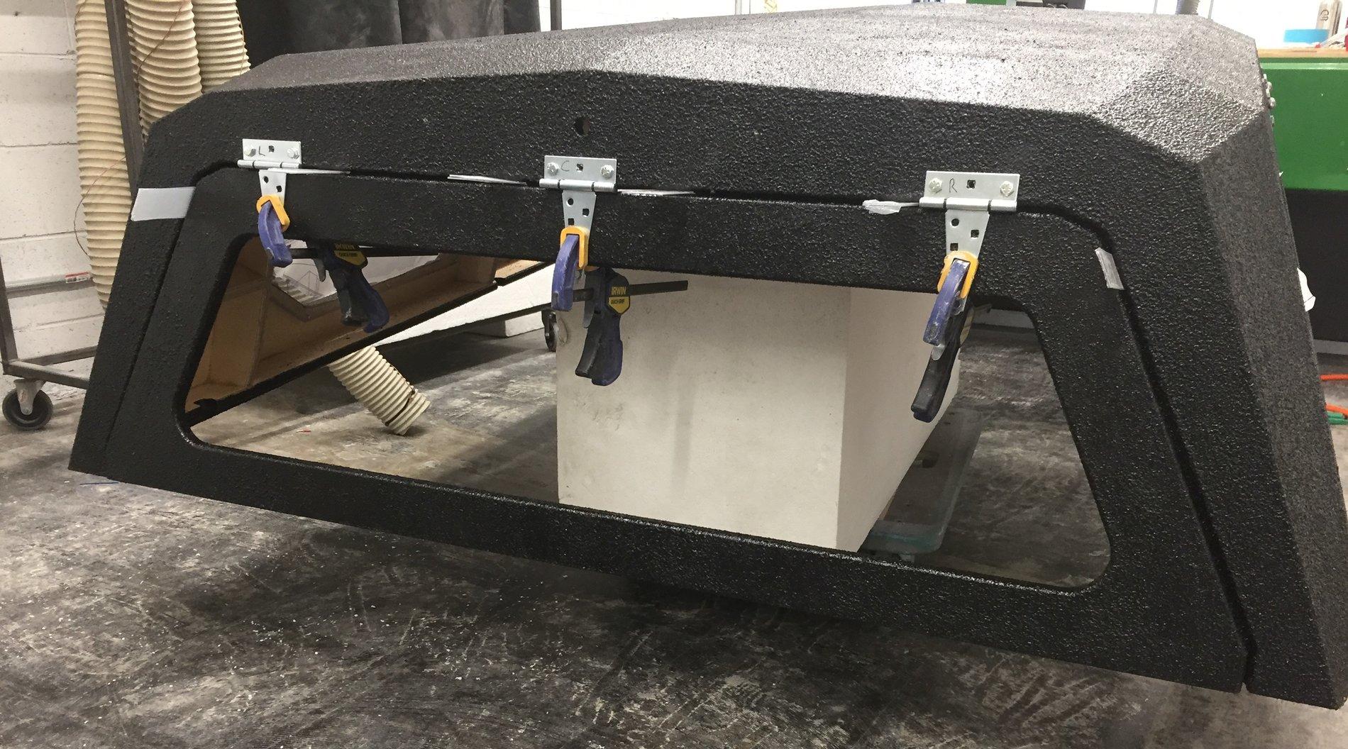

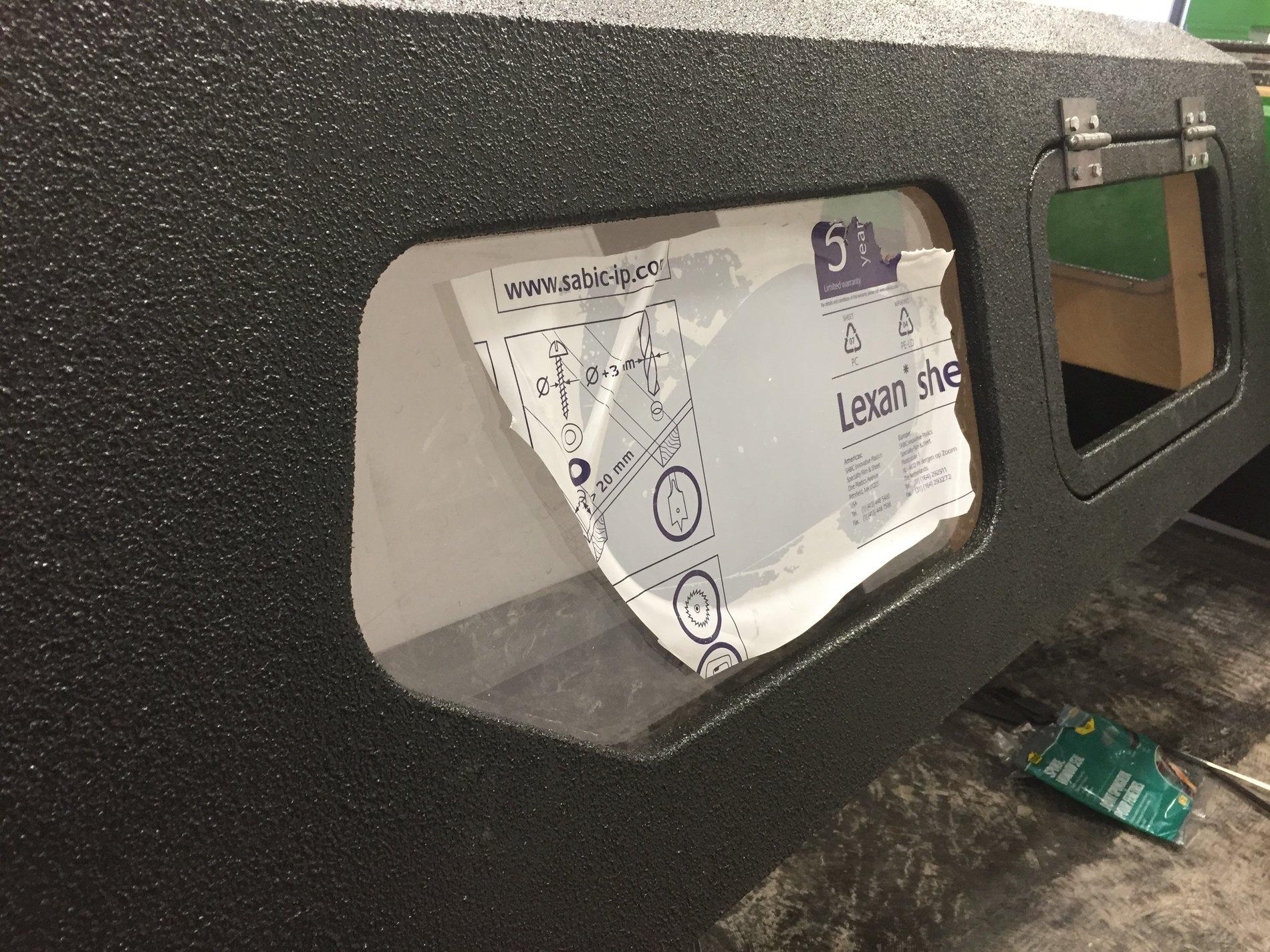

Next up was fitting the hinges and testing the windows
All the hinges were painted and finally installed with carriage bolts and polyurethane adhesive sealant to further seal any places where the coated was penetrated.
