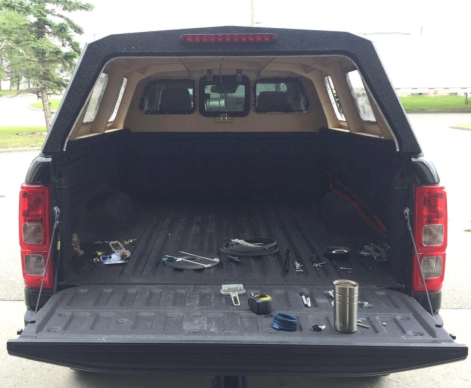

Some more progress recently, the herculiner coating went on, here's the first coat
It's weird stuff to use, quite a bit more gritty then I expected, the particles are quite large and it makes for quite an aggressive texture. Applied (with brush / roller) about 3 coats overall and had about a quart left over, I recommend a fresh roller for each coat - I had a third roller, but it wasn't the same texture and didn't work, so the windows and rear hatch were just done with a paintbrush.

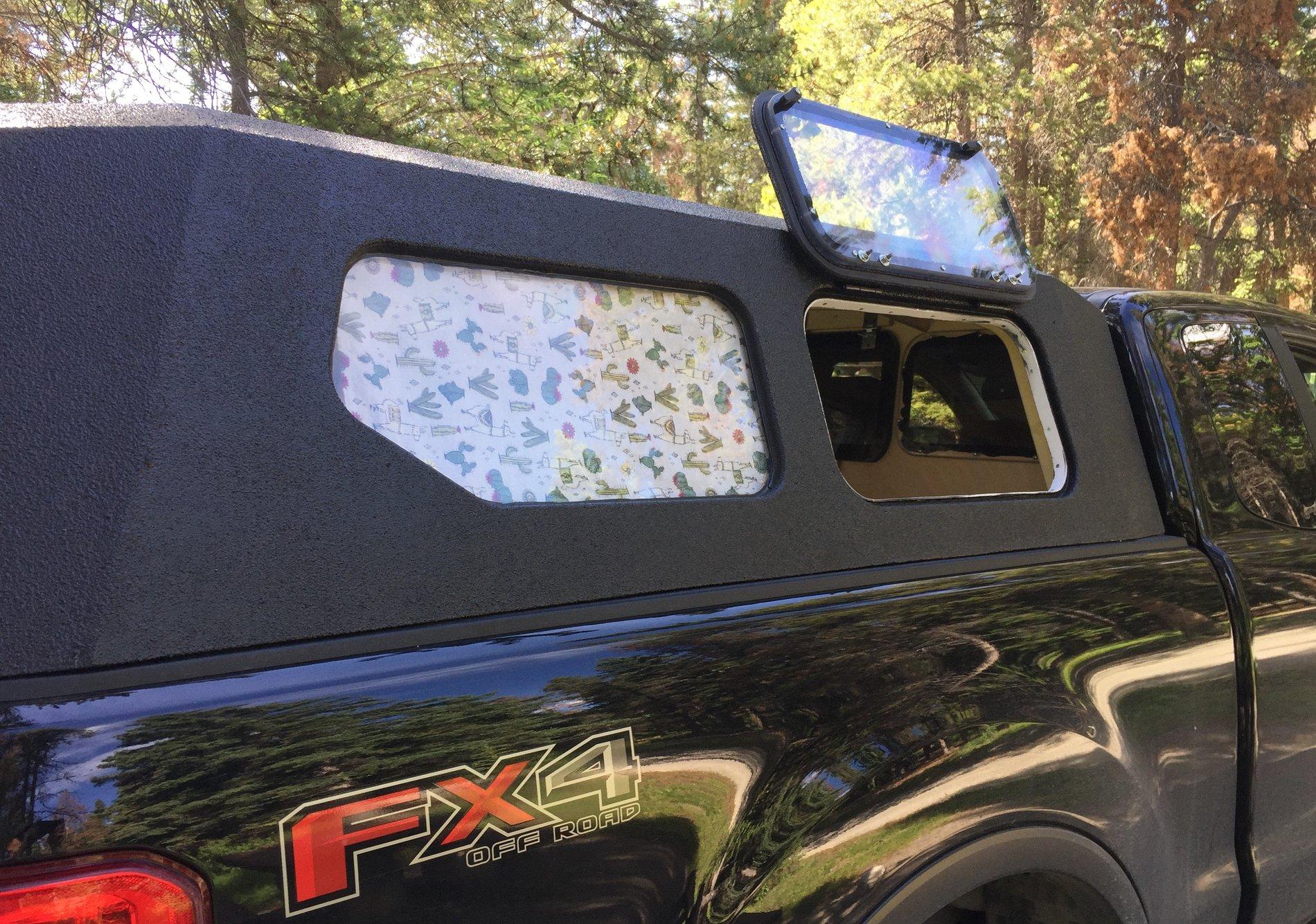

Next up was fitting the hinges and testing the windows
All the hinges were painted and finally installed with carriage bolts and polyurethane adhesive sealant to further seal any places where the coated was penetrated.

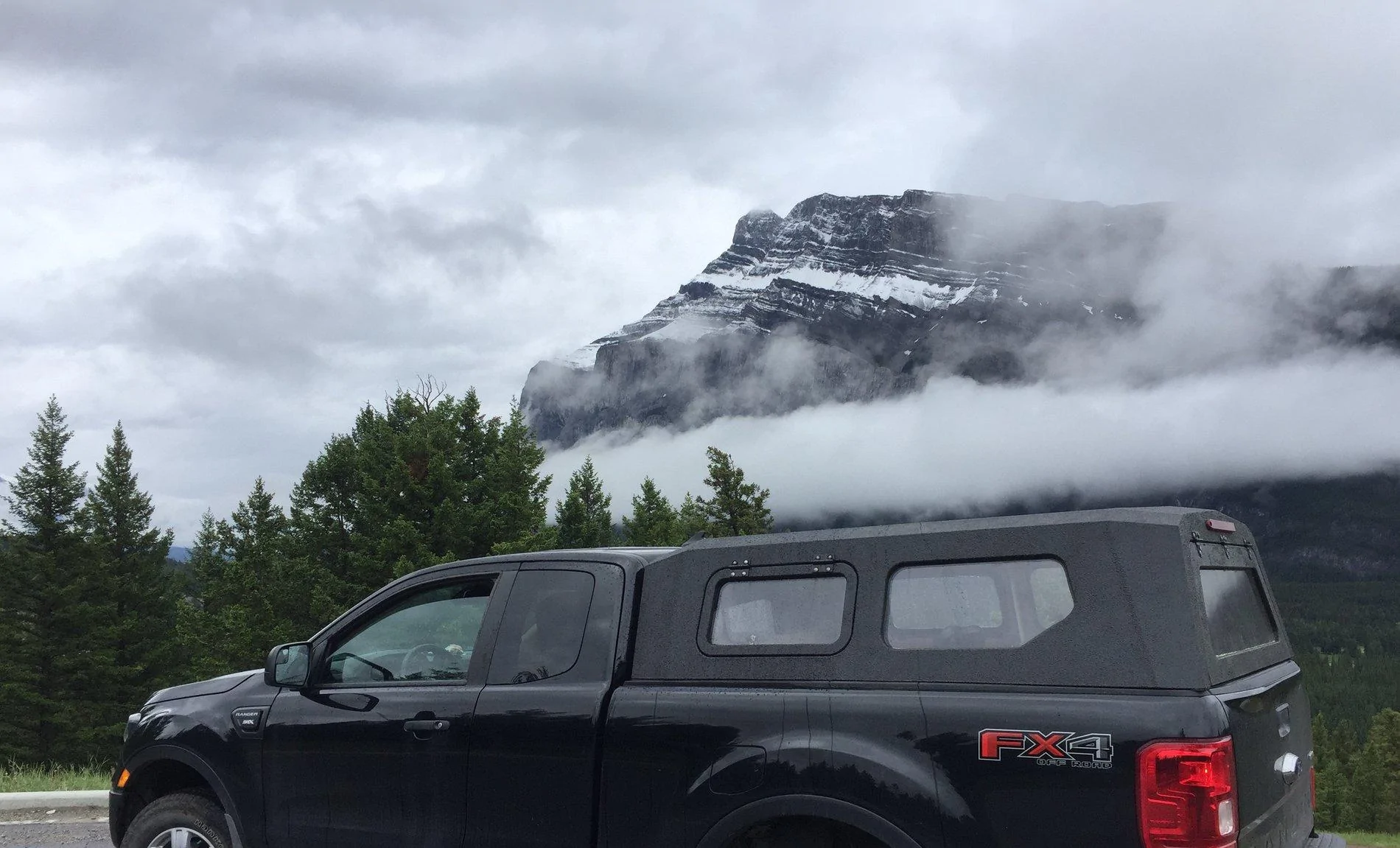

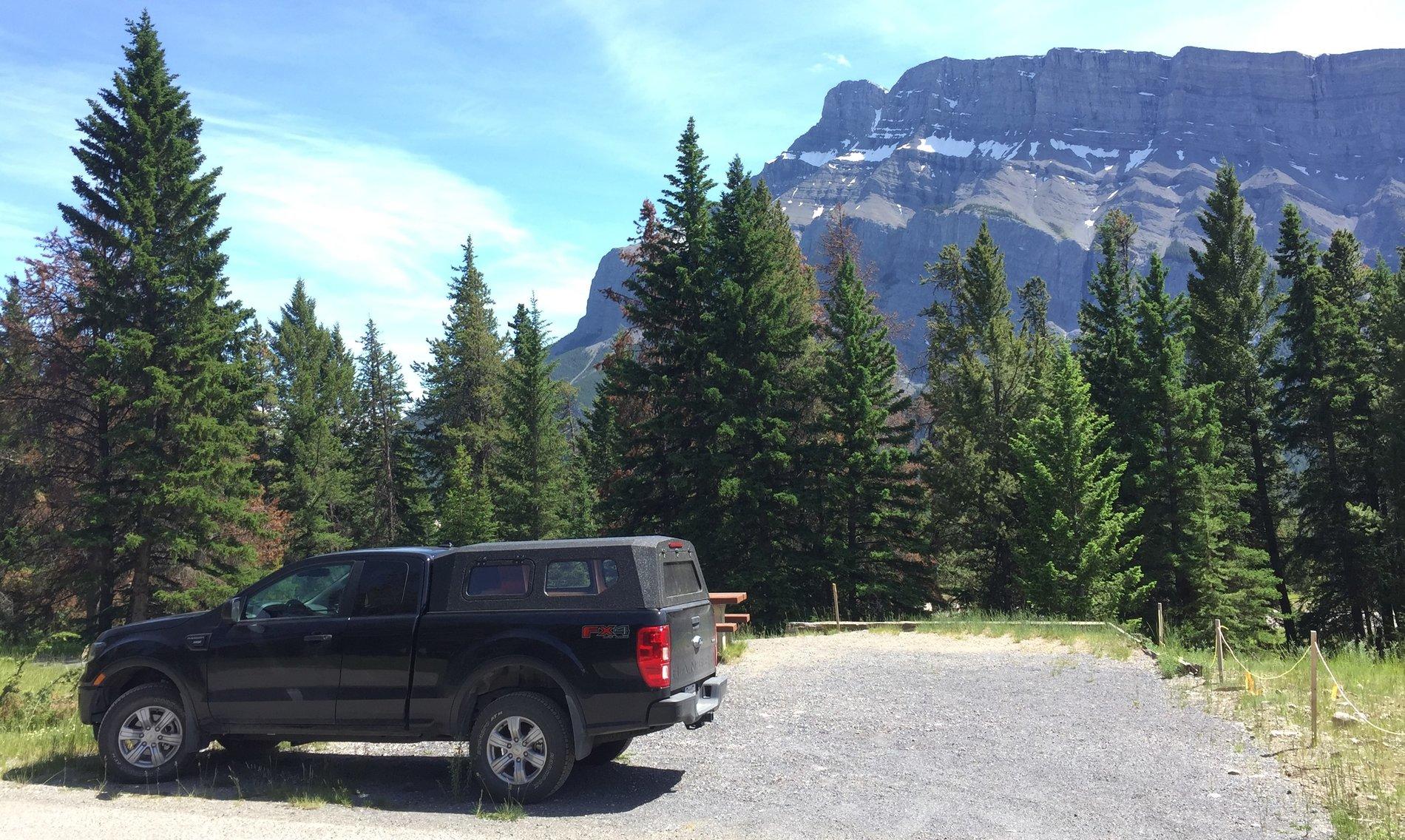

It's mostly done, there's a list of things still to do which include:
- Hook up brake light (I think I should be able to tap into the trailer harness)
- Install gas struts for rear hatch
- Re-do front center window, its not quite finished, but it functions.
- Add some arms to the Windoors to keep them positioned
- Fly screens on the windoors
- T handles on the rear hatch
But its good enough for a test camping trip!
excuse the t-towel for curtains!
So far everything works wonderfully! I am really happy with the results. Time will tell how well it endures the weather, but for now I have a functioning topper! Had some pretty good rain over the weekend and so far no leaks!
Just.....WOW!!!! :like:
