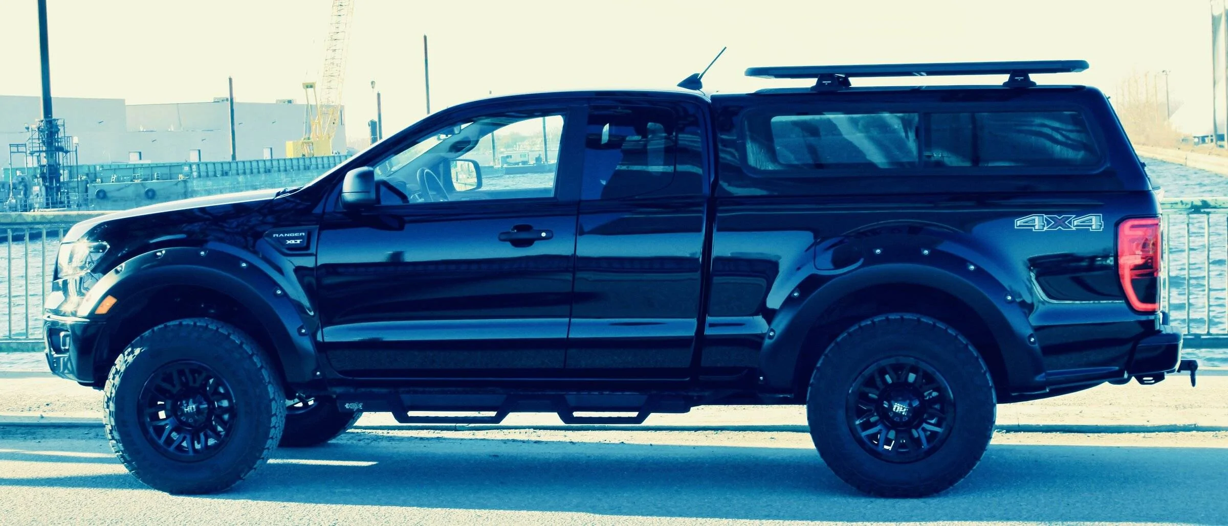

For what it’s worth, I have Rhino Rack legs mounted directly through the roof of my canopy with the Pioneer Platform attached directly to the legs - the platform is built using crossbars as part of the structure. It’s the lowest profile combo I could come up with. If you don’t already have the tracks installed on your canopy, you might consider the same.

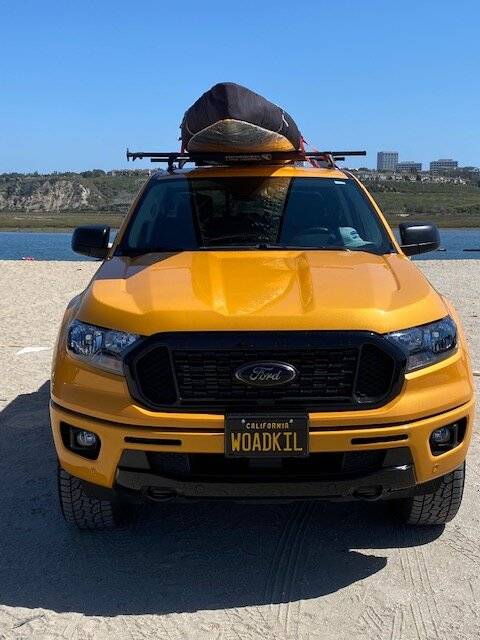

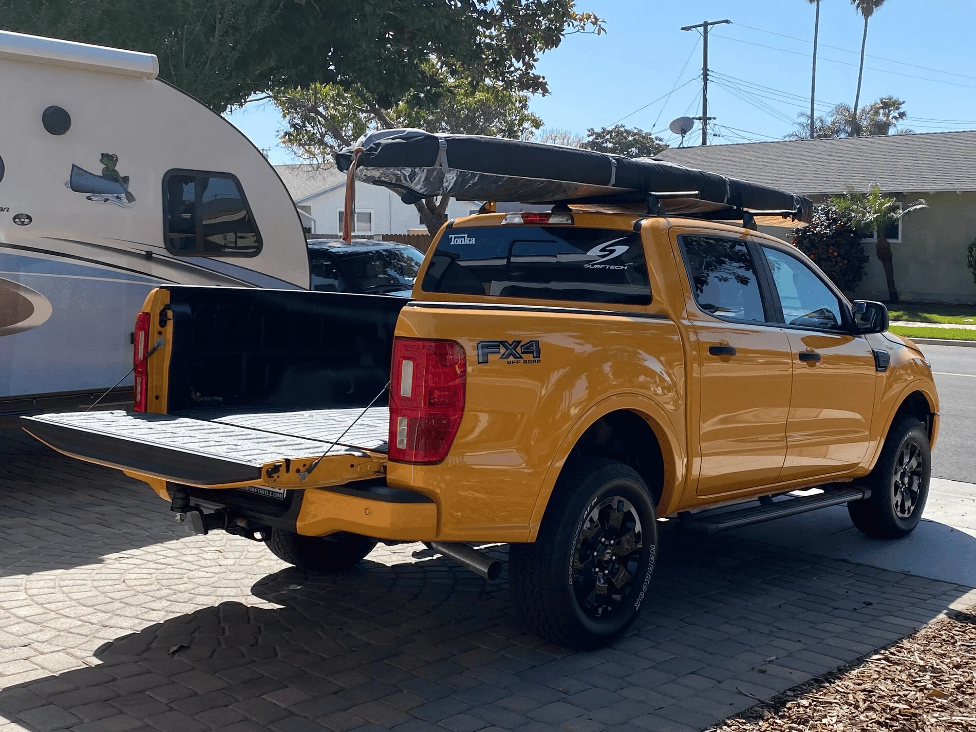

Rada1:
Had it installed by rack shop. Not cheap but same install on my F150 lasted 16 yrs no probs!
They used a blind waterproof threaded insert.
Hauls my yaks and SUPs just fine!
Good luck!
