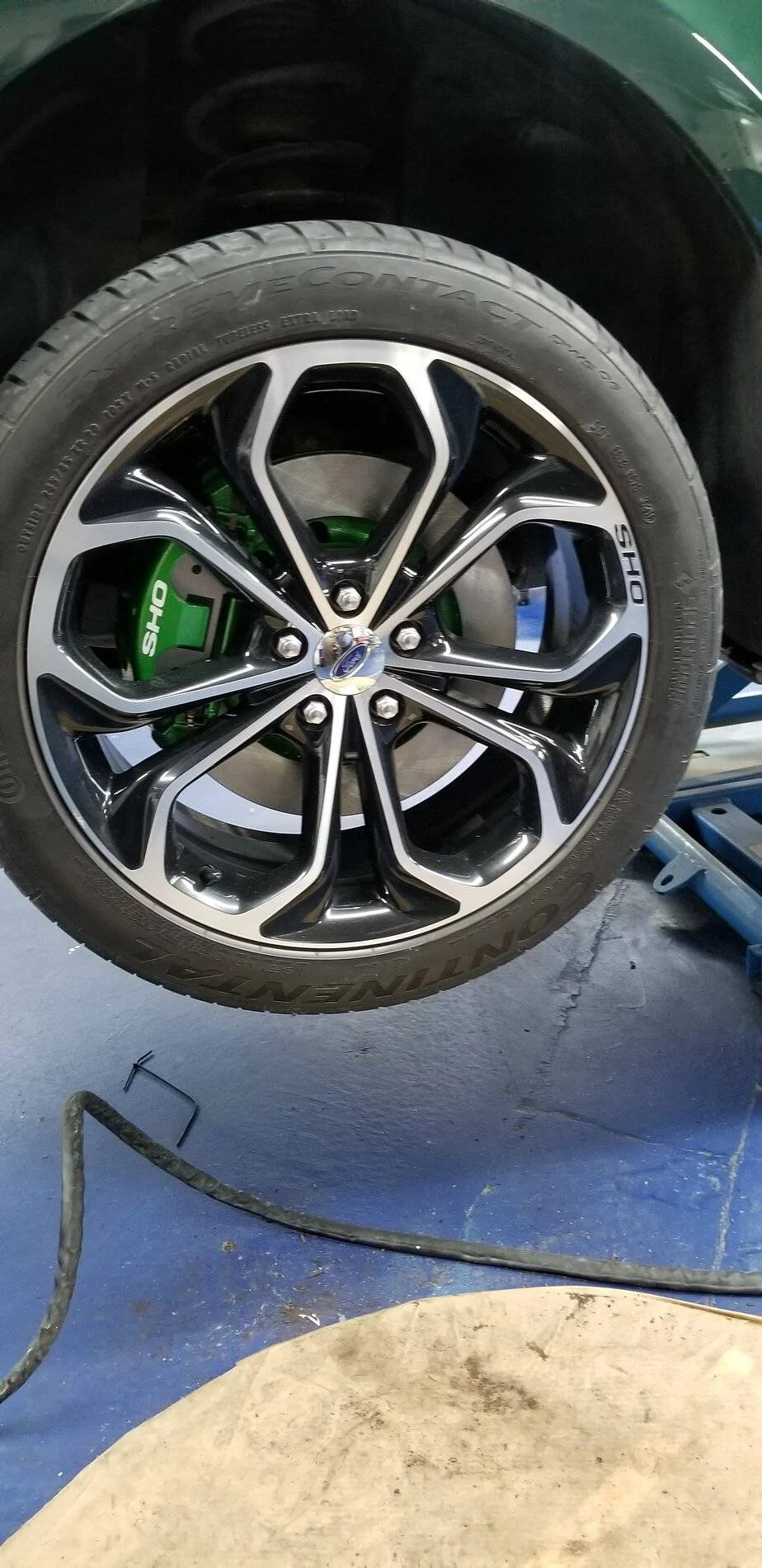

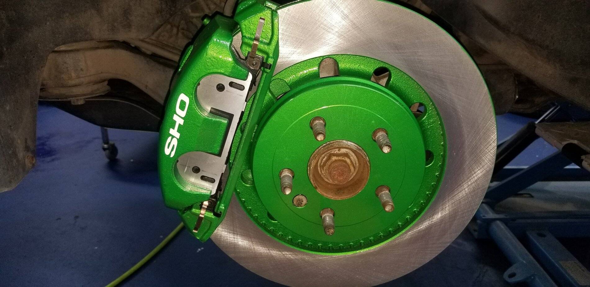

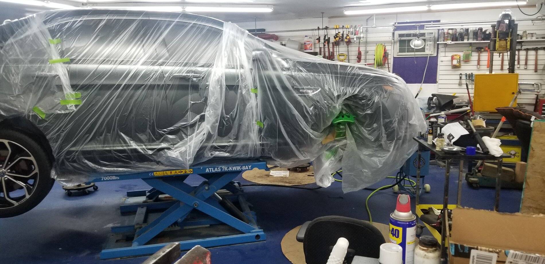

painted many calipers and hats , engine paint works good also have used base coat clear coat color match, never had a heat problem on any of them, some pictures of my SHO when i did them green

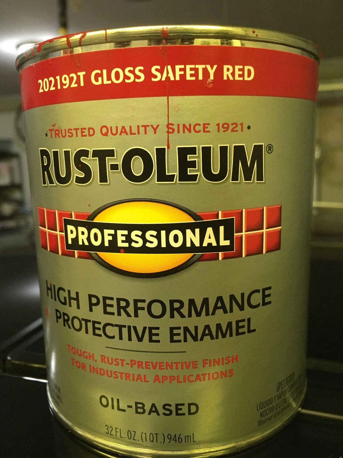

I’m working on painting mine today. Hit it with brake cleaner first then lightly masked anything that looked like it shouldn’t be painted. Used the International Harverster Red industrial acrylic paint you see in one of the pictures. I wanted that specific color which is a deep red and matches my tow hooks. Also has a 10 minute dry time making it easy to sit there and revisit until it looks good. Not too bad on a nice day but definitely took a few hours. I wonder how much more stopping power I will get now that they are red.
