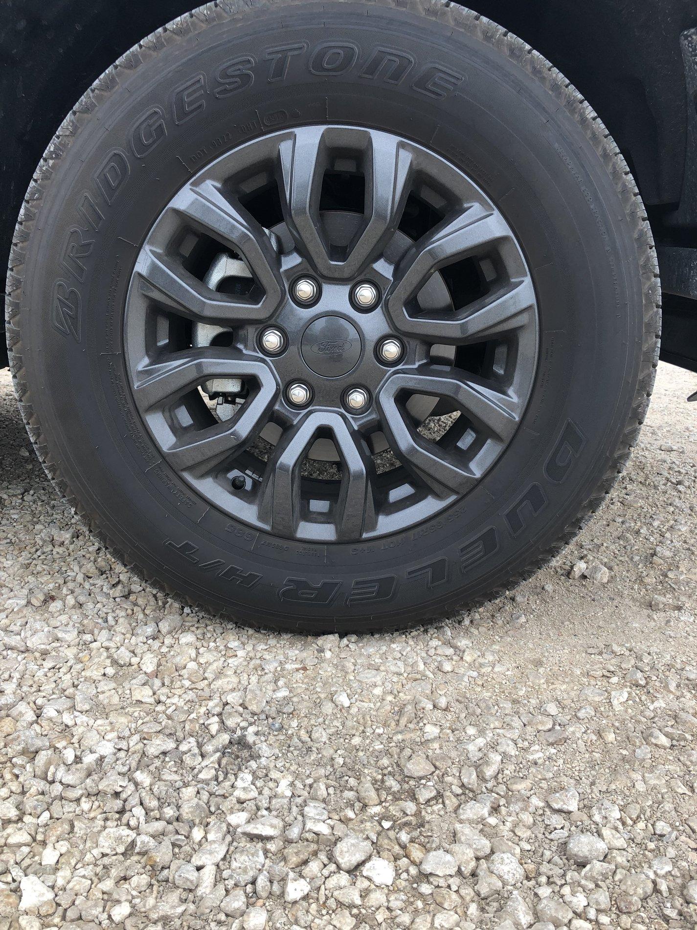

I’m thinking about painting them black, but not committed. Ideas, experience, thoughts ?

They make caliper covers which come in a variety of colors.
They ain't cheap, but they are nice!
On the other hand they already match your paint job.
