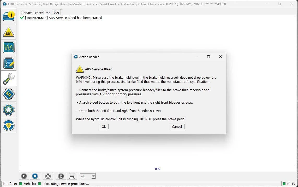

FORScan will allow you to do a bleed like the dealer (we all assume) does. I believe the details are within the FORScan procedure.
Edited, added the screenshot.
