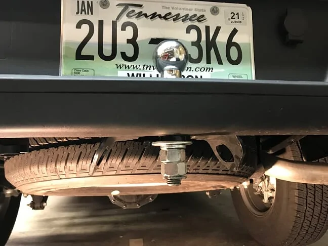

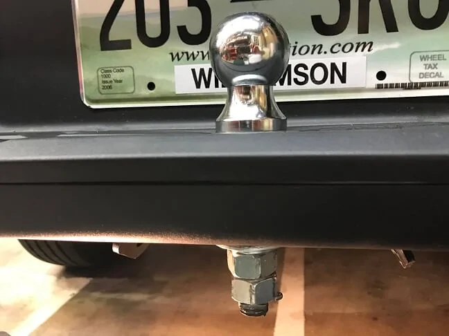

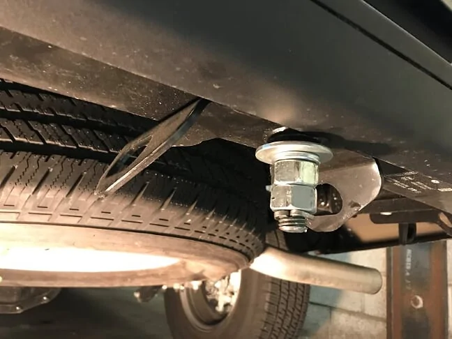

All thread is pretty much a low quality product. Not sure I'd want to use that for such a critical fastener.
Why not just use a good quality bolt and a lock washer? That would also eliminate dragging your nuts in the dirt... so to say. :oops:

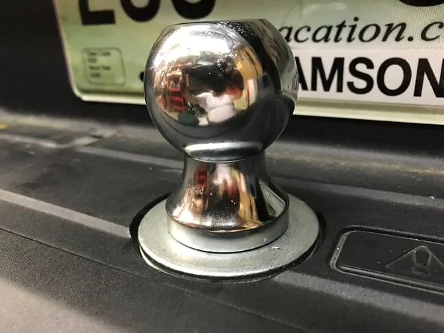

PICTURE#5 FROM UNDERNEITH WITH A FLAT WASHER; LOCK WASHER; 2 JAM NUTS; AND A COTTER PIN TO STO...JPG
forgot thge pics- sorry!!

The truck, equipped with bumper mount for ball has a tonged rating of 350lb max, tow capacity 7500.
The Ranger's bumper cannot support 7500 lbs. That is with the factory receiver hitch or an aftermarket receiver rated for 7500 or more.
350 lbs tongue/3500 lbs total is the limit for bumper pull.
You are absolutely right and I missed it in the owners manual. It is ambiguous and states the truck can tow 7500 pounds and then lower down the page breaks down tongue weight with a percentage. I’ll attach a picture. Again I am standing corrected, the bumper can only support towing 3500 pounds. Thank you for this important clarification I missed.
