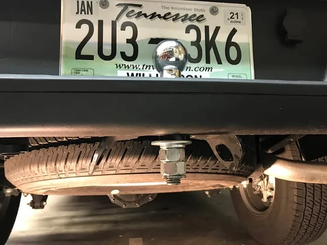

Thanks for everyones input. I decided to go with mounting a receiver. Mostly because the tongue weight limitation on the step bumper ball is 350 lbs and I didn't want to have to always be concerned about that. Another reason I did not do the step bumper ball was the attached picture from another thread listed below this thread (attached) that made the installation of the step bumper ball just too ugly. Thanks to everyone.
But that one does have a loooong shank and 2 nuts and a ball on top !!!
