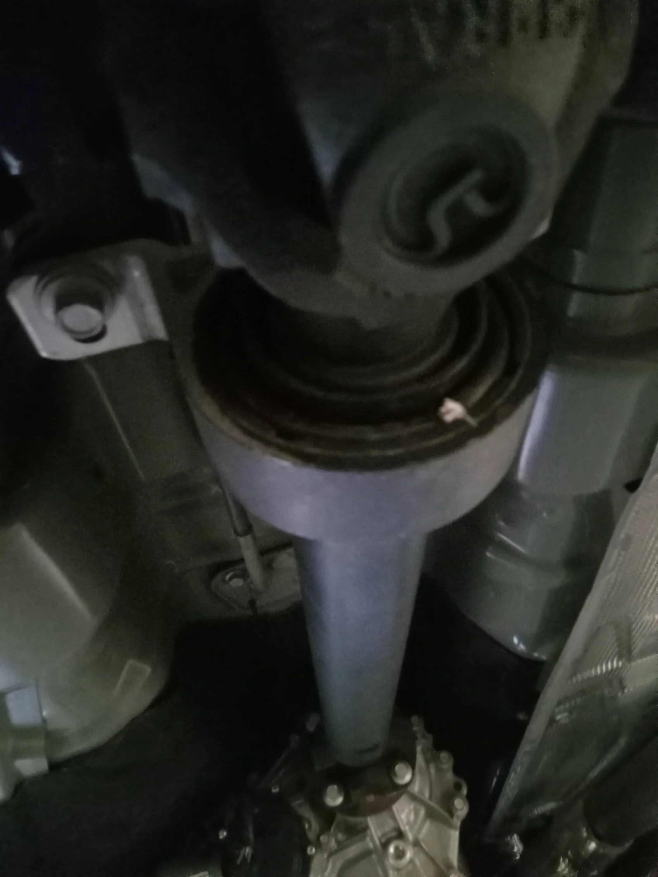

I want to "test pack" it with something to see if it makes a difference before i do anything messy , or take it off , what could go wrong ???

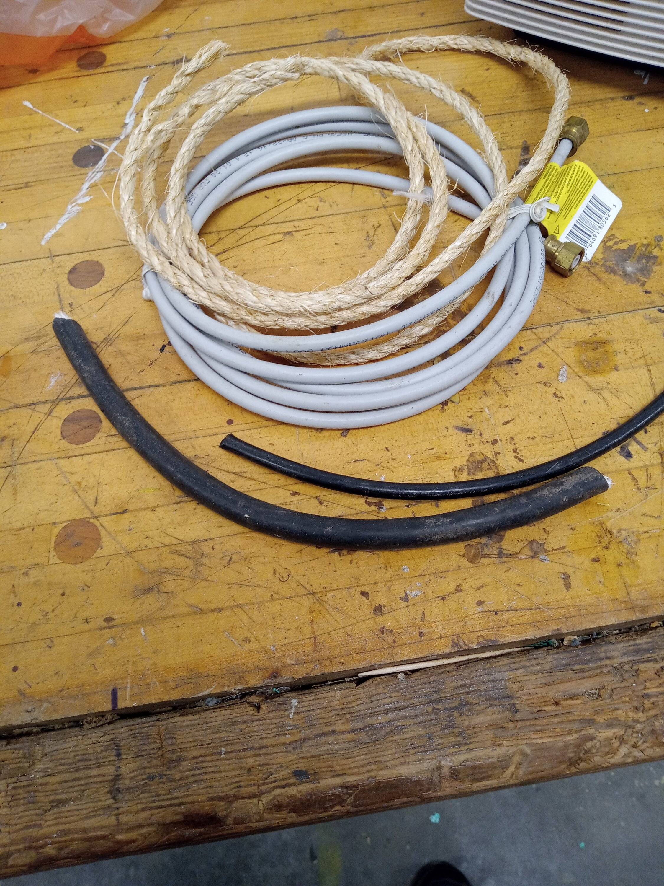

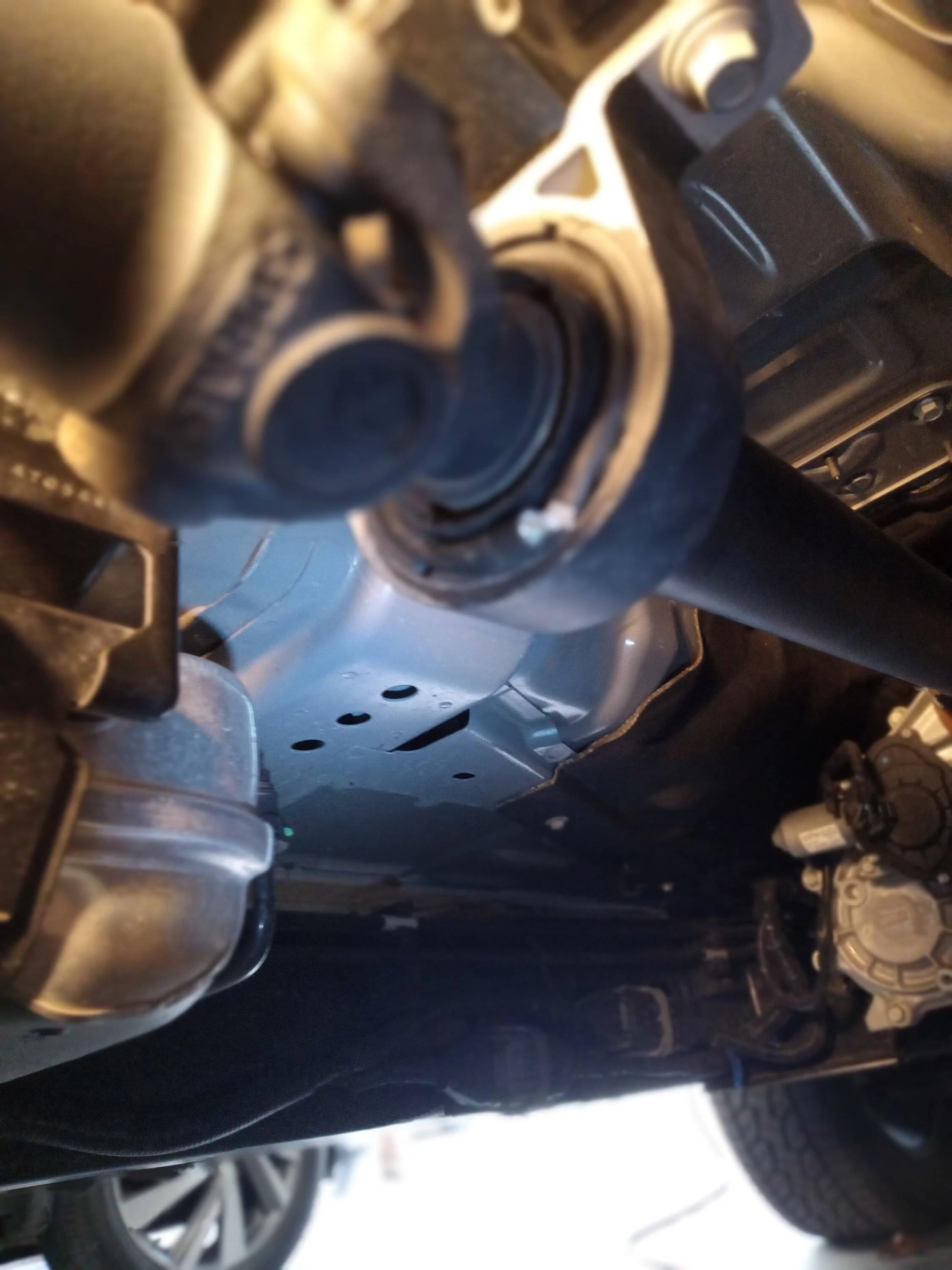

WV redneck rules require I try something from the junk pile first ... the rope was 1st choice but thought might come out and do the wrap , I went with the large black electric cord ,it was slightly to big so I pulled one wire out and tap tap tap...
it's seated in pretty far now and it has almost ZERO play , can't move it at all really ... going for a test drive and if I dont update , well , things went horribly wrong and " Phil was right" can go on my tombstone...
Haha, well I agree then. Rules are rules, best we abide.

Ok , just got back from a "sprited run", feels like it's gone to me , mine was not bad but noticeable on acceleration and 75 to 85 , I feel nothing at those speeds now , but thought maybe a slight something at 40ish , I think I'm going to switch it out for some rubber hose or solid core from work , but I just crawled back under there and it didn't move any , shaft still has no play and is solid mount...

Disclaimer: I am not recommending anybody lay under their truck and drive an electric cord around their driveshaft ... did I make a magnet though ? ? metal spinning, copper wire , or a generator maybe ? either way , lots less shudder , mudder fudders... hahhahah , I celebrated a little , feeling it... don't hate me , too much anyway...

Just got to work and did a nice, normal drive all the way here , everything seems good , great even, and it's too early to tell for sure but my clunk coming up on stoplights seems to be missing , and just to see, I actually put it in "D" for a while, which I never do because of the low RPMs and the "lug" when it drops below 1500 , and it feels WAY better in that situation, but I still hate low RPMs(in this truck ) so that's a non-issue for me ...
Still going to take the cord back out and replace with something that flexes a little and retest , it has 0 flex right now , which concerns me a little since it had so much before ,
