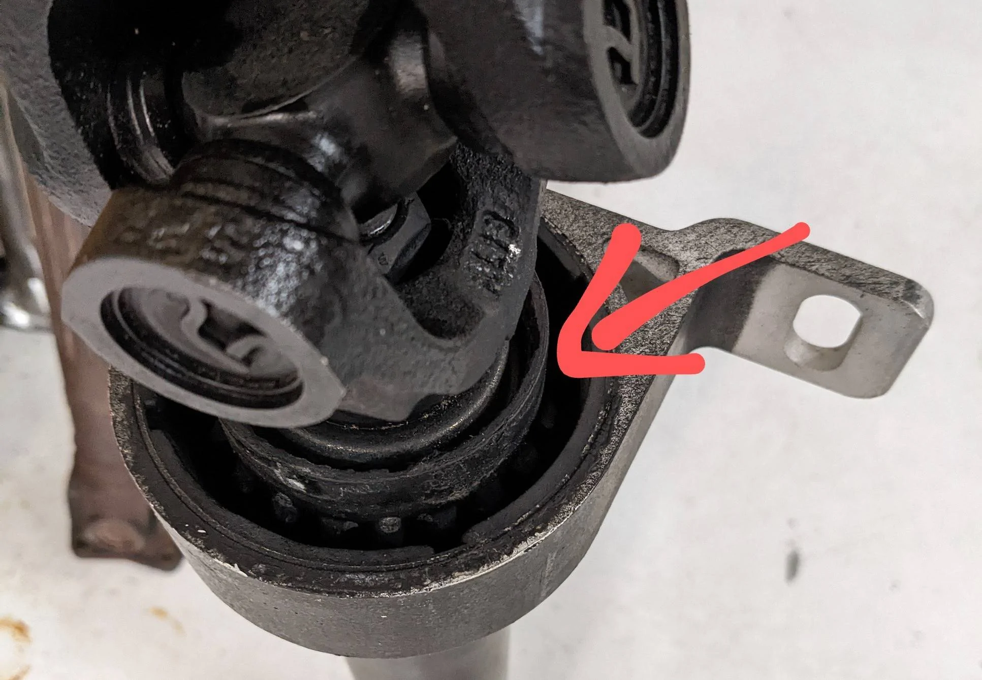

Here's an idea:
Who of you with a shuddering drive shaft wants to be a brave pioneer and try pouring polyurethane into your carrier bearing bushing? The stock shaft I have here as a sample has a big cavity on one side of it. I think you could pour polyurethane into this cavity to make a hybrid poly/rubber bearing mount. This would certainly limit how much that center bearing is able to bang around. But the "chicken or the egg" question comes up again. Will this keep the shaft from shuddering or will it simply absorb and dampen less of that shudder and transmit more of it through the vehicle? Dunno, only one way to find out! One of you guys who recently got a one piece shaft would be a perfect candidate to test this out. If you ruin your stock shaft there's not much of a loss since you've already replaced it. Also, you have already established that your stock shaft is one of the ones that has this shudder issue.
I know diddly squat about urethane and bushing materials so I don't know what mixture is ideal for this but just as an example, here's this. https://www.mscdirect.com/product/details/66746751
If this works out for people, since I am bringing the idea forward, I'll split the $3,000 bounty ($1,500) with whoever takes it to a successful and repeatable (10X) conclusion from here. :wink: And if it proves itself to be a good solution I'll link it on our website as an alternative to the shaft we offer, but maybe not discontinue the shaft as this seems like it would be, best case scenario, a very DIY thing that not everyone would want nor have the ability to undertake. Then again, this might make no difference or might even make things worse.

@Shawn at Tom Wood's
you have a pretty good look at it , does it look like I could drive/wedge something around it? A small rubber vacuum hose perhaps ? Hate to fill it with goop that I can't get out ...
