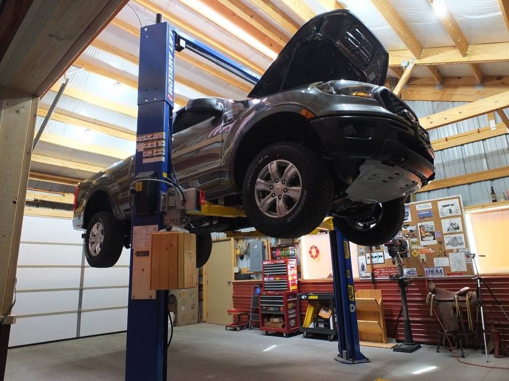

I already have the mod for easy oil changes...
Nice! Too bad not all of use can afford that or have the garages to put it in. Would make tire rotations a snap.
