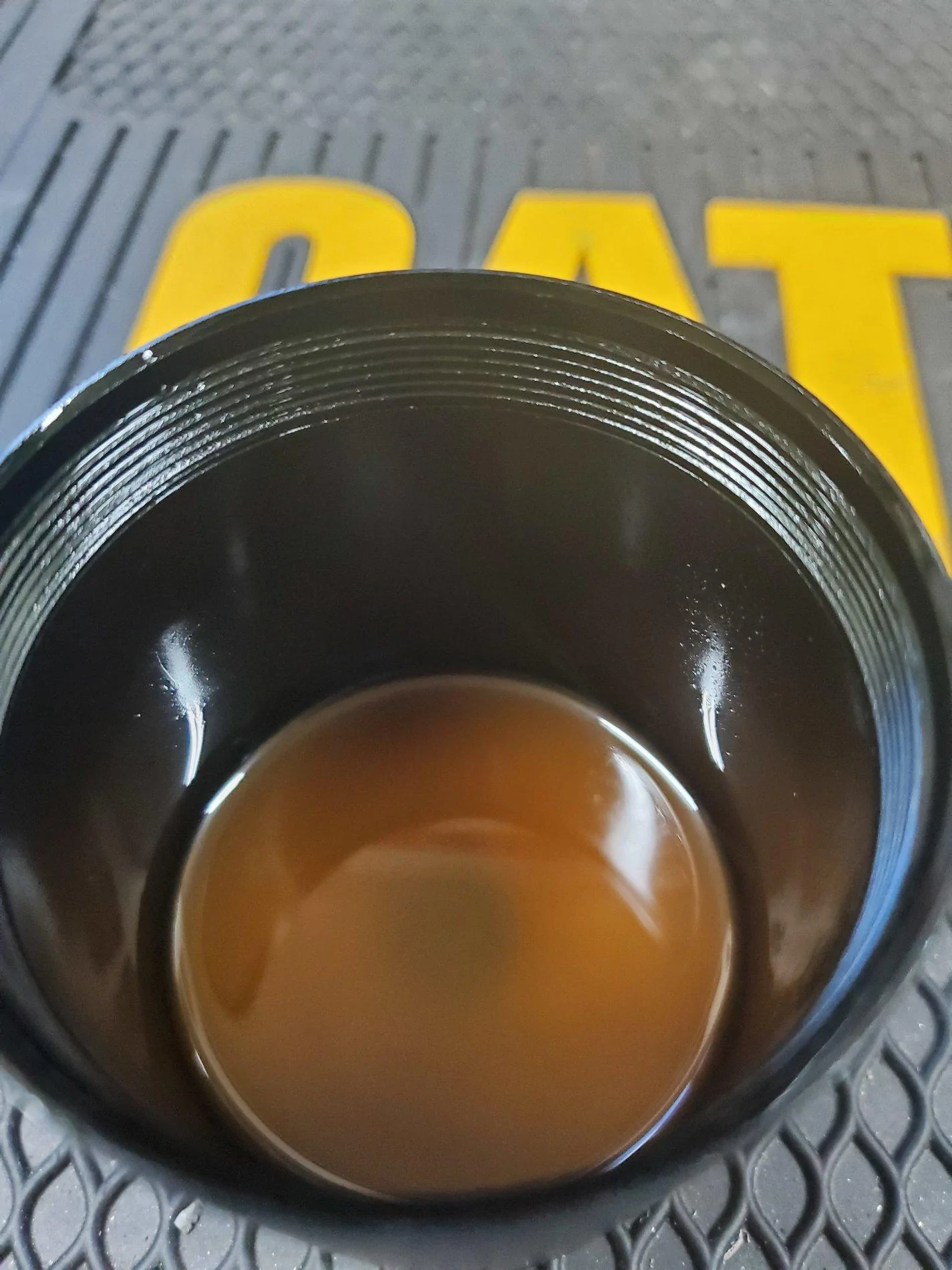

250 miles, 90% fuel 10% oil using the paper towel method. Sort of accredit using the can to help build up not accumulating elsewhere, like the aftercooler. Surely don't care for the idea of it returning to the crankcase. Worthy in my opinion.
is it going to the crank case or being ignited ?.if the catch cans job is to stop it from collecting on the back side of the intake valve its going to get burned no? is the catch can before or after the stock separator?
You are totally correct pretty much straight into the intake.... so why not put something in place to to capture what you can? (that's a pun for fun "can"). Or just let it pollute your engine intake stream? We all have options, I opt to not let my engine digest this muck. "The real test" for all the critic's, stick a nox / co / voc's analyzer in the exhaust stream (pre catalysis) be interesting to see the results, can verses no can?

your are right about about a lot of muck for sure!but lets say ford in all their wisdom cheated and uses this muck to wash the valve ? (I am not even close to being a mechanic but the fuel amount they are catching is suspect no?)
Where does everyone get that that's fuel? I've had mine since 1700 miles. Even after I tied into the breather side I never had anything but oil until it became much colder. I now gets tons of condensation asking with the same amount of oil mixed in.
