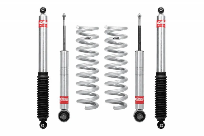

I installed the Eibach PRO-TRUCK LIFT SYSTEM (Stage 1) and a 1" block in back, and am very pleased with it. I have 25k miles on it so far.
Off road it is phenomenal. Its not the plushest ride on-road. I also tow heavy (something I wasn't anticipating when I decided to lift and go bigger tires) and I've been happy with the performance there as well. It is way, way, way better than the stock suspension.
I also have 285/70/17 Nitto Ridge Grapplers that are amazing in every way except, maybe wear. At 25k miles they are down to 5mm. This may be because of my towing and I bought the P tire instead of the LT tire to try and save weight before I knew I was going to tow so much. While the P tire and the LT load range C tire have the same load rating, perhaps the LT tire would have worn better from the towing I do. I'll be buying new tires before hunting season starts. I'll be getting LT tires this time. I really want to get Ridge Grapplers again, but their LT's are heavy. IDK.
I lost about 1.5 mpg on average from the lift and larger tires.

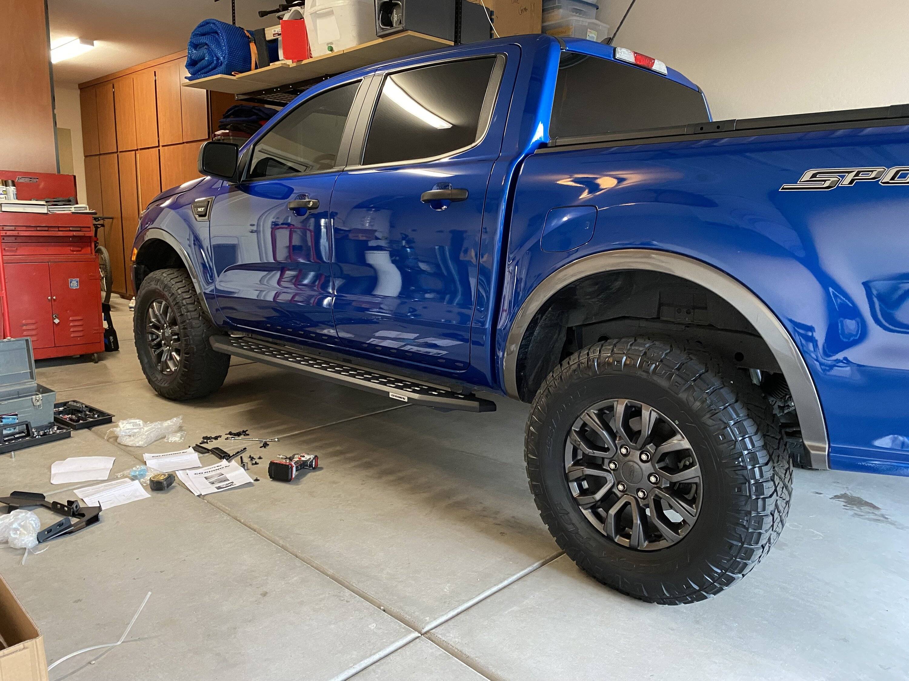

I also installed in the extra clearance crash bars.

how much of a pain in the aft end were the aftermarket crash bars to install??
Perhaps I was misleading with the wording of my post. "I" didn't do the actual install of the suspension or the crash bars. My participation was limited to sliding a piece of plastic into a black box and signing.
So to answer your question, it was pretty easy for me.
I did install the running boards in the pic though. That was pretty easy accept they sent the wrong instructions in the box, which, it turns out, you don't need anyway.

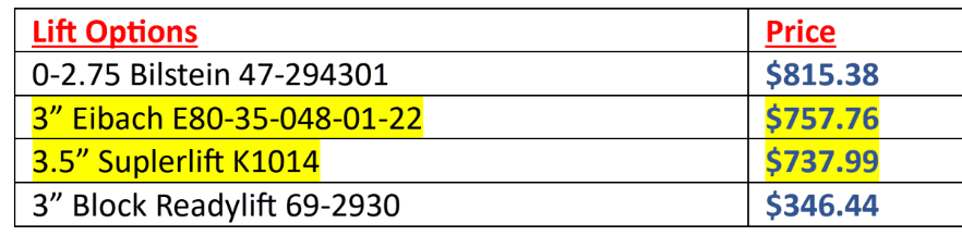

Ok Ranger gurus,
I'll apologize off the bat for a question that has countless posts and discussions already throughout this forum.
I've read some, definitely not all. But am going to ask anyhow.
Preparing to upgrade suspension/wheels/tires on 2020 Ranger FX4 w 37k miles.
Use of truck - daily driver, mostly on road, some light off roading (forest service roads, etc.).
Minimal towing. We do a lot of camping and head out to woods frequently. Also head to areas with snow.
I really like the look of the rangers I've seen here w/ 2'-3.5" lifts, slightly offset wheels, and running 285s.
I am thinking:
Fuel Shok 17x9 +20offset
Nitto Exo Grappler 285/70-17
But suspension?
Got the following from my local shop (highlighted is what they are recommending - and I think a few folks on forum have the Eibach pro...):
Asked about Old Man Emu - was told they are "overpriced for what they are."
Yes, I want a suspension lift and not just leveling/block kits - hoping to get away from washy soft FX4 suspension...
Thoughts? Suggestions? Opinions?
Thanks in advance.
BCS Lift Shackles (SUPER SOLID) in rear w/ longer rear shocks. This raises the rear 1". Icon Extended Travel 2.5" C/O's up front. Will need new Upper Control Arms. BDS has those too (as does Icon) . BTW - tall blocks suck. You will die from Axle wrap / wheel hop. 3" Block lift in rear will make rake unless you lift the front end a TON.
PS you can cobble together a block lift MUCH Cheaper than the REadylift kit. Perch for springs is 5.75" x 2.5" . These (4 U-Bolts) $40 should fit 2" lift: https://www.roughcountry.com/u-bolt-kit-7602.html 9/16" X 2.5" W X 9.5" L Square, E-coated black, Corrosion resistant, Includes nuts and washers.
2" Billet Aluminum blocks $28/Pair(I think) WILL FIT RANGER. https://www.extremeterrain.com/tund...|Store Brand&T5_Var4=TU29358#customer_q_and_a

Installing the aftermarket crash bars is easy. Getting the stock ones out ? PITA!

I've had the Eibach Pro 2.0 kit. Its a fantastic kit, until you add a bunch of weight. They have a 550 lb spring and adding a bumper/winch causes it to be undersprung.
I swapped out to the OME kit. Anyone who says they are overpriced for what they are, hasn't used them. There are 2 OME kits: Nitrocharger and BP51. Neither is overpriced, but the Nitrocharger is really nicely priced. They have a 605 lb spring, which handles the bumper/winch much better. Reach out to Frank at @Stage3Motorsports for the best deal no matter which direction you go.
