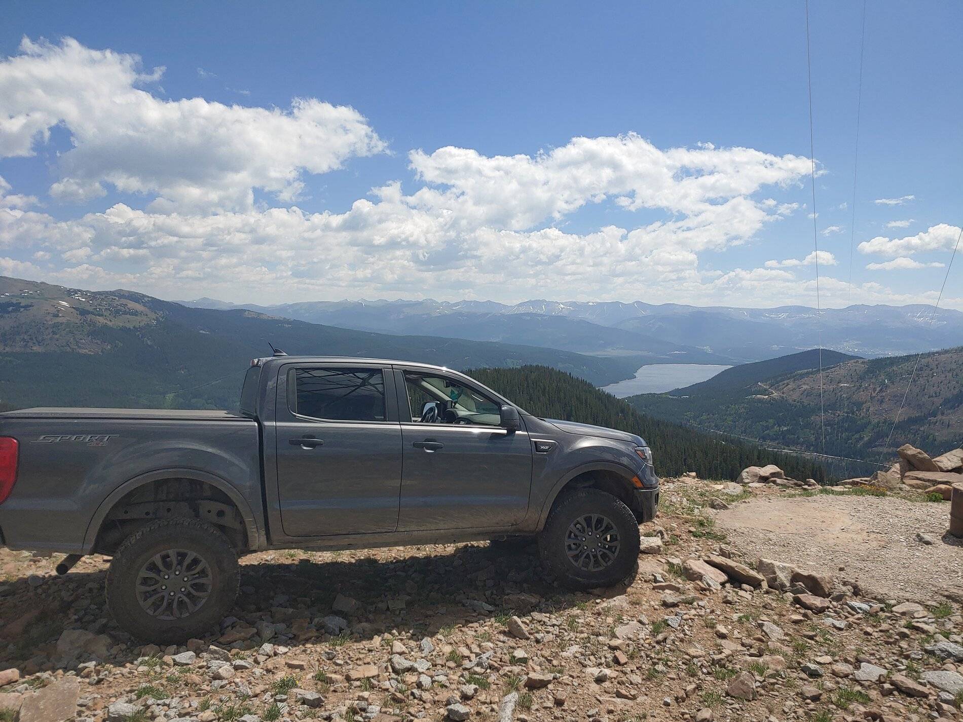

So I do understand that you want to go Overlanding and that is perfectly fine. If you wanted to go rock crawling you probably would have boughr a different vehicle.
With that said i would suggest not buying a leveling kit vut instead a lift kit. What lift kit in particular? The Old Man EMU lift kit.
Why that lift kit? Well to begin with it is originally designed for those wanting to go trail rideing or Overlanding. It is also designed well enough that pavement isnt a problem either.
What all do you get? Well if you start with the basic level stuff you get all 4 shocks, new coils up front and new leafs in the rear. They also have a heavy load kit designed for constant heavy loads if that is what you plan do have in the truck.
Now they do have a more expensive option and that is the BP-51 amd I myself plan to upgrade to it eventually but it is out of the price range you are wanting to start with.
Now you might be wondering why i am recommending that kit over others. Well I decided to put it on my truck and so far have roughly 28,000 miles on the kit. In tgose miles I have yet to have a problem. The ride quality is nice both on and offroad. You get more suspension travel in both the front and rear. And if you decide to load the rear you dont have the rear of the truck sitting lower than the front like you would get with a leveling kit.
Now the big question. Can you fit 285/70-17 with no major problems with this kit? Yes and no. Why? Well it depends if you want to keep the factory wheels or not..... And what tire you get because unfortunately not all tires in the same size are the same size. If you keep the stock wheels I can promise that the Firestone Destination XT in that size will fit. What did I do with the crash bars? I removed the plastic covers and pushed tue front crash bars forward as much as they would go. Do I rub at all? I do but only at full lock on the sway bar and that does not bother me enough to worry.
How is the overall clearance with this combination? Pretty well I'd say. I have been offroad on plenty of trails and to say the least I feel it is just right for the Ranger. There are still some spots that are challenging due to how the terrain is but that can be expected no matter where you go.

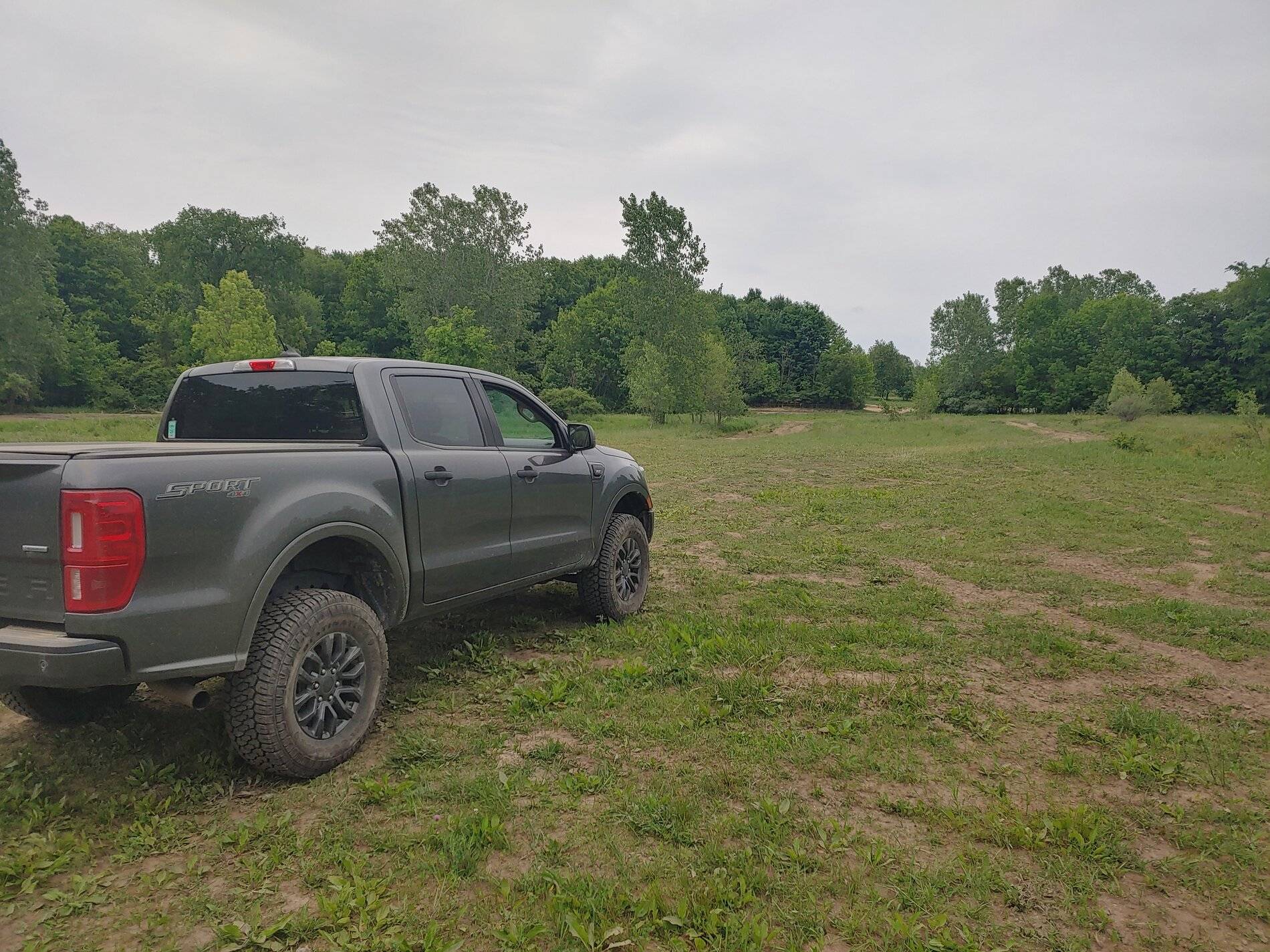

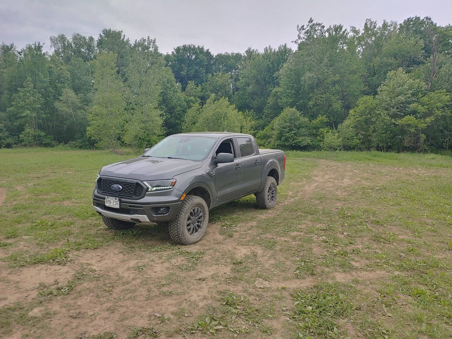

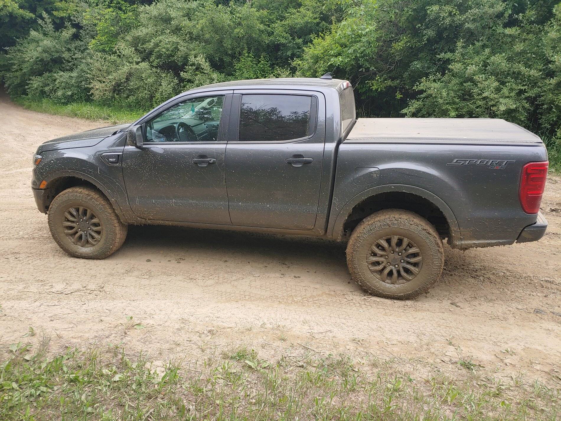

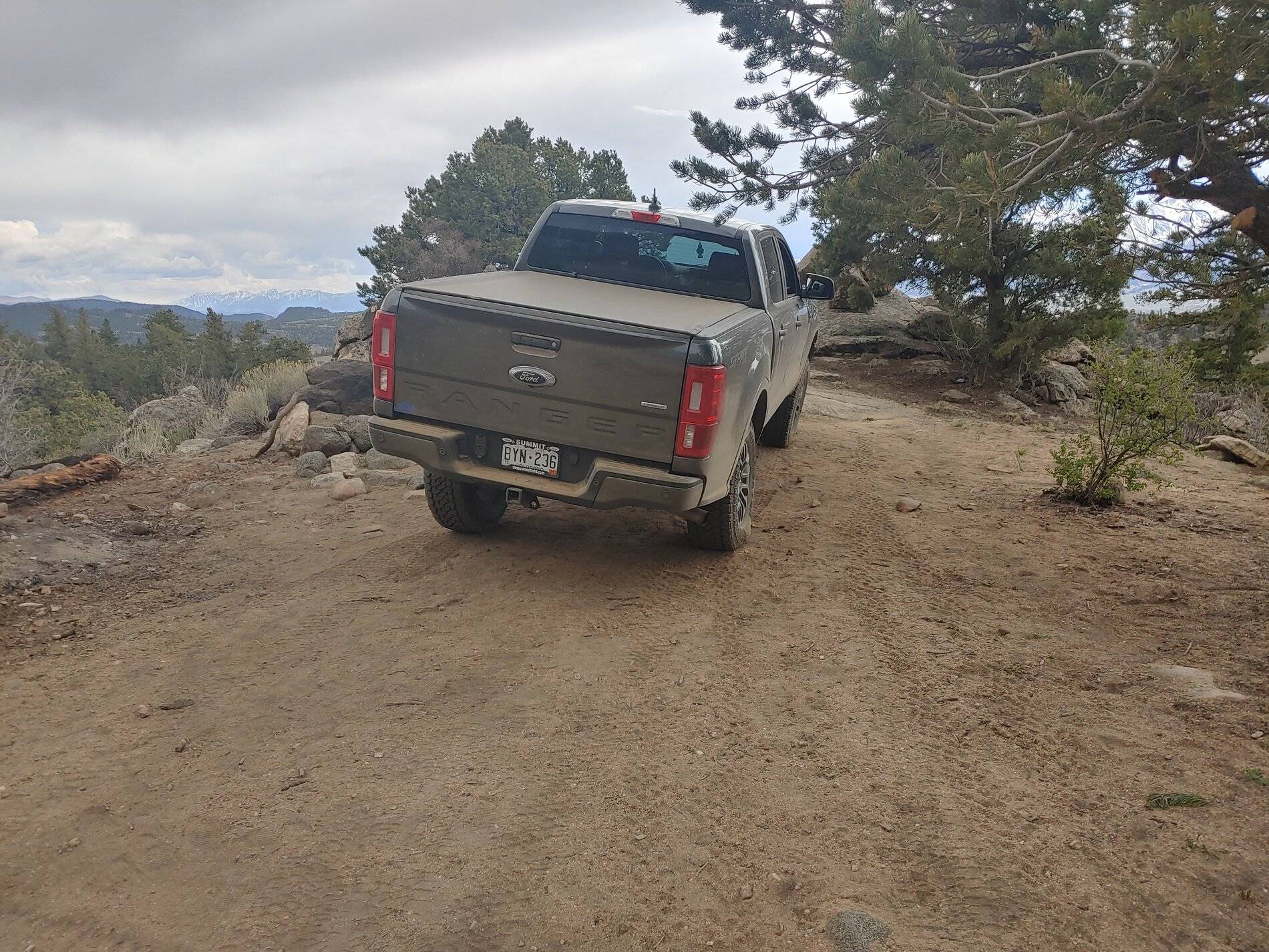

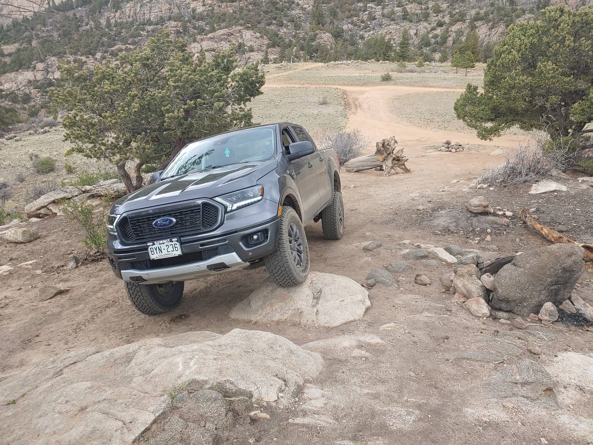

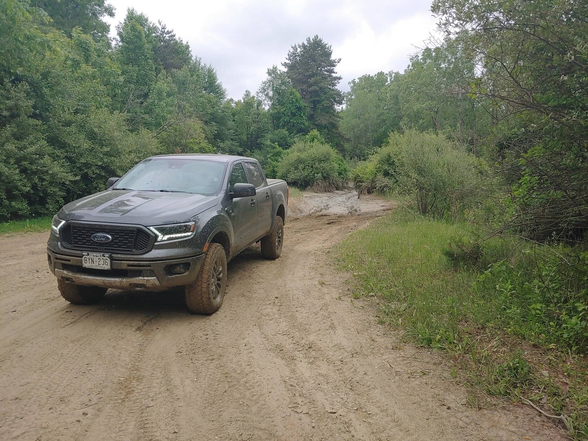

Here are some pictures of my truck with the lift and tires.
Hope this helps
