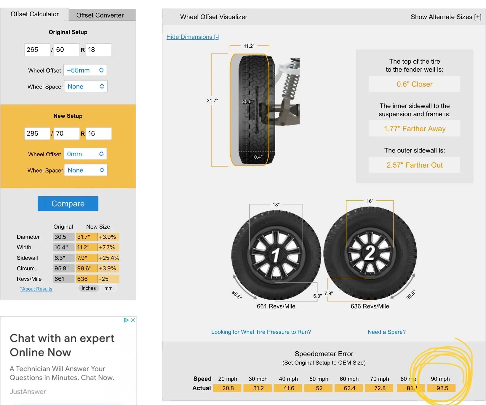

Tires are almost 32” and am I right in thinking those wheels have a 0 offset?
I’d be less worried about what they cost and more concerned about whether or not they’ll fit.

Big O has a calculator in their system that gives you exact o.d. and with height / width stat's, compared to stock set up, even speedo error. These were less than 1% off on speedo error.

I would guess that the speedo is more like 3-4% off. They might “fit” but you have to consider the anti-intrusion beams (crash bars) in front of and to the rear of your front tires. Stock offset is +55mm and the lower you go, the more chance you have of rubbing on those bars. Also, the higher you go in diameter without lifting or levelling the front of this truck, the more chance you have of hitting those crash bars.
Here’s a screenshot from tiresize.com that compares factory to your proposed setup.
Let me know if I have that stock tire size right and if the offset of your proposed rims is zero - the AR site suggests they are.
