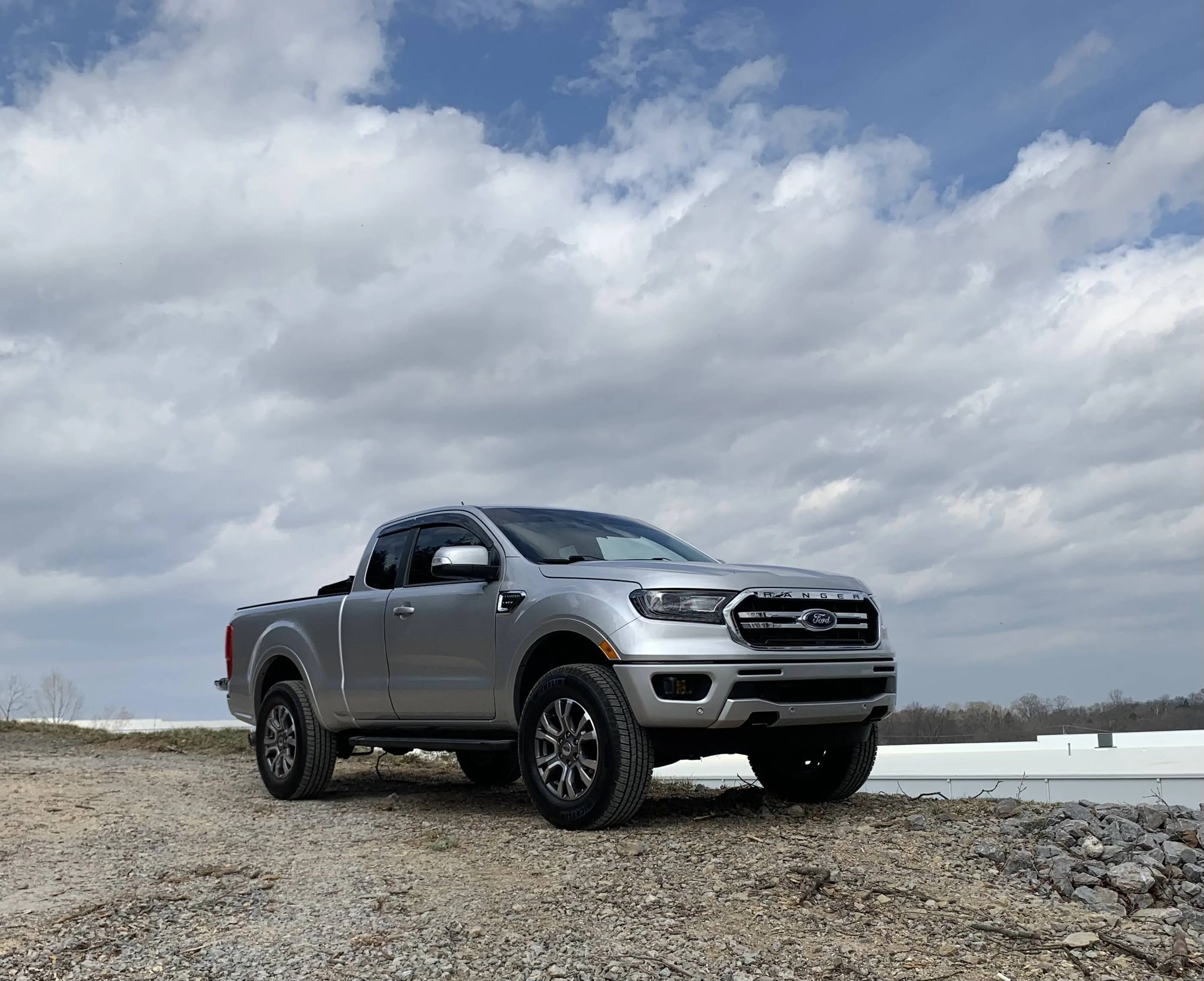

I mounted Eibach’s adjustable coil overs and actually adjusted them down so the front fender lip is a 1/4 lower than the rear.
Not a good side pic but I’m happy with the stance. I’m thinking of getting a topper so we’ll see how it sits after that.
