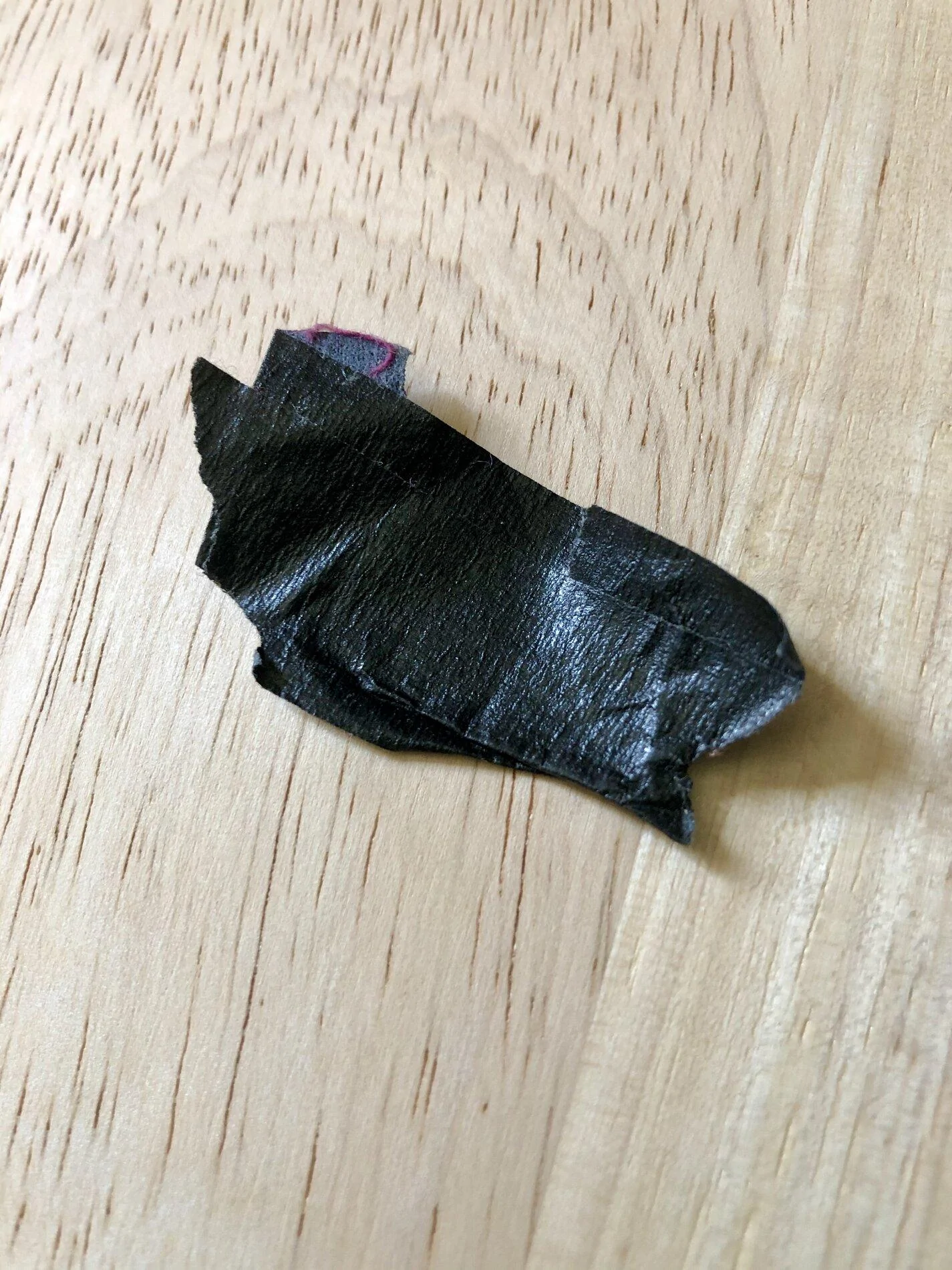

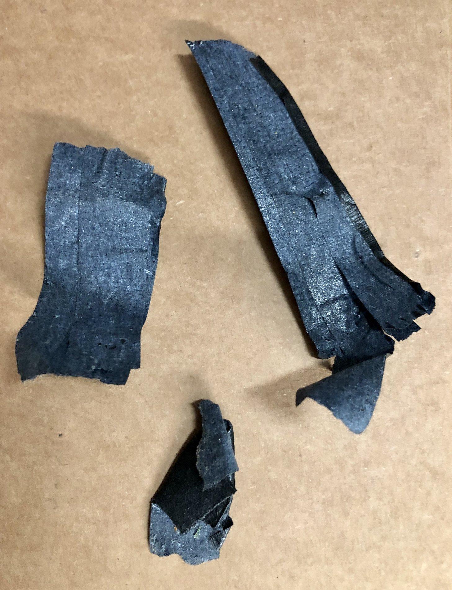

Never had the smell but one thing I did find around my engine and under it was black tape that is used to hold wire harnesses before assembly. I found discarded tape around engine on top and few place on the underside toward transmission.
I mention so you can search and see if any around exhaust manifold or down pipe. Wondered is reported smell some had was ever this tape getting hot.
