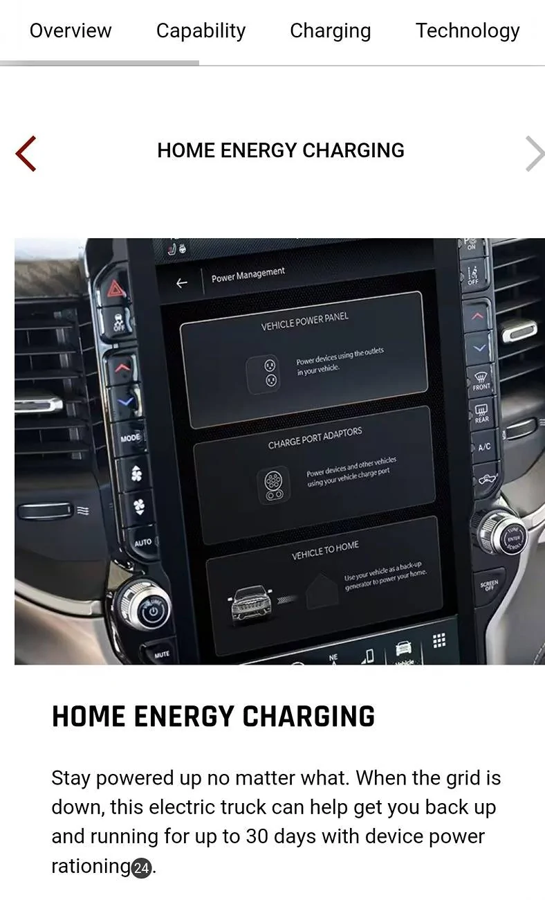

I've seen their videos and it's compelling to think you could drive that whole house generator wherever you needed it.
As for the Dodge it seems to have a limited function:
A whole house generator, with the ability to power every circuit in the house (not necessarily at the same time), needs a transfer switch, and it must be wired in between the service entrance and main panel. You're not going to just drive up to any house and power it up. Any setup other than that, such as backfeeding the main panel, will require that the main breaker be shut off to avoid killing linesmen working on the poles. This kind of setup is illegal in most states, and for good reason.
Now if this thing has a power distribution panel that provides circuits that can be wired individually to household appliances, lamps, etc. via extension cords, that's legal, but it's not a whole house generator.
Yes, there’s obvious problems just hooking up to your house. But in 5-10 years when battery power storage is more common in housing, don’t you think there would be a way to safely feed that power as a link to your home’s circuit?
Solar/geothermal/hydro/whatevergreeniepowersourceulike residential systems today all have transfer switches if they are connected to the grid. It's required by the NEC in all states. The question is, how does a vehicle with an electric power source safely tie into it? It's not hard from an electrical control system standpoint. I'm not an expert in the practical side of this kind of system, so I don't know what is available today to enable what RAM is trying to do. However, if this capability is available today, it's only available to homes that already have an alternative whole house power source set up. All this assumes that the RAM whole house power feature delivers 220VAC (in the NAR). If not, then there's a whole host of other stuff that's needed to make it work.
Shovel, I am definitely no electrician and much of that went pretty far over my head. I am no longer useful in this conversation lol. Will try to understand with some research what you’re talking about

Y'all do know that you've been able to feed your home with the F150 Powerboost since it launched, no? The 7.2kw ProPower Onboard does exactly that.
Pop in a transfer switch and off you go.
Alternately, I power separate circuits in my house with a different sort of transfer panel off of my generator and soon my camper with its new solar install.
