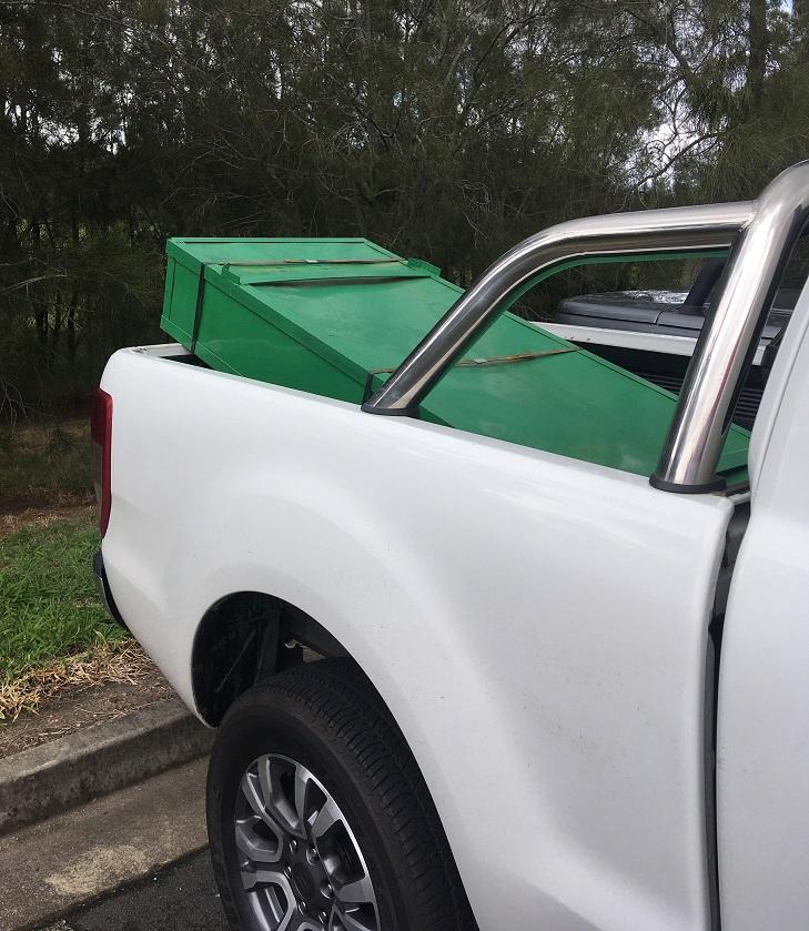

Yes it is, but that's far too short for moving around a lot of the things I do. I still have my old Nissan Hardbody Single Cab for now as I am constantly changing between the two depending on what I am doing. Even my mountain bikes don't fit inside the back of the Ranger without removing a wheel. I only had the vehicle for a couple of months before I'd had enough and decided to go down this path.
I don't know if it done much elsewhere but in Australia it is quite common for Super Crew owners to do 300mm chassis stretches and fit SuperCab Tubs. There are companies all around the country that specialise in this with a 1 week drive in/drive out service. To date I have never seen a SuperCab stretch though, and here we haven't had a Single Cab factory delivered with a Tub/Bed back since 2015 so they are very hard to get (and quite expensive). South Africa still get Single Cabs with factory Tubs across a lot of the range.

How to the the modifiers handle the rear wheel house? Do they more the rear axle aft and lengthen the driveshaft? Or do they modify the rear box panels? Quite a serious mod...

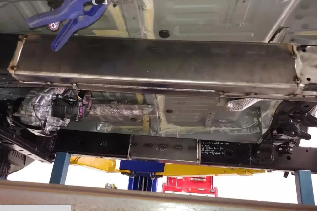

Actually not to bad at all structurally. They stagger cut the chassis "C" sections under the cab forward of the center tailshaft bearing carrier and in my case add approx 500mm. Then you get a new front tailshaft fabricated. Everything aft of that is standard Ranger so no change to diff or suspension required (unless you so choose). I already have an OEM Ford rear wiring harness for a Single Cab so that everything will be exactly as Ford spec'd it aft of the rear firewall. The only additions are an insert section for standard brake and fuel lines and a longer park brake cable. Being an Aerospace Engineer I am pretty fussy about my mod details and I am pretty happy with the way it is done. Theses stretches are fully approved by our Transport Authority and receive mod certificates. The chassis builder I hope to use specialises in very high horsepower modes in muscle and drag cars that are street legal so I am thinking that the lowly Ranger will do ok.

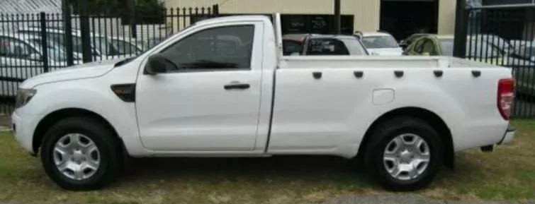

I don't assume that you guys receive Single Cabs over there but this is what they look like, nice long bed.
What we don't really get in Australia is large (affordable) pick-ups. My Dad had a 1980 F-250 crew cab with the long bed (in orange) and the thing was huge. From memory it was a 351 petrol engine. Until about 2 years ago no manufacturer brought any American Pick-ups into Australia, they all had to be private imports and then locally converted to right hand drive. Now Dodge brings in the Rams but a 1500 with petrol Hemi starts at around 90K on-road. My Uncle bought a second hand Ram 2500 diesel a few years ago to tow his big 5 horse float and it cost him over $140K
