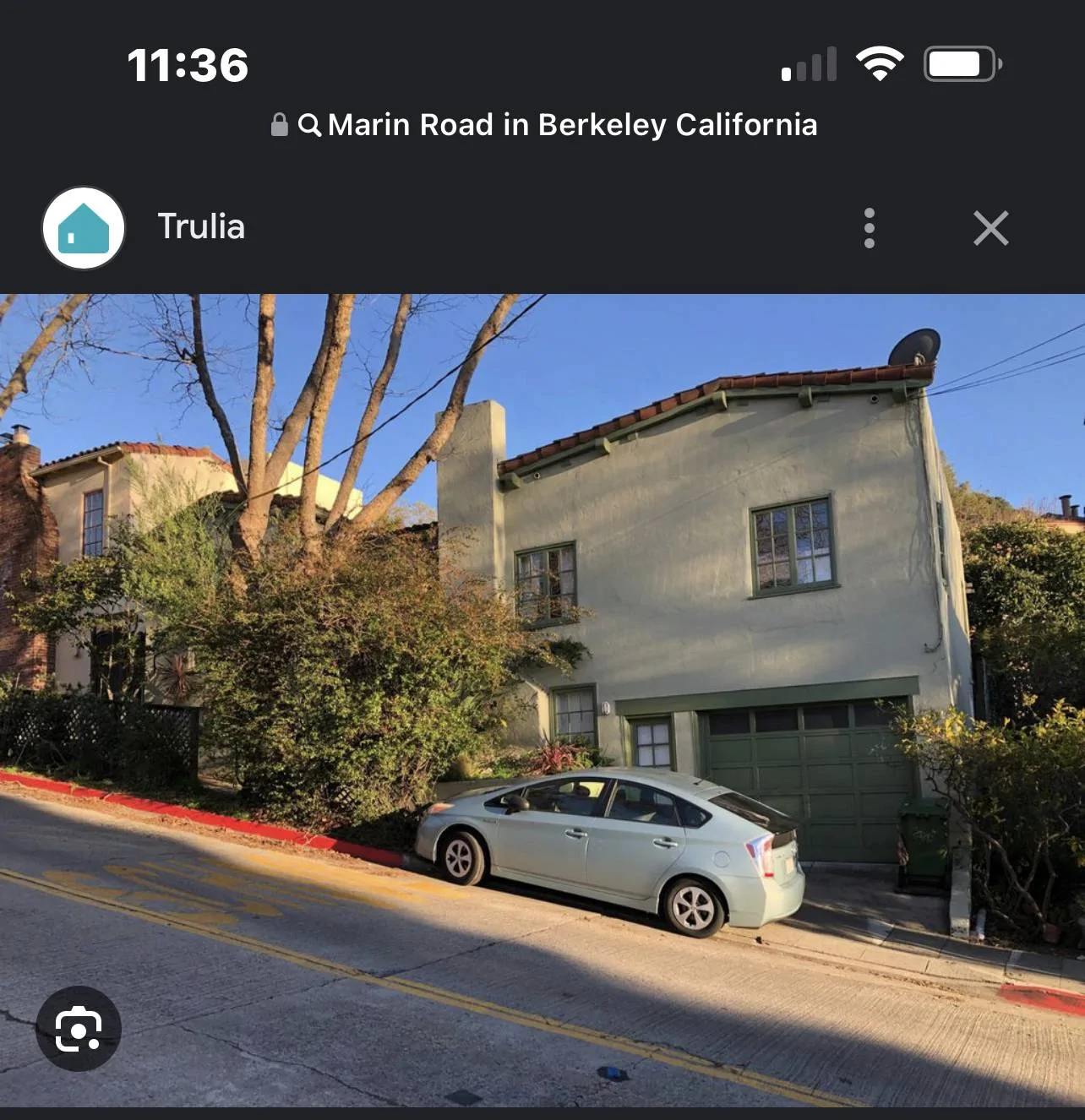

I don’t know if anyone is in there with Marin Road in Berkeley, California, which takes you straight up the hill into the Berkeley/Oakland Hills, but I would say it’s the steepest thing I’ve ever seen. Going uphill, there’s five stop signs as well…
I checked it with the truck as I was going up and it was going back-and-forth between 12° slope and 14°. I was rocking that at age 16 with the racing clutch on the cobra. I had driven it before the racing clutch and after… Talk about increasing difficulty lol.
Anyways, I have a picture that kind of gives an idea of that hill. Anyone who can drive this hill with a manual transmission and no special features, handling the stop signs going uphill, I give them a pretty darn proficient, score for manual, transmissions skills. The funny thing is, I think it looks really steep in the picture, but it doesn’t even do it justice lol. (ha so fitting… The car in there is a Prius. This is before electric cars)
You can tell who knows what they’re doing and who’s local to the area because you won’t see brake lights. It’s so steep, he just let the car slow down on its own, then feather the clutch with a little bit of that skinny pedal… Try to look like you have a clue, and limit your back-and-forth action… Then when it’s your turn, drive off as normal.
