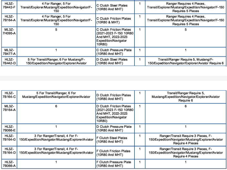

The programming does blip the throttle on downshifts to smooth out the gear change.
While the Ranger is a budget truck, the 10R80 transmission is the same unit that is used in the Raptor, hardly a budget truck. The only difference is our torque converter and programming to match the 2.3L's power output.
Almost.
According to this, we have 1 less friction and steel plate in the C, D and F clutch

Almost.
There are differences in the 10r80's in the various models yes, but ultimately his and I's points are correct it does rev match as you downshift. Any idiot could see that by simply driving up to like 30 mph and then slowing down (not calling you an idiot see my prior comments to see who I am)

Almost.
Good to know. I would have thought that economies of scale would have prevented that, but nice to know (joke) that Ford is squeezing every dime out of them.
And then they went and made the 10R60 which is even cheaper still and I suspect will be in the 2024 Rangers.
Also, as the aftermarket starts rebuilding these things, they'll start adding those steels and frictions back in just like they've been doing with old school 4L60's and 4L80's. Most rebuilders routinely add clutches back into their packs and the 10R80 will be no different. Sonnax or Transstar will come up with replacement drums machined for that and most rebuilders will just build them to 'raptor' spec with the 'missing' clutch plates.
