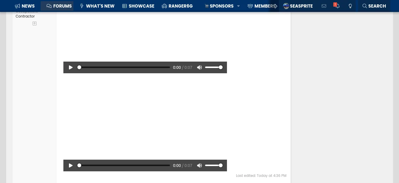

Strange.. I reuploaded, let me know if that changed anything.
This what I see
Well I just went out and looked on my own truck and didn't see anything. On my last Ford truck it was the little bump on top of dash in the middle would flash a light to let you know Pats was active. if you have one now I don't know how would tell.

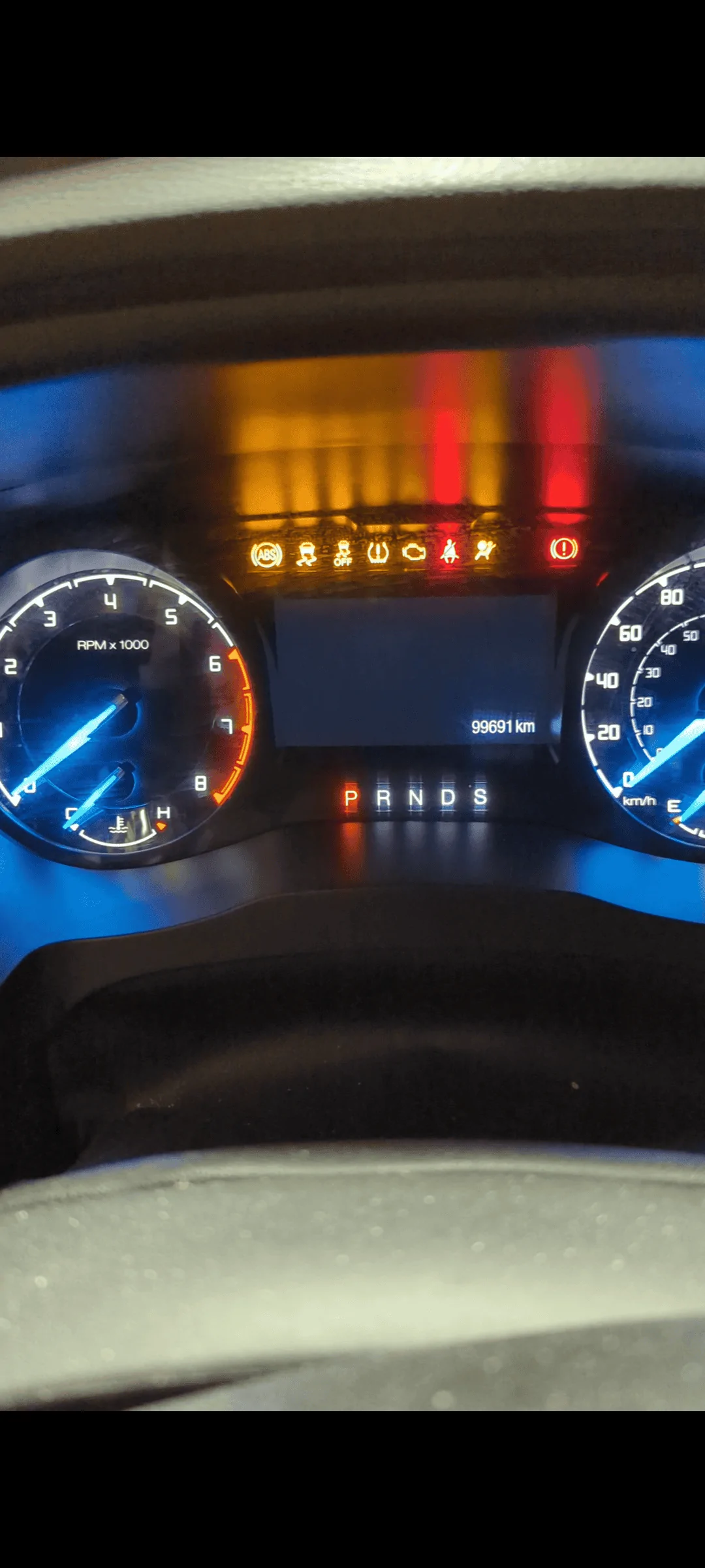

This what I see
Here's a screenshot of dash lights during that video, don't know why you can't see it.
Anyways, as mentionned, no Antitheft light.
Anyways, as mentionnés, no Antitheft light.
Okay just looked it up. The instrument panel display will tell you if you have a PATs issue.
