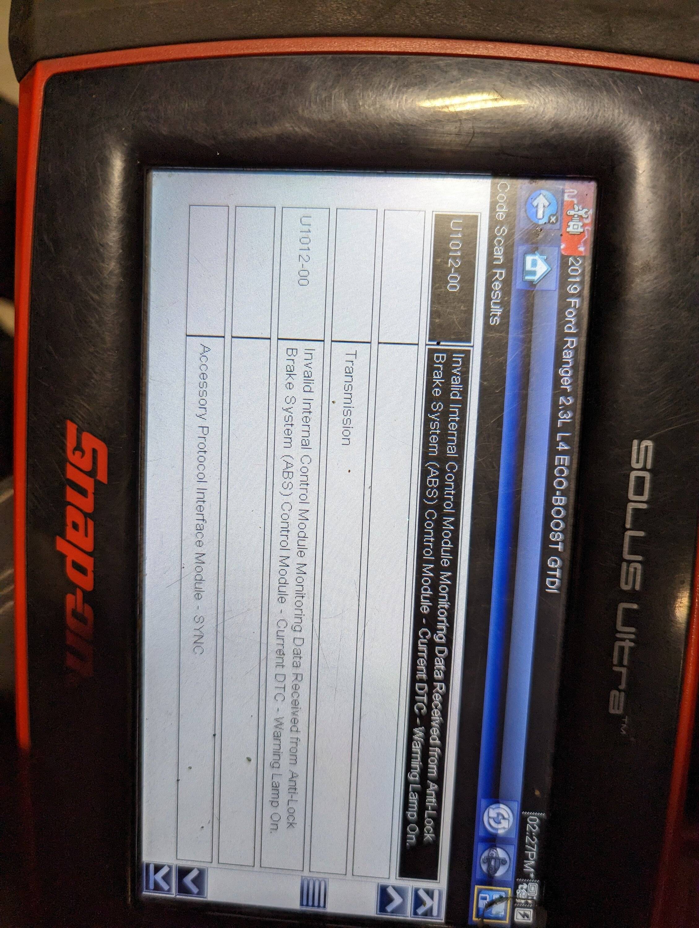

You're trying to fix this truck without service info and without a Ford scan tool. You have very little chance of stumbling onto the cause of your problem.
Thanks for your reply. I disagree, but that's alright. Pretty sure we've got this issue narrowed down to an anti theft problem.

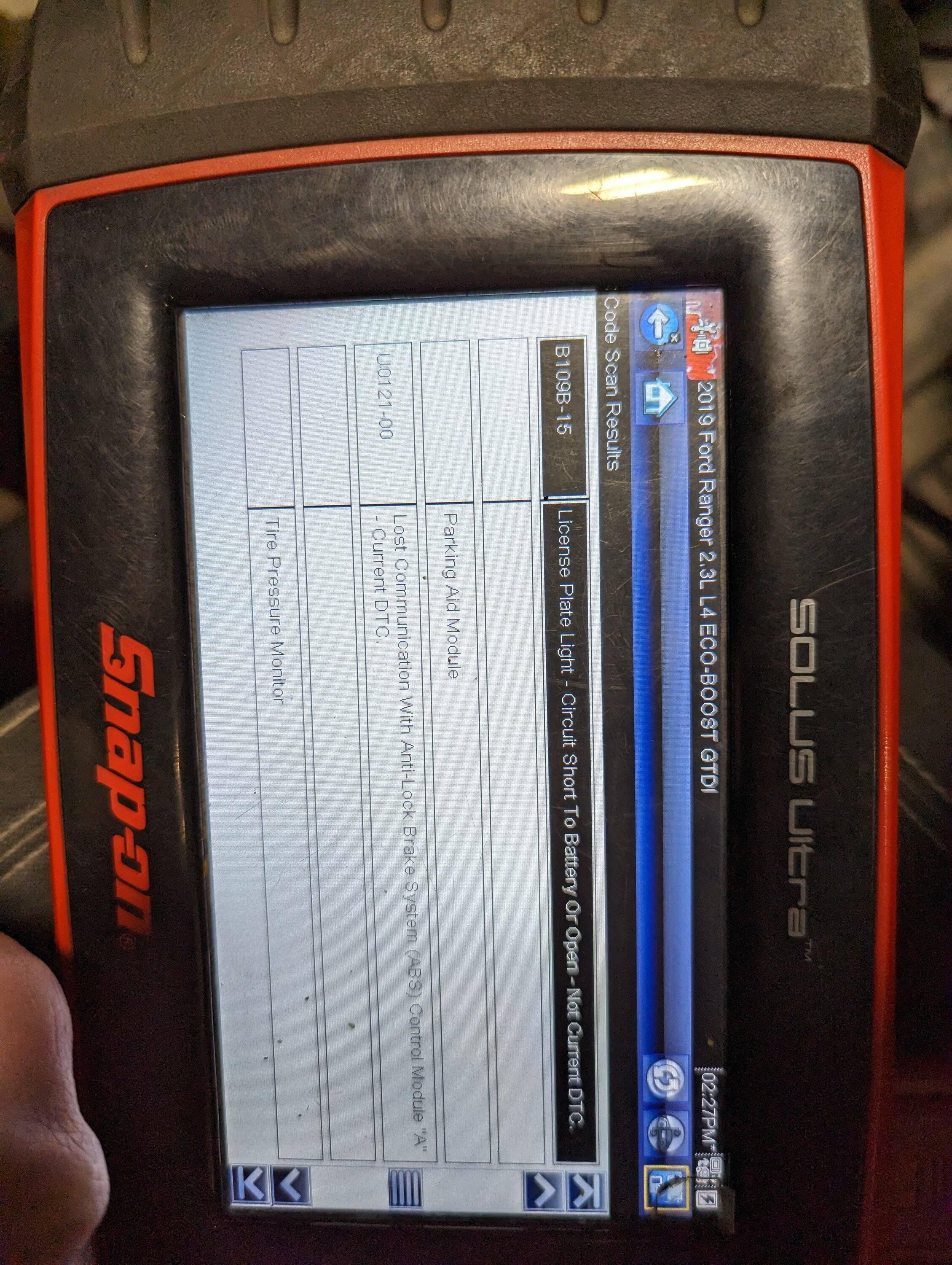

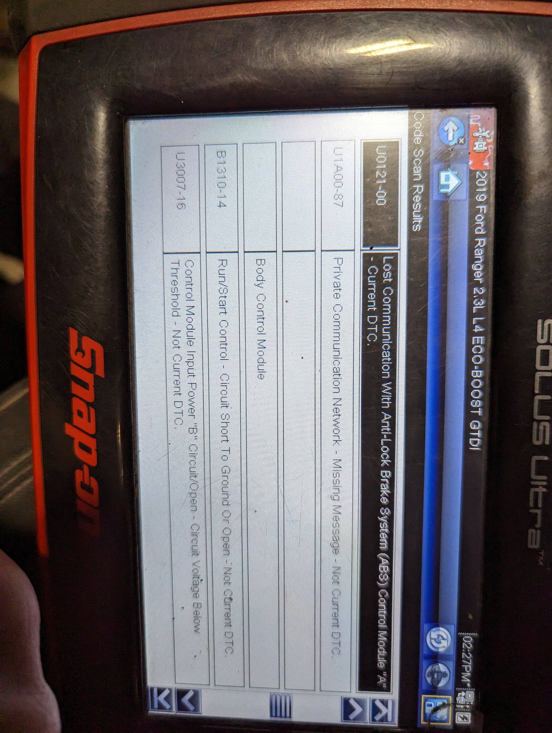

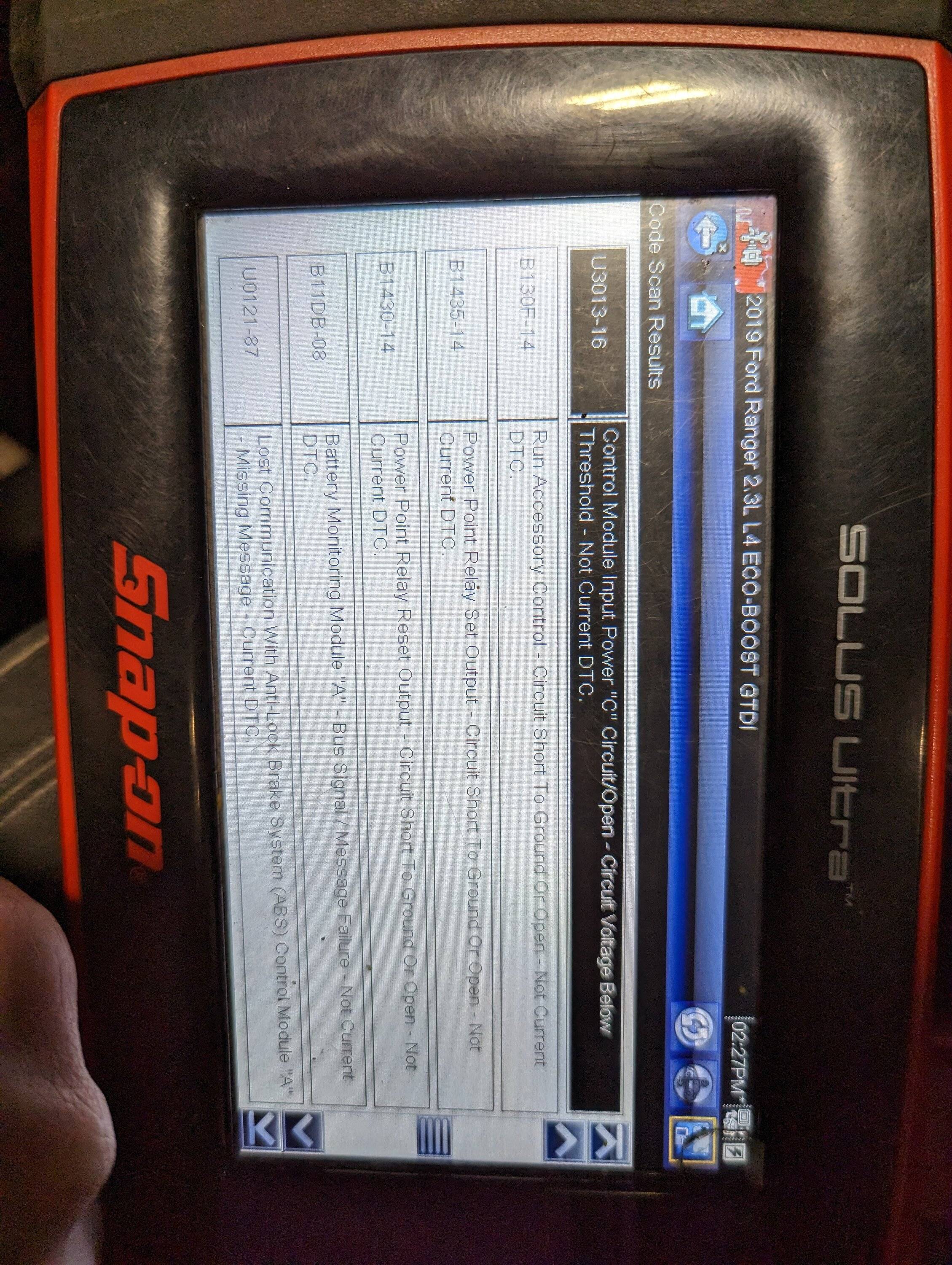

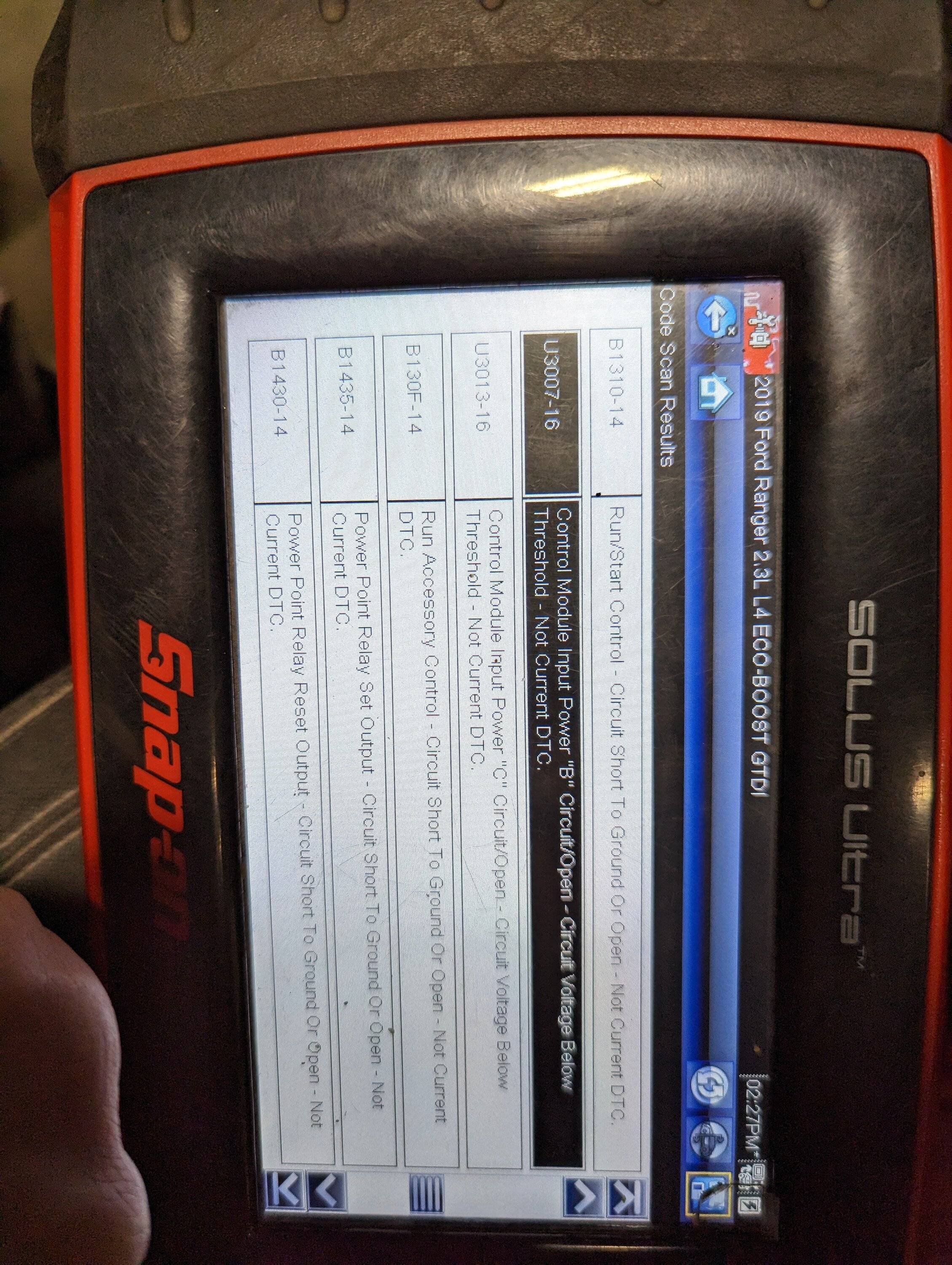

My thoughts, you have removed all memory by touching the battery cables together, you therefore removed the memory for the key authorization to allow a start. you can view live data PCM and look for this PID: PATSENABL- If it shows disabled then you will need to reprogram (2) keys, it requires 2. You will most likely need to use the Solus to do it, as you have wiped all memory from the BCM. All of those PIDs are for lost communication, shorts to grd etc, were generated, by touching the cables together.
The truck is equipped with KAM (Keep Alive Memory) so those powered modules picked it up as a short.
The Advance Trac is most likely due to the lost communication with the ABS Module, and or low battery.
Things to try.
Clear all codes and then perform Self-Test on BCM and PCM
Close Hood and All Doors, then attempt start (mainly the hood)
Although, I have not looked at the starter, but is it like an old school starter where you could put key to run position and use a remote start (tool) - (The push button type) , hook directly to the starter positive post and the (s) terminal from the switch, and this way you are bypassing the PATS system, at least in an old school vehicle this was the way to test if A/Theft was locking the starting out. Not sure on the Ranger, if the system will let you.
Reprogram 2 Keys using Scan Tool (The Solus) - I'm fairly certain this will fix it.

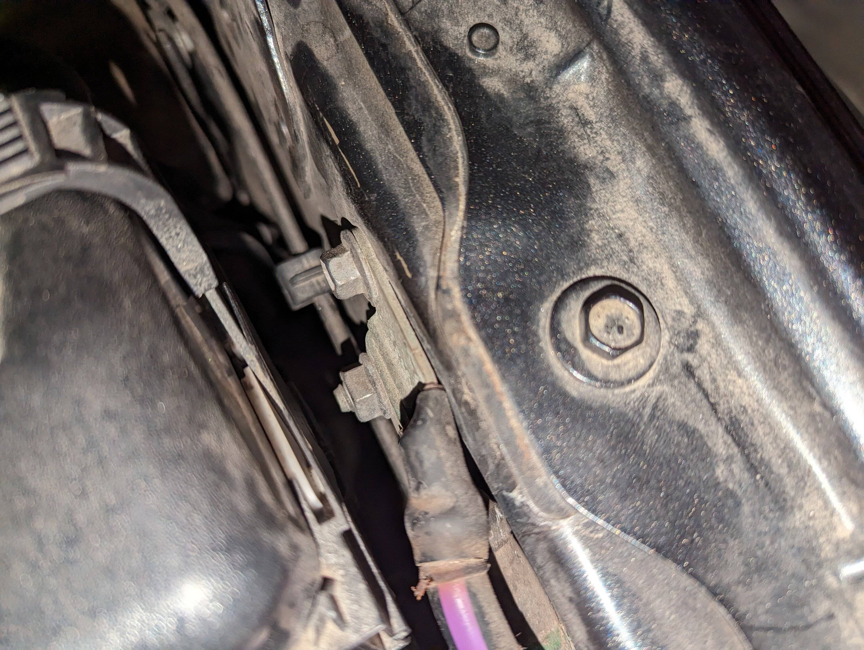

We have found our issue. As it turns out, a very small shard of plastic had chipped off the side of the ABS module, and lodged itself between the two bottom pins of the module side of the connector. This kept the plug for the ABS module from seating properly, causing the no start condition. Being in a very awkward location to inspect, this was not an obvious issue. We found it by chance, while revising the pins on the module to make sure nothing had been upset there. It had been removed for testing, as our initial issues were from the ABS system.
Bottom line, we got the shard out and seated the connector properly and the car came back to life. The initial ABS and Hill start assist faults have also been cleared.

In a way the scanner did tell you, you had an active code for the ABS module.

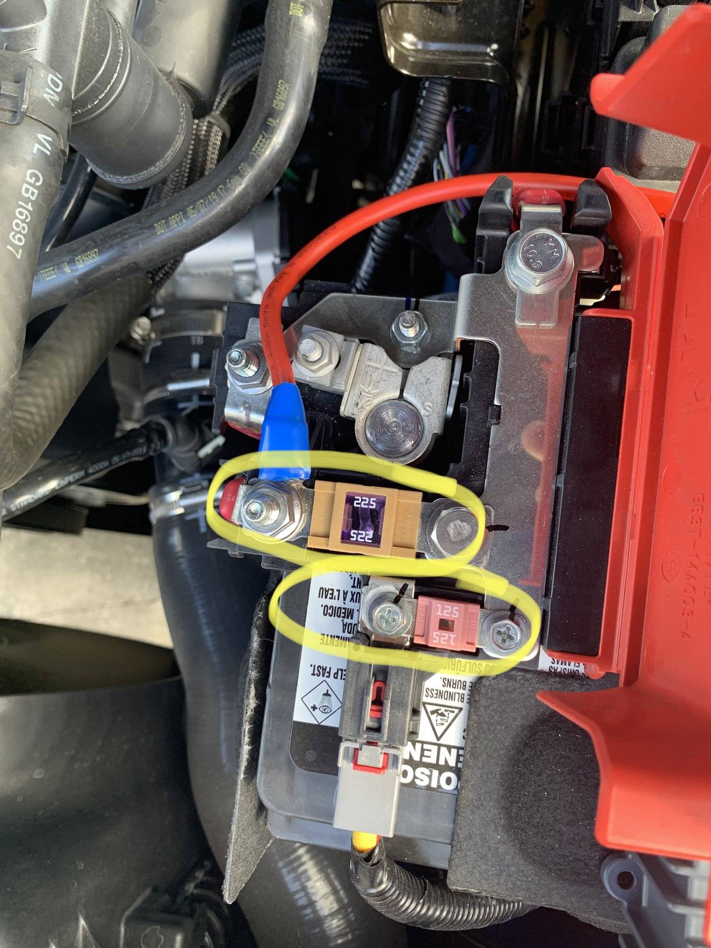

On modern cars, NEVER short the positive and negative cables even when not connected to the battery. If you want to discharge the system, you should do so with a resistor as to not "shock" discharge the system.
