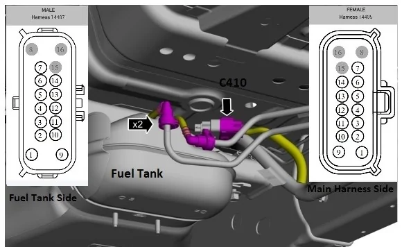

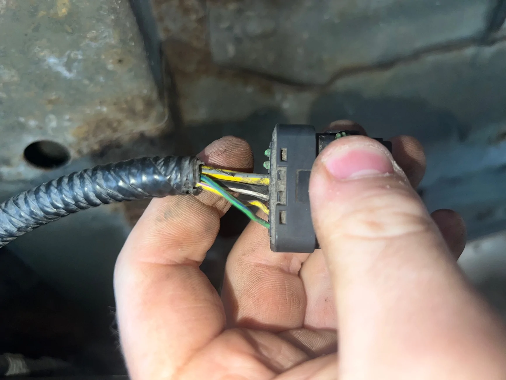

You now need to isolate where the power or ground loss is, I have a hunch you have a bad ground -if you have a connector located just below the tank - check this connector for corrosion
C410 - 2.3 Ranger Example - this has a shielded ground for the harness as well as the pump module ground.
Not sue (100%) if the 3.2 has the same basic operation of pump control.

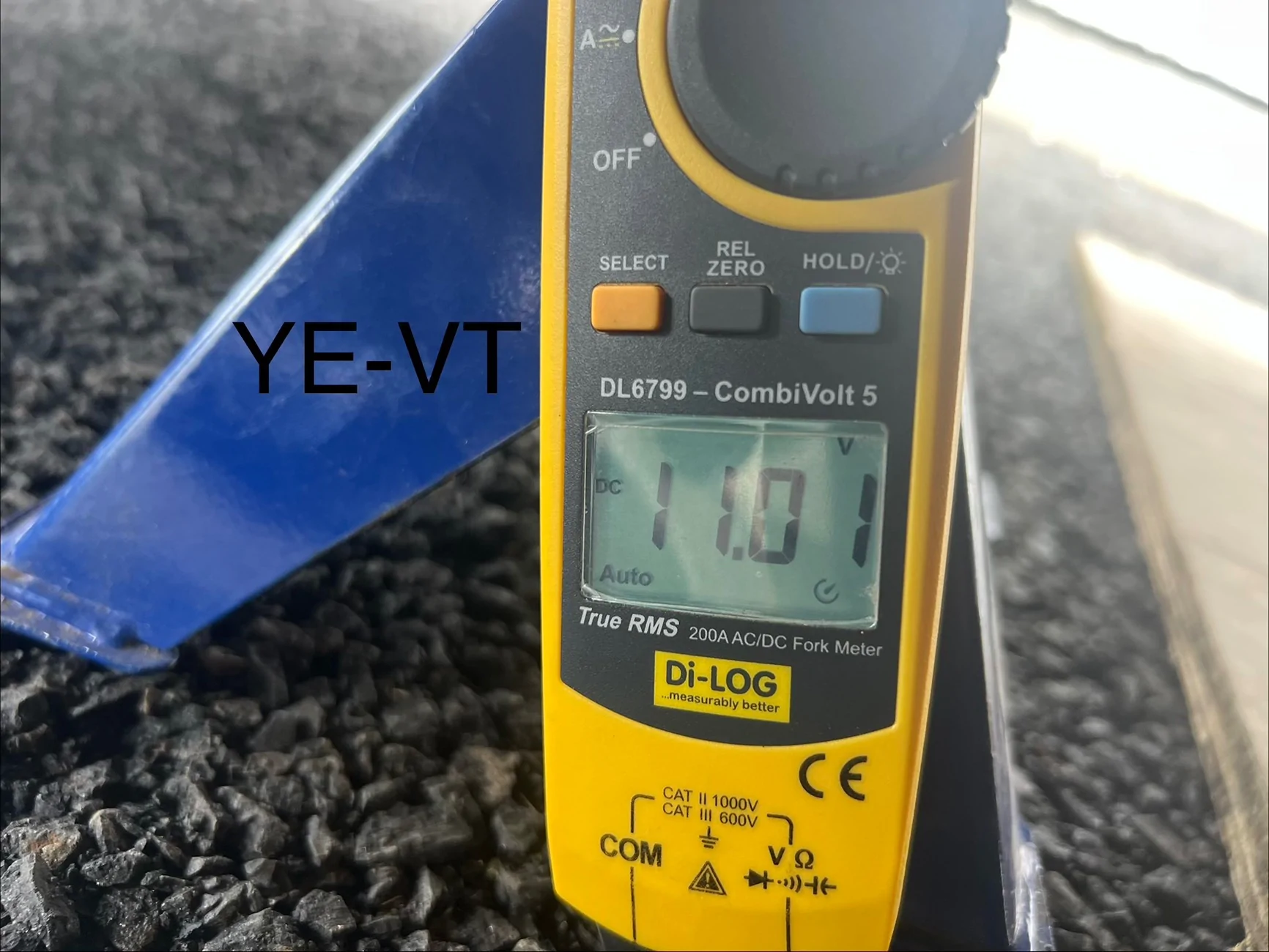

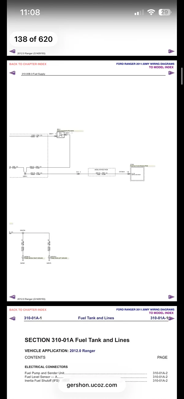

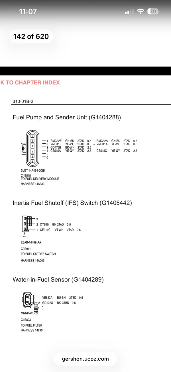

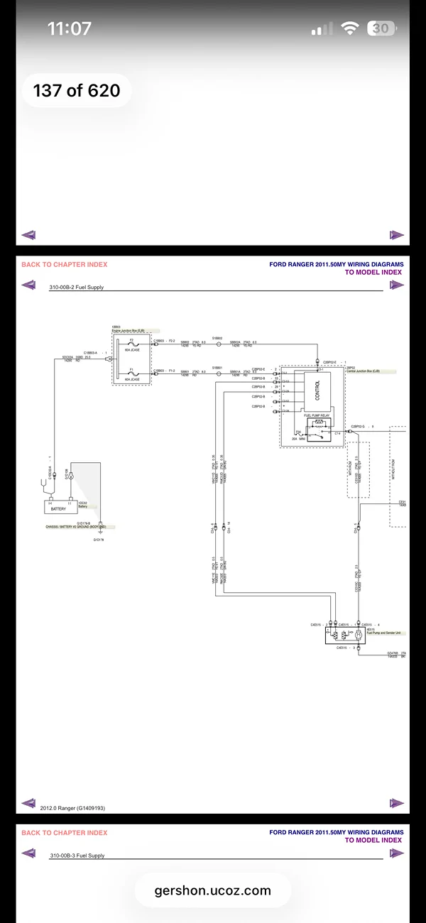

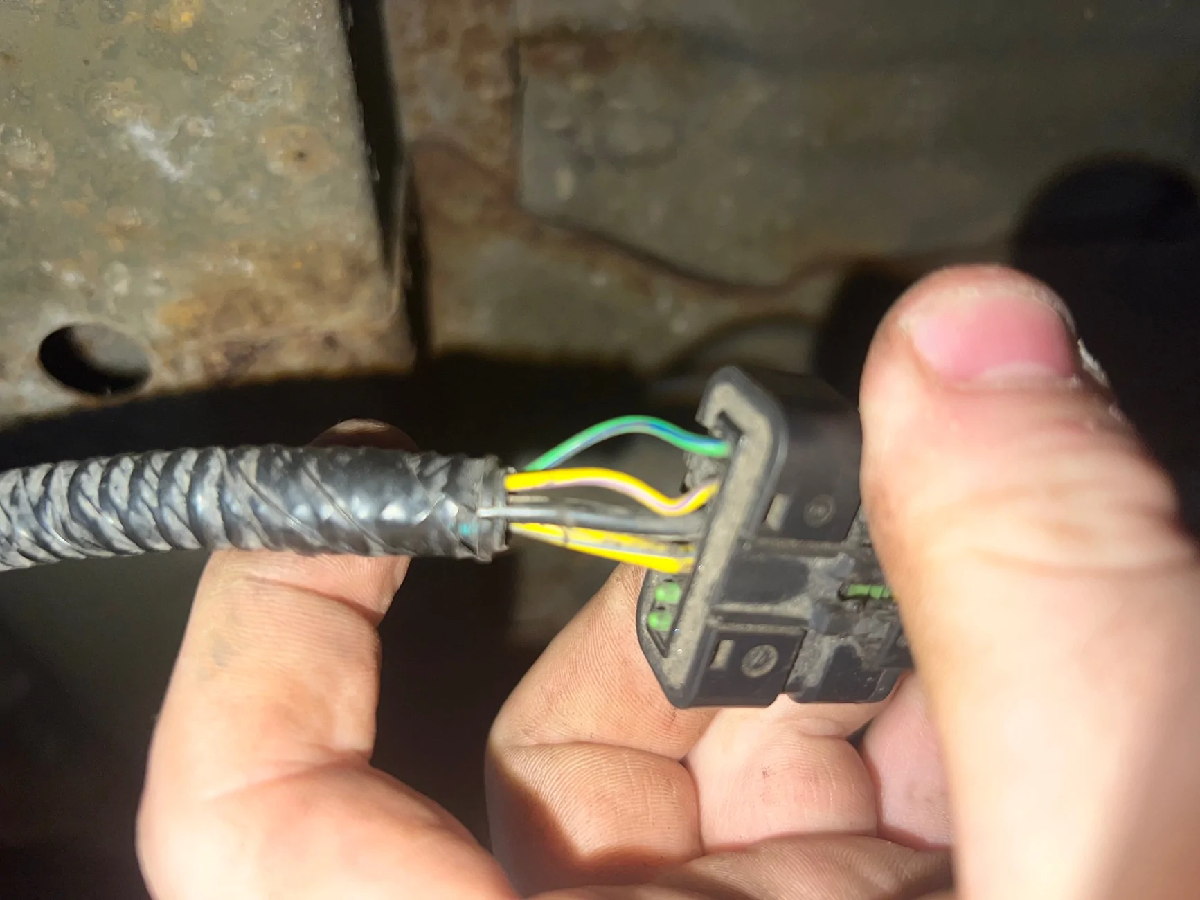

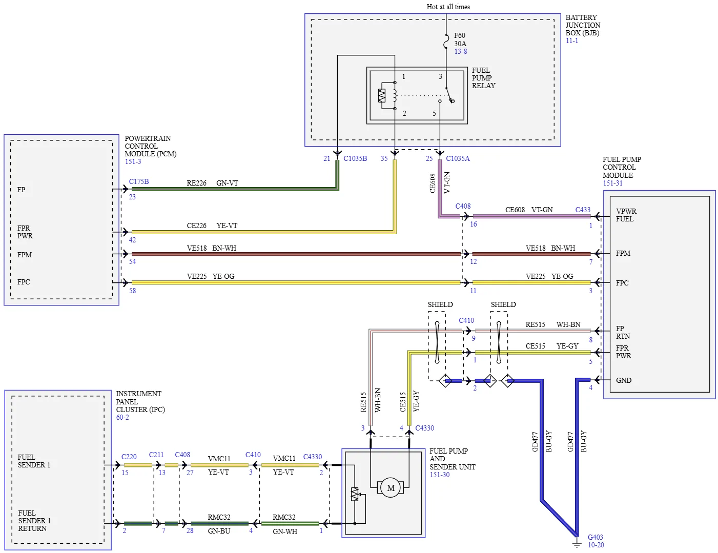

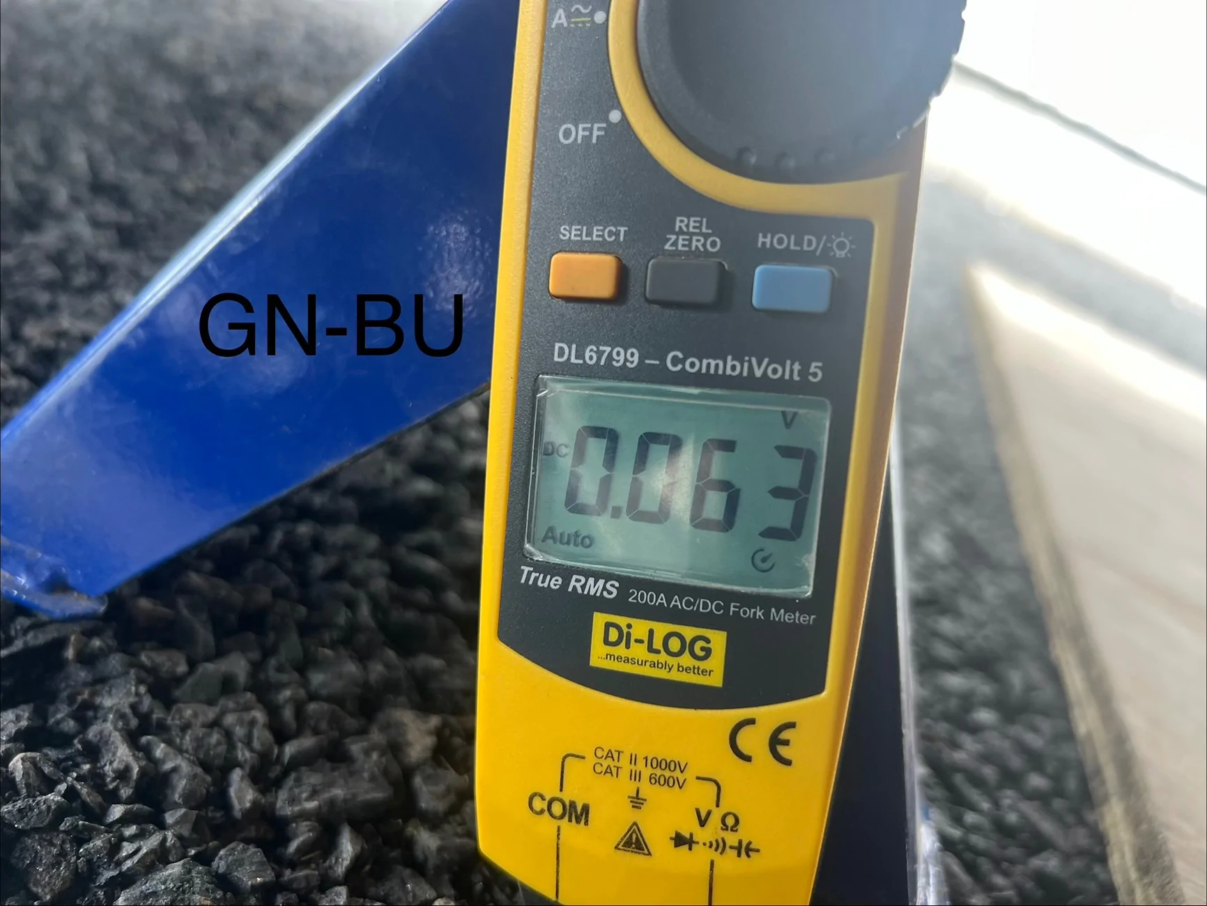

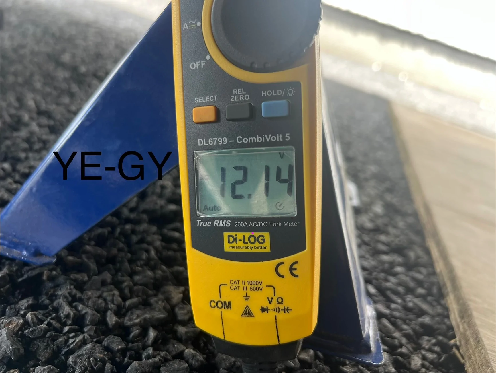

I got the tank dropped again to get a look at the connector, then found wiring diagrams for both the plug and the circuits, I am getting 12v at the pump but am only get 11v and 0v on the other two wires from the fusebox, once I reattached the plug to the sending unit it done the same thing as before as started and running no problems multiple times and would free rev fine, with that I got it onto forscan and looked at the live data and was not getting data from my fuel pressure Kpa sensor, I then added the individual data from both sensors to the table and got pressure at one, which is sensor A so I can begin to diagnose if it is the wiring or sensor itself. I have also attached all pictures and diagrams incase it would also help

Did you check the (Resistance) on the Pump Ground?
The 3.2 may not have a (Fuel Pressure Sensor) as it may only use the (FRP) main clue is (Blank Display) sometimes scan tools will display PIDs that are not even installed and either be blank or read (0) - this can be misleading, so you need to know what actual sensors are installed (sometimes) and the sensor A or B - adds to the confusion.
The other 2 wires - you mentioned are (the pump control - PWM) to control the speed of the pump - you really need a lab scope to see it (turn on and off)
So as long as you have a (Good - Pump Ground) then the issue is upstream of the pump

The fuzzy diagrams are hard to read but I see a relay supplying 12 volts to the tank fuel pump (no pulse width modulation) and the other two wires seem to be a tank level float sensor causing a varying voltage based on fuel level in the tank.
