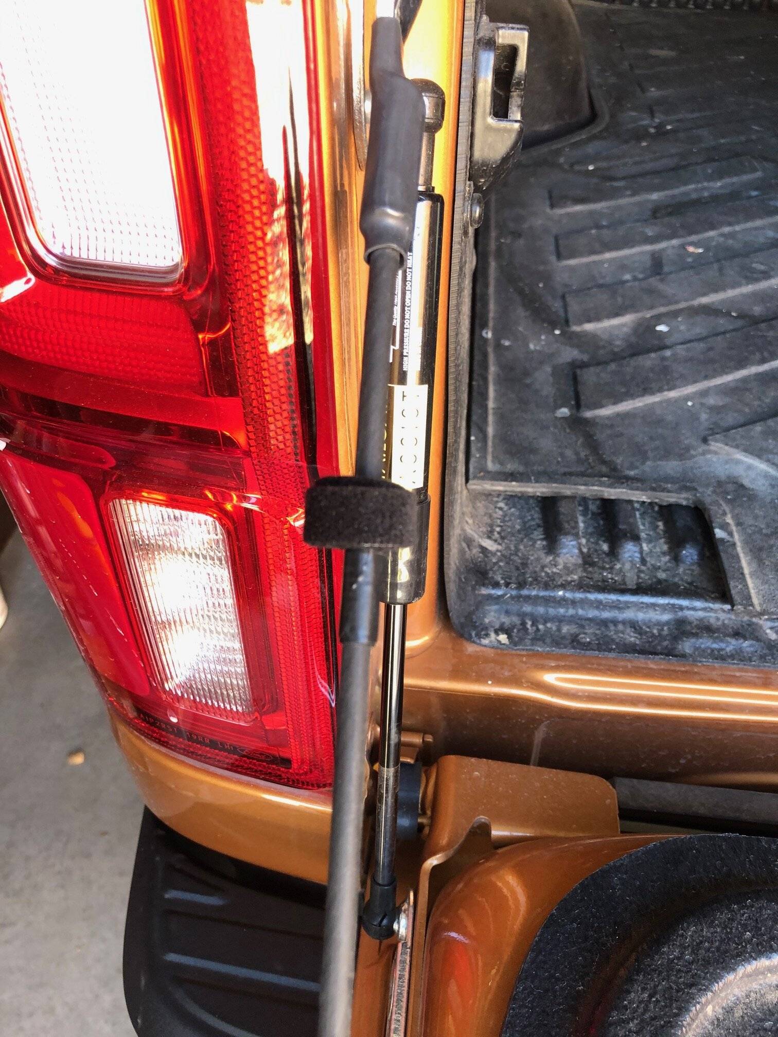

No, I only have about a 3/8" wide piece of velcro. Maybe I should try more. The top of the cable keeps wanting to go to the right of the damper, even with the velcro.
I used a "fuzzy" Velcro roughly 4-5" long x 1-2" wide (Lowes Home Improvement)...this keeps the upper cable stiff to force it to fold below the Velcro and thick enough where it won't slide in-between cable and bed side...

Sounds similar to mine and it's worked fine on my '19 for years. I added some black tape on the bottom to hold it in place.
Maybe I just don't have enough diameter-wise. It stays in place, its the kind with a slot that you can get really tight.

My velcro tie came off an extra HDMI cable I had in the draw. When I put my damper on my Tremor it seemed to close perfect without pinching between the cable. I still added the velcro and tape just in case it went AWOL. lol

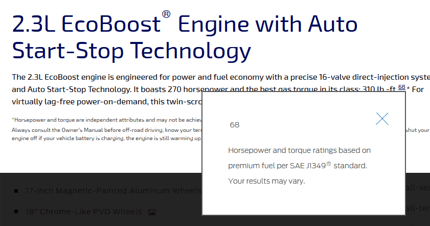

Just a note - this isn't correct.
The stock 270/310 numbers are based on 91+ octane fuel. If you run regular you'll see ~20% decreased in power and economy numbers. You don't see more than 270/310 out of the stock engine without a tune even running 93 octane.

Stock Rangers with 87 octane are putting a lowest I've seen of 235 (~276 crank HP) to around 245 (288 crank HP) calculated at 15% driveline loss.
I haven't seen lower numbers that should be there if the 270 is only with premium.
Not being confrontational. I just have never seen lower numbers.
If it is indeed making 20% less with 87, there should be sub 220 RWHP dynos.

I don't doubt that factory numbers are conservative, but the factory 270/310 are SAE J1349 premium rated numbers, so you don't get more than that on premium, but you get less than that on regular.
