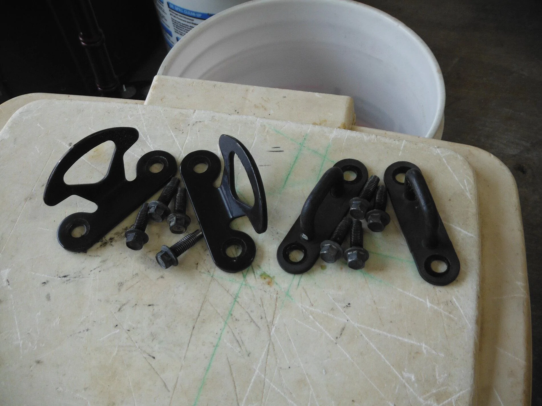

My 2020 Ranger is missing the middle tie downs. After reading the post and looking up the cost of the tie downs from Ford (around 75.00), I decided not to pay that much for some pieces of metal and screws. Therefore I went to my local LKQ junk yard. It cost 3.00 to get in and I found some tie downs on some old Rangers (see photos). When I checked out, they said no additional cost. Therefore the tie downs cost me 3.00.
I was wrong. The tie downs I got from the junk yard, is too short and does not fit the 2020 Ranger. Sorry.

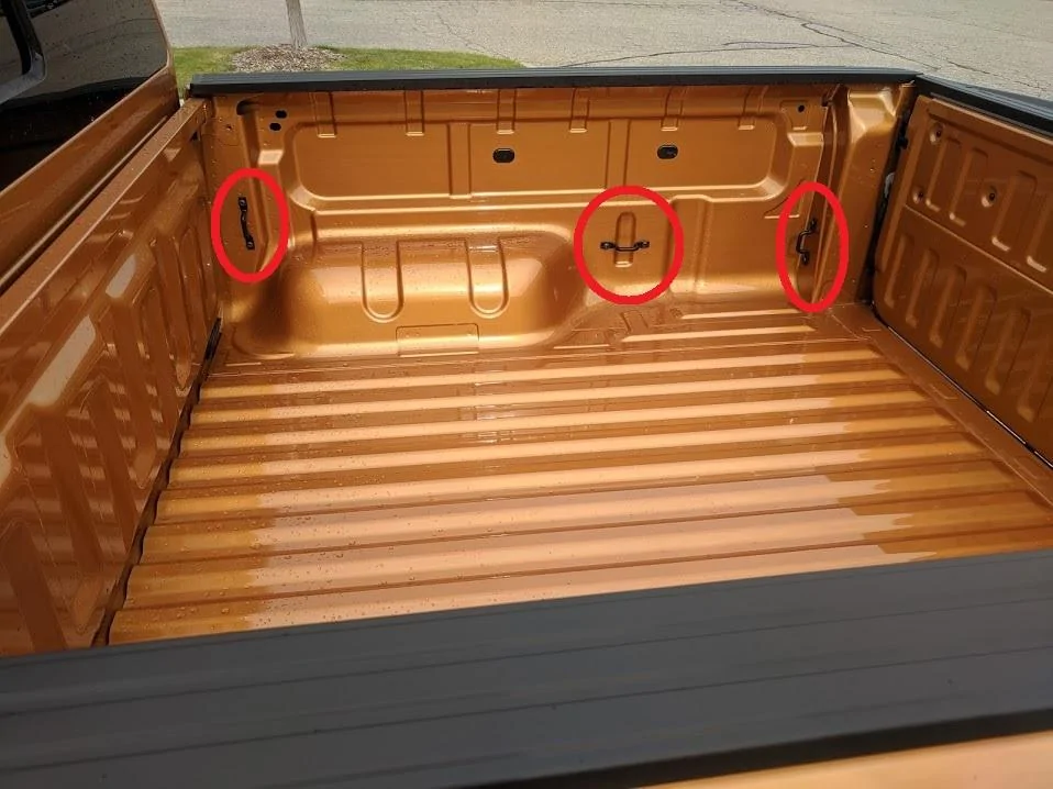

I have a 2020 Ranger crew cab with a 5ft. bed. I put a bed liner in the bed without taking any photo of the bed. Therefore, I do not know where all the tie downs and/or bolt locations for the attachments are. Can someone post some photos of the inside of the bed, so I will know where these locations are.
if it's the OEM liner you should have some round covers that pop off over each of the tie downs

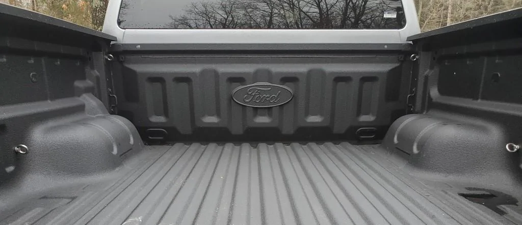

Not my 2021 with the factory spray-in liner. I had to use a tap to clean out the holes for the middle tie down bolts. 8MMx1.25 FWIW,

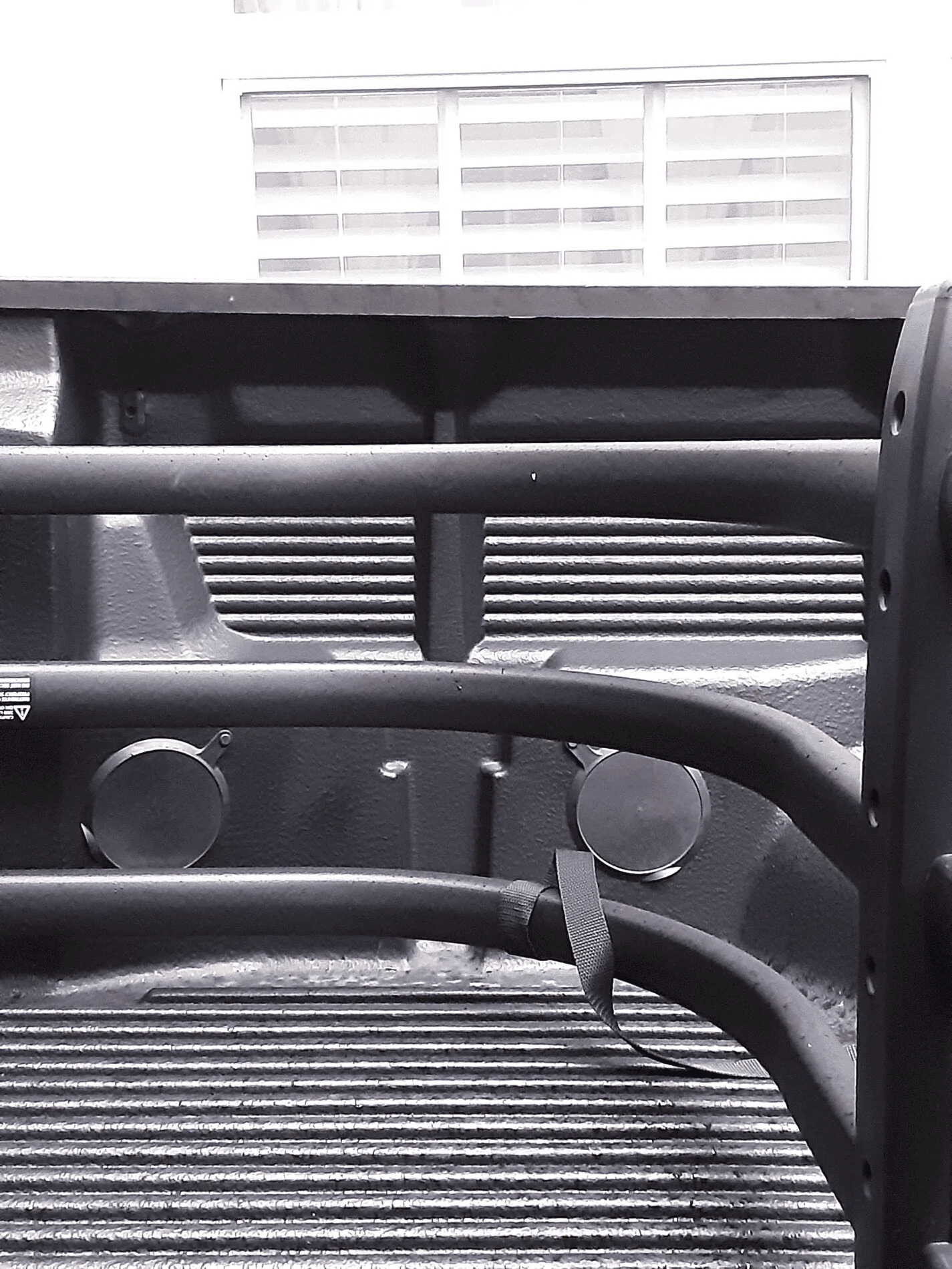

Mike is referring to a drop in liner.. not the spray liners. Here's a photo of a factory Ford drop in liner, with the round covers that access the tie downs.
