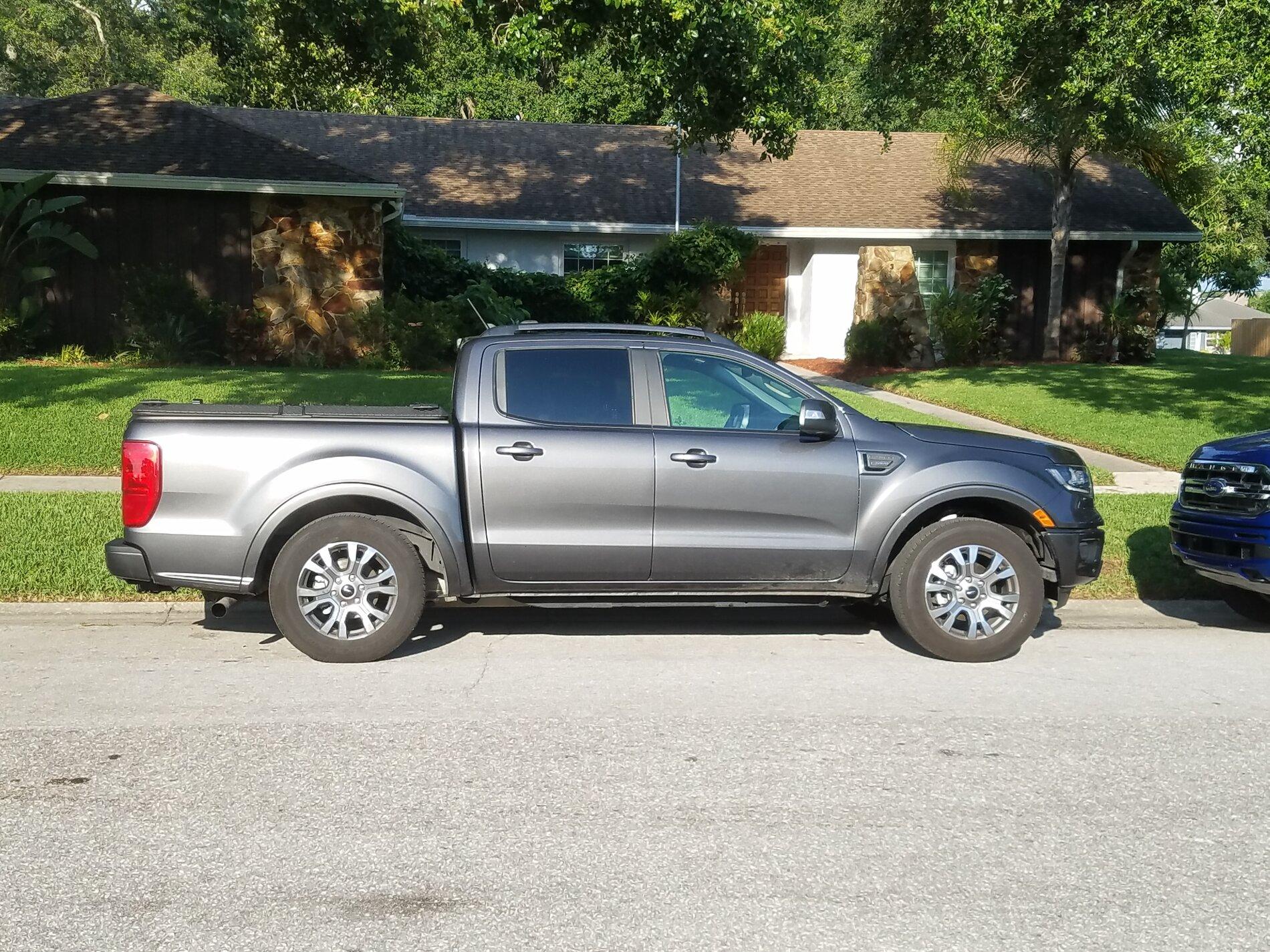

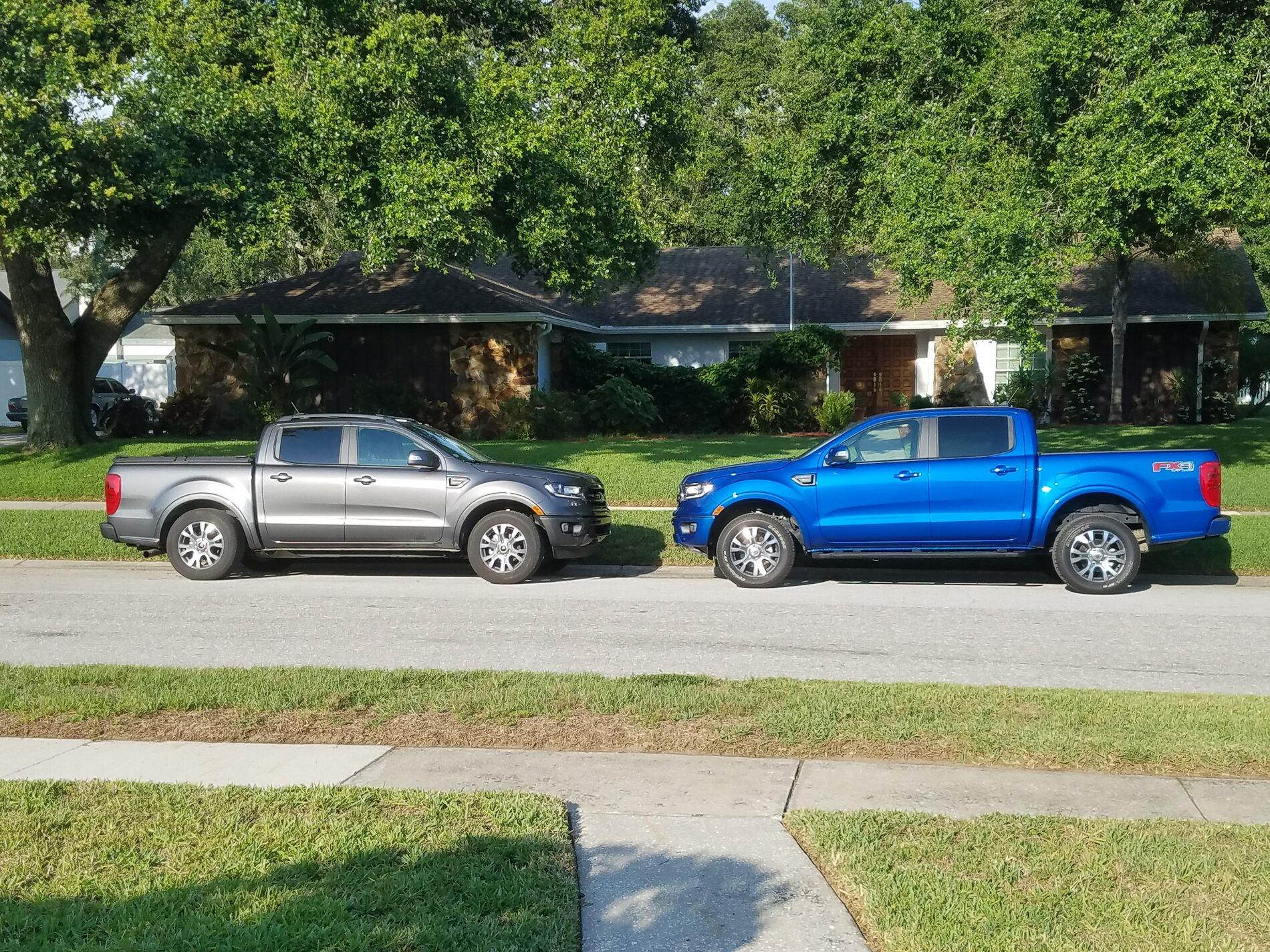

Re-arched the rear springs to add 3" of arch, cut new grooves for the front spring retaining rings 1 1/4" below the originals.
3 1/8" spring perches, heavy 2 1/2" spring plates and u-bolts to flip the axle over the rear spring.
Adjustable Rancho Rs9000 rear shocks from an early 2000 Nissan Frontier with longer metal spacers for the bushings.
Light duty Timbren rubber springs to replace the foam bump stops.
Not radical, not "slammed", works for me.

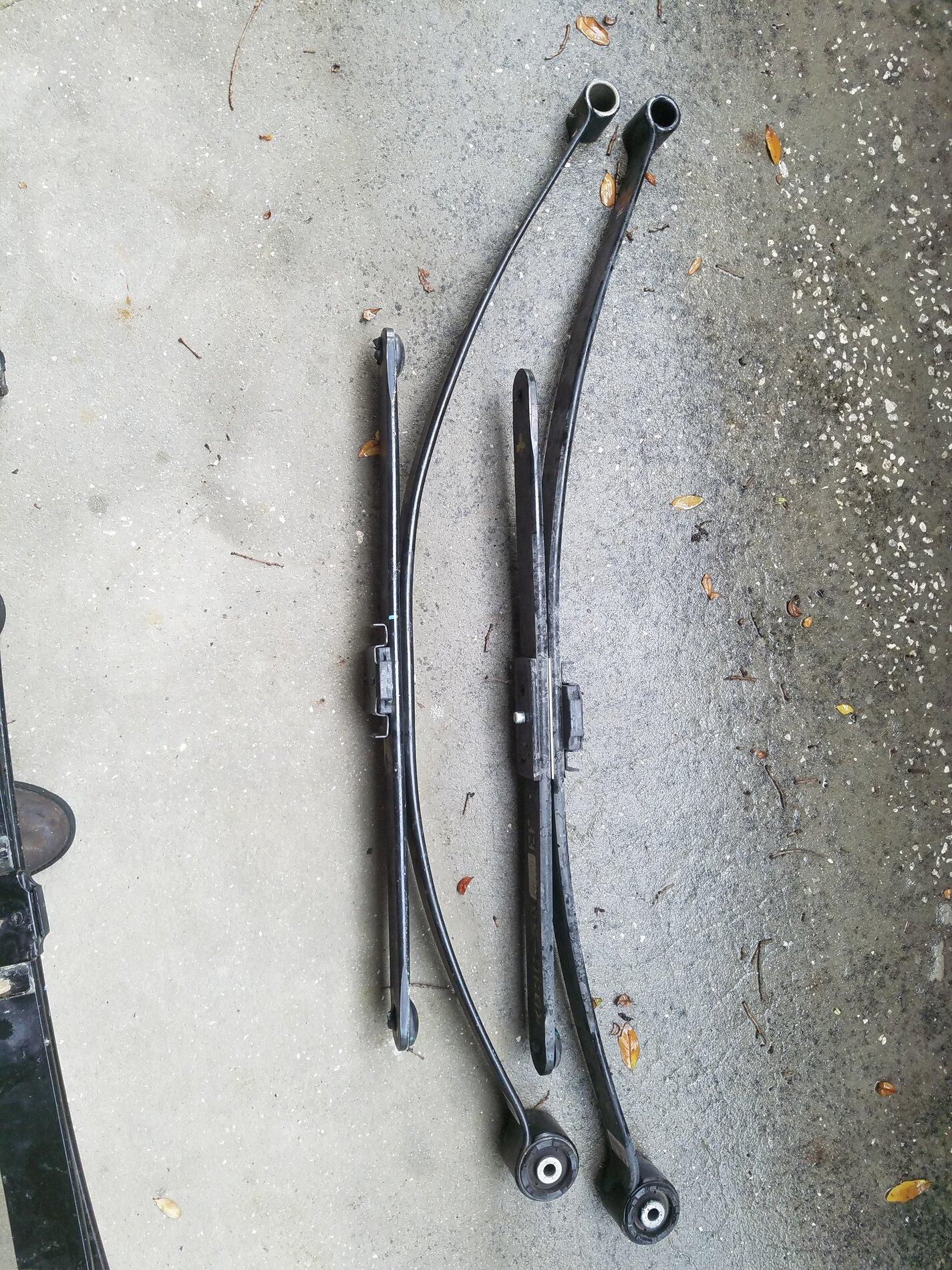

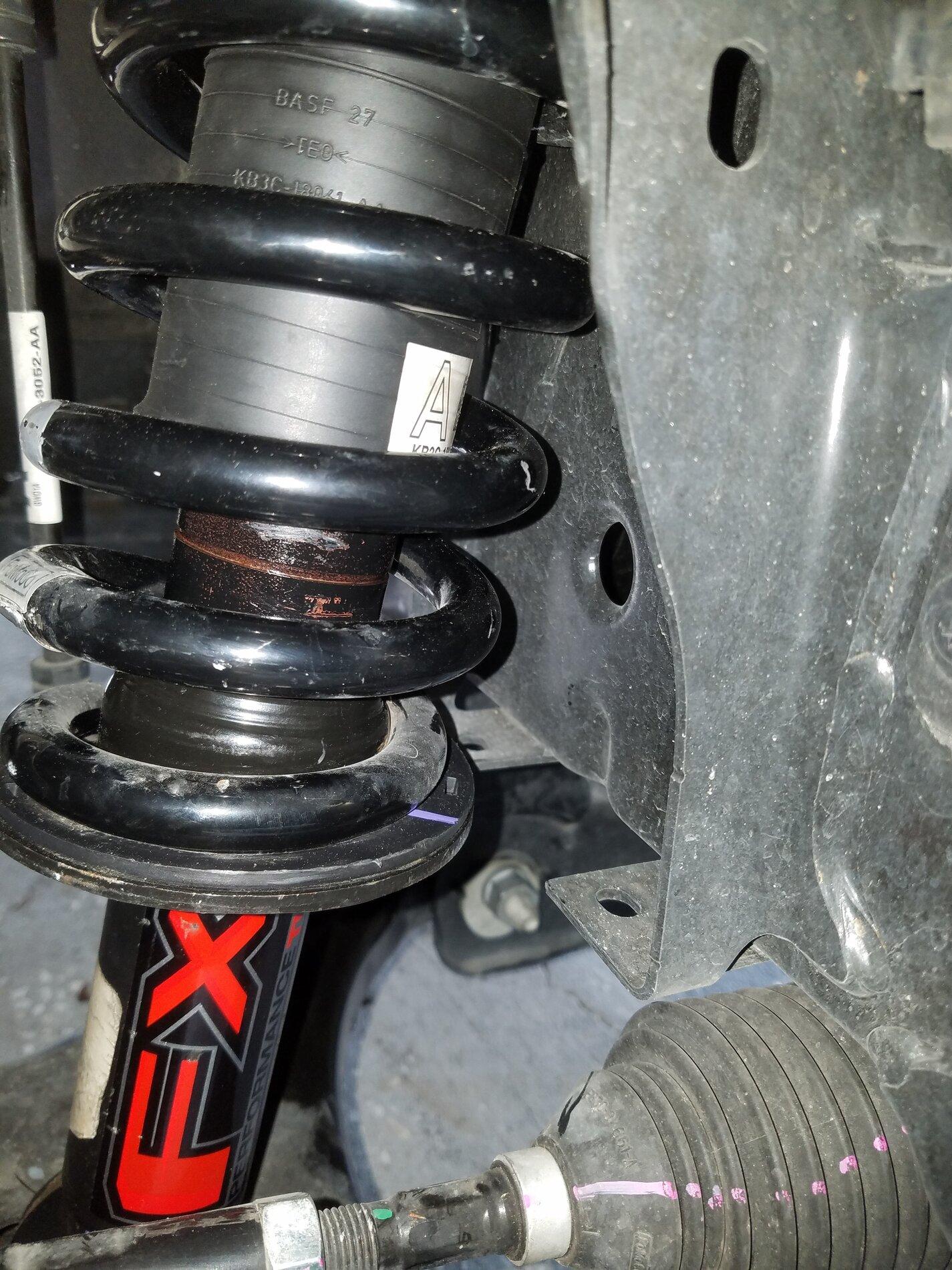

Cutting a new retaining ring groove by hand was the biggest challenge. Had bought a set of take off FX shocks to try and soften the front end a bit.
Long term, may try custom springs with about a 10% drop in spring rates.

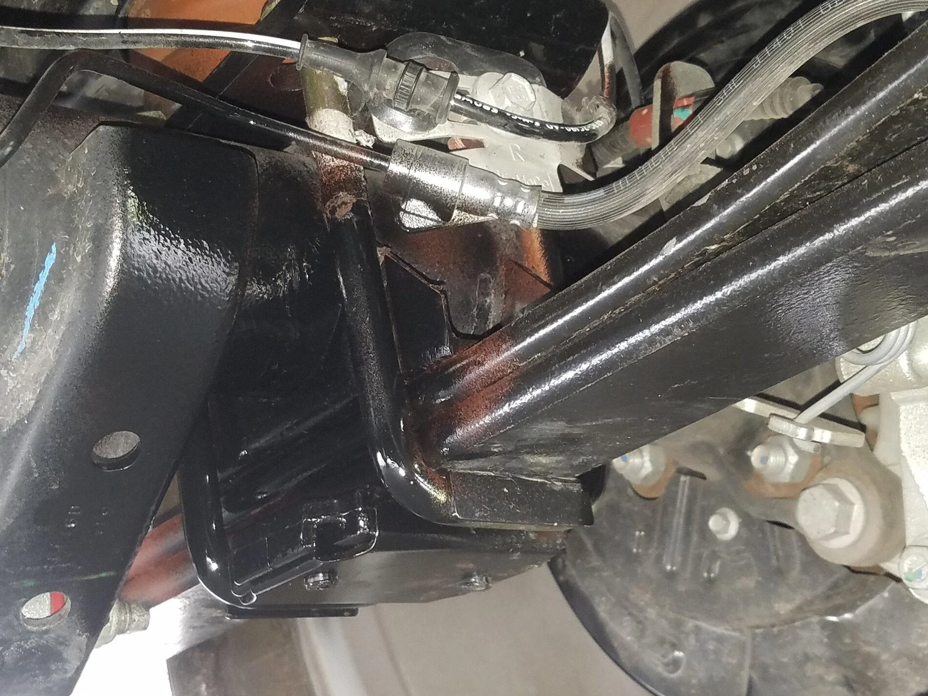

I'd bought a used set of springs to get re-arched so after getting the back end supported on stands, used a jack to support the axle, removed the original spring then lifted the axle to install the re-arched spring. Repeated on other side. Easy stuff.
Found some 3 1/8" spring perches at Eastern Gear, the heavy duty u-bolts and spring plates were from Summit. The new plate sits on top of original spring perch and the u-bolts set the pinion angle and clamp everything together since I did not weld the new perches to the axle.
Had I welded the new perches, standard duty plates and u-bolts would have worked.
Yes, used a 1/16" cutoff wheel in an angle grinder to cut new grooves. A 2" pipe cutting guide helped keep things straight and square. Hand held hacksaw blade to deepen a few shallow spots.
Both front and rear springs are still OEM rates so no changes in harshness. Used the FX front shocks since I think the wife's FX4 is more forgiving in the front.
The Rancho rear shocks were chosen for adjustability, length and the non-bonded center spacers in the bushings.
Final ride quality is still harsher than I'd prefer, but better than "As Built" by Ford.
