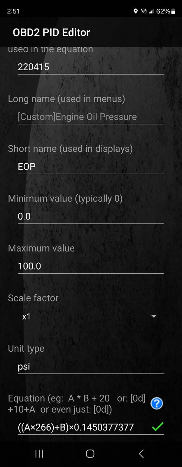

I think I finally found the PID that works on our trucks. It was on the F150gen14 forum. I plugged it into my Torque Pro app and it works and the values look like I member from Forscan. I need to fire them up side by side and verify. But here it is if anyone else wants to try it.

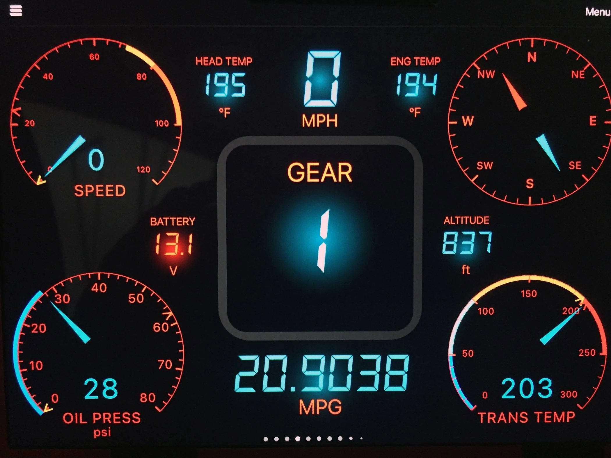

Can confirm that it displays what looks like valid OP data.
Looks to run between about 27psi and a smidge over 50 on my truck. As I recall, our pumps are ECU controlled and that looks to be the case.

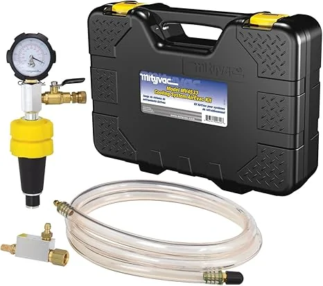

BTW, I noticed a correlation between low anti freeze, and EGR cooler failures that have lead to engine failures... seems it has to do with air pockets occurring when changing antifreeze. I've been researching vacuum coolant replacement tools. What would you recommend?
I have an older version of this one, its over 20 years old. I have not used it for a few years and have not used it on the Ranger (Yet) which reminds me I need to pull it out and ensure it will fit the reservoir; the tool does come with various adapter plugs to seal the neck of the tank.
I may need to repair/replace the shutoff valve as I suspect the seals are dried out (age) but the gauge part itself works flawlessly, I recall a small leak on the valve the last time I used it.
No matter what tool is used, they all are pretty much the same design
