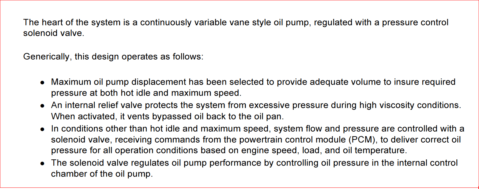

You guessed correctly. There is an engine-driven variable displacement oil pump and an oil pressure control solenoid. (From the Service Manual) ???
I believe the solenoid action reduces pressure when energized. So if the control circuit fails, the pump is at maximum displacement, and the mechanical pressure relief valve limits pressure to a safe value.

The electrical diagram shows a solenoid to control oil pressure, so the PCM does regulate oil pressure using a mechanical oil pump. (electrically actuated bypass valve?)
Maybe to reduce oil pressure for fuel economy?

Positive displacement pumps deliver a specific volume of fluid on each revolution. slow speed, slow flow, high speed, high flow. Pressure is set by the system resistance. This is why whenever you use a positive displacement pump, there has to be a pressure relief (bypass) valve to limit system pressure. Otherwise a blockage will cause pressure to rise until something breaks.
Old school oiling systems (typically) size the fixed displacement pump to deliver sufficient oil volume at low speed without any bypassing, and the bypass valve sets the system pressure as the pump rpm rises. The bypass valve is usually sized (for safety) to accommodate the full output volume of the pump at max rpm. Oil pressure is set by the bypass valve spring rate and system resistance. Excessive oil delivered is shunted back to the pan.
With variable delivery systems, you can match requirements more closely, and as you correctly guessed, it is probably done to lower the parasitic drag of pumping oil that is just going to get bypassed back to the sump. Takes energy to turn a pump against resistance, so minimizing this makes a difference. So you have a small pump at low speed, and a larger pump at high speed, and it's just the right size everywhere in between. The magic of electronic controls.
Costs a little more to build and maintain a system with more sophisticated controls, but with EPA efficiency standards ever-rising, it is worth doing it to avoid ruinous fines if you fail to meet CAFE standards.
