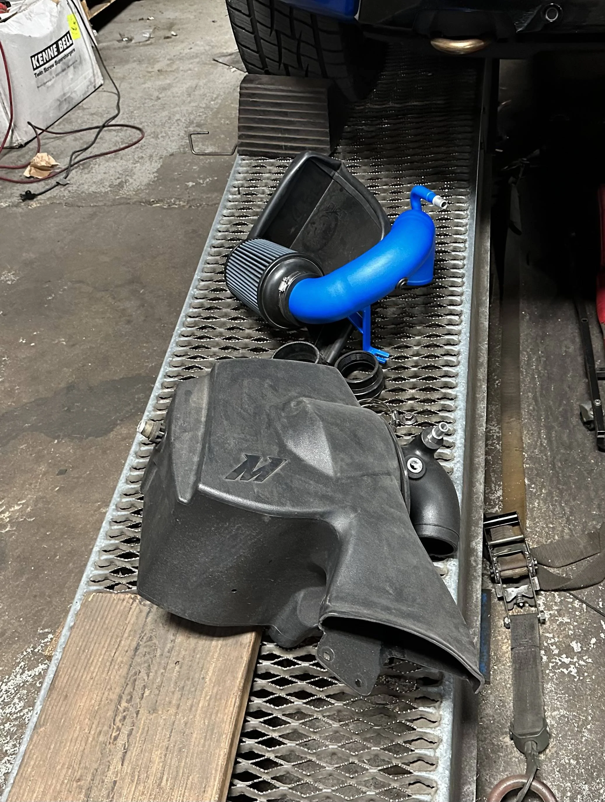

That would be the obvious choice, but if you look under your hood to see the ram air snorkle attached to the cold air box, you will see that it's not optimal. Firstly, the OEM snorkle is undersized, restricting air flow; secondly, the air that it inducts is coming off of the air running off the FMIC. We suspect that the turbo may be even taking air away from the FMIC, or if not at the very least taking considerable air directly from the engine bay. Considering that there are no hood vents, lots of hot air is being swept up from the underbody to the top of the under-bonnet area, making it a prime suspect to be sucked in.
We can improve on those issues with our design, which circumvents the hot engine air by taking all the cool air running off of the hood, much like how the Tacomas are doing with the TRD sport.
